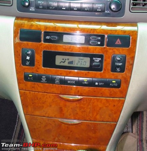

• Dec 2002-Aug 2005 : The orange-ish wood grain finish was quite an eyesore; in my view the dark wood grain finish on the facelift Aug2005 and later Corollas was better looking
The orange-ish wood grain finish on the Dec2002 to Jul2005 Corolla

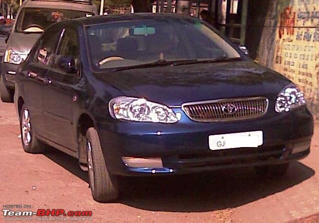

Here are a few observations that I had made about the blue 2003 H4 Automatic in comparison to the other Corollas that I had seen this far.
The Good
• Mar-2003 registered, from the first lot of Corollas
• rare metallic blue colour that was offered on the Corolla only in 2003
• single owner, comprehensive insurance
• negligible corrosion
• non-flooded
• structurally sound
• no signs of accident
• healthy engine- the engine note was clean plus I used a torch to look all the way down the engine through the oil filler port – the engine was quite clean and minus any sludge indicating that oil changes had been done in time
• Transmission oil dipstick showed oil at the COLD mark and was clean
• original glass all around except the front windscreen that had been replaced in 2010 with an original
• Michelin Primacy LC tyres of Week 2210
• steering boots and driveshaft boots in decent shape
• all four wheels' brake pads with a lot of life left
• K&N Air Filter
• rear seats were in pristine condition
• all door inserts were in very good condition
• two sets of horns – stock Denso and Hella Supertone Red Grills
The Bad
• leather on the front passenger seat was cracked at the portion where the thigh contacts the seat
• leather on the driver seat horizontal and vertical corners were chaffed
• only one transponder key
• the TOYOTA and the G monograms were missing
• three of the four wheel hub ornaments (chrome center caps) missing
• the plastic bar below the glove box was cut at one point – made me believe that there was an attempt to remove the evaporator coil without taking the dashboard apart. It is possible to remove the evaporator coil on the old Accord this way
• the metal shield under the engine wasn’t available. Some lazy mechanic must have not refitted it after an oil change.
• there was this horrible red marker than was drawn approx. 4 inches above the doors to give the car a “sporty” look – tastelessly done, in my view
• one of the fog lamps had a damaged reflector
• the alloy wheels had been painted partly in the body colour – again, to everyone, his taste.

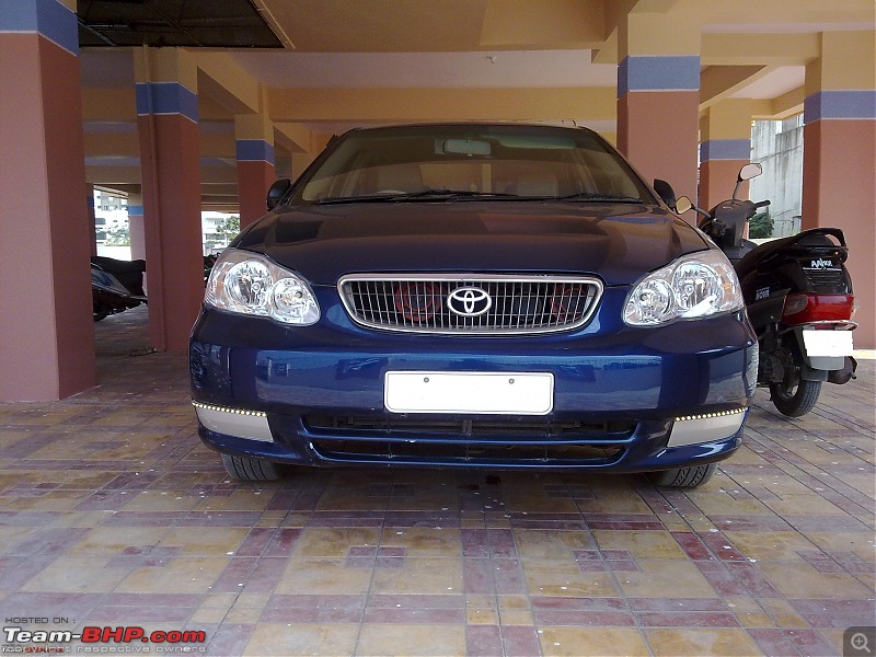

Here is a pic of the car after the makeover
2003 Toyota Corolla H4 Automatic Review – The Blue Beauty!-bluecorolla_feb2012.jpg
