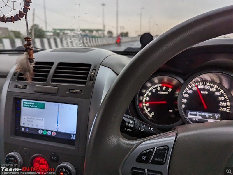

Sharing an update done to the GV a few months ago (was itching for some sort of refresh). Got a Pioneer 5450 heat unit put in which supports both Wireless Android Auto and CarPlay. Its been working quite well. Got Metra MET95-7953T from the US so that the stereo doesn't clash too much with the beige interior. I could only get the black plates in India. The HU is integrated into the steering controls and changes its mode to dark mode when I turn on the lights.
