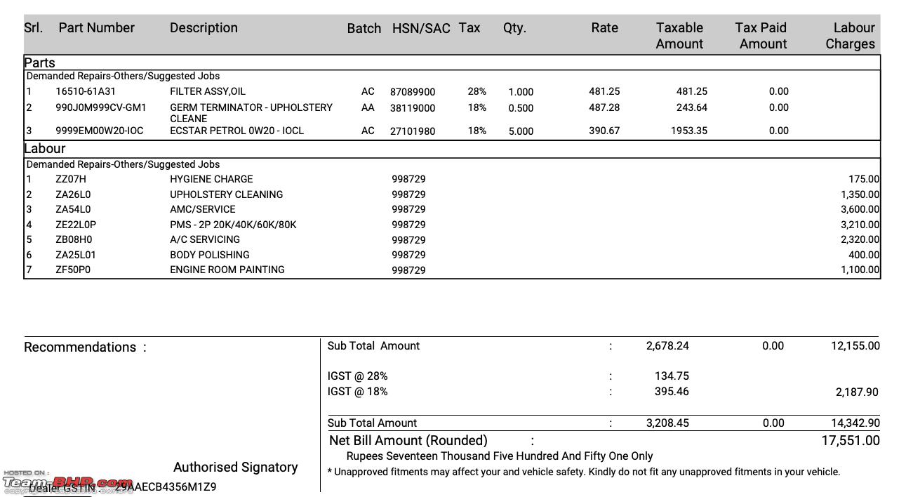

Had some water ingress into the GV's cabin from the Bengaluru floods in September, unfortunately was out of town and couldn't get it fixed up until now. Nothing major -while the water level outside was at the silencer level but the carpets were only a bit damp. There was some water in the exhaust pipes which was removed and cleaned and the rest was fine mechanically.
Had the car towed to a Maruti ASS and the cleaning and drying took almost two weeks.
Apparently only the major dealerships are allowed by Maruti to work on water affected cars so its prudent to check with the dealership in advance to avoid unnecessary waste of time and towing costs.
Here is a cost breakdown:
