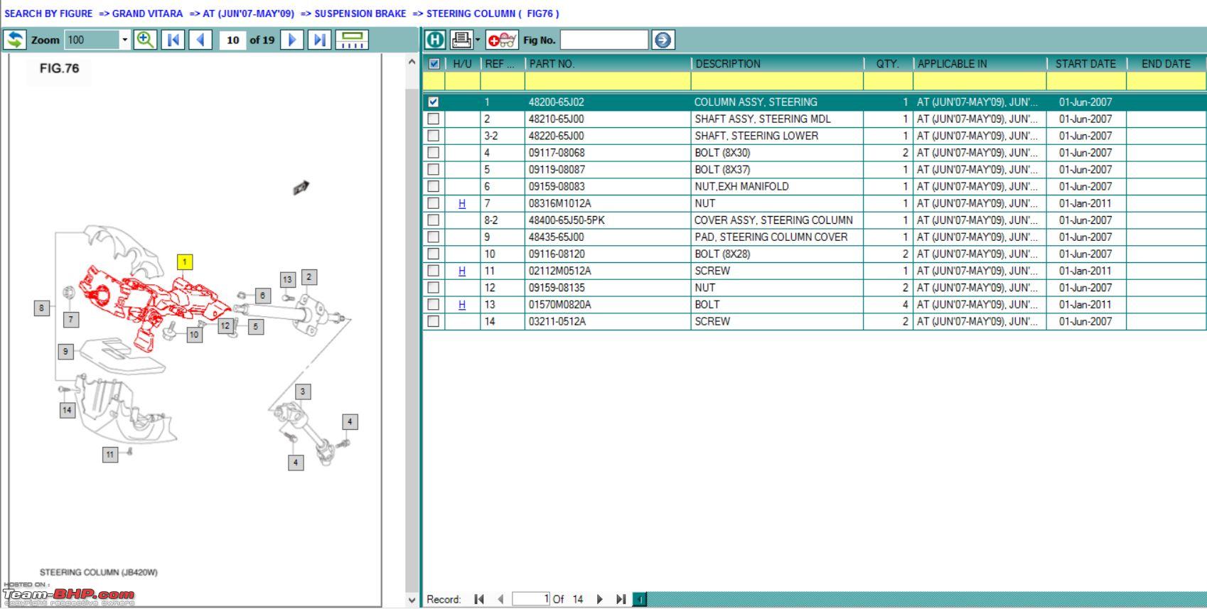

Posting the part numbers for 2.0L Grand Vitara AT.
Steering column
Steering unit
Power Steering pump
Do let me know which part numbers you are interested in. I'll give u the part prices.
