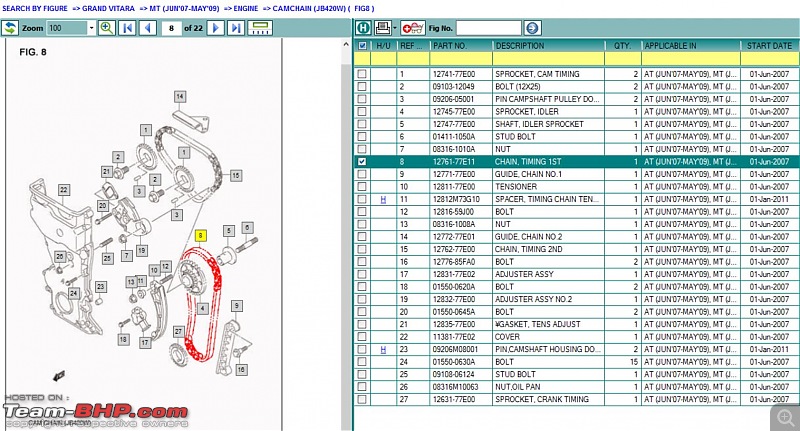

This is about the 2007 GV Manual 2.0 l that I have just got.
Does the Grand Vitara 2.0 Engine have a timing chain or a timing belt. If it is a belt what is the recommended kms when it has to be replaced.

Originally Posted by Styler View Post
Hi guys
Does the Grand Vitara 2.0 Engine have a Timming Chain or a Timming Belt.
It uses timing chains(2 in number-8 and 15)
