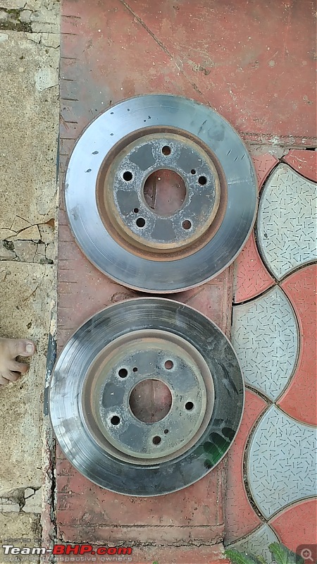

No wonder the brakes were sticking thereby causing wobbling at resonant speeds. SA also reported that the brake pads were "duplicate maal", leading to excessive scoring of the discs.
Uneven pad contact
Scoring & pitting of discs
The First Grand Vitara on Team-BHP-both-discs-scoring-pits.jpgThe First Grand Vitara on Team-BHP-scoring.jpg
The only possible reason for this happening was that moisture was absorbed in the brake fluid, which possibly had never been changed. I am thinking of changing rear brake cylinders also as a precaution.

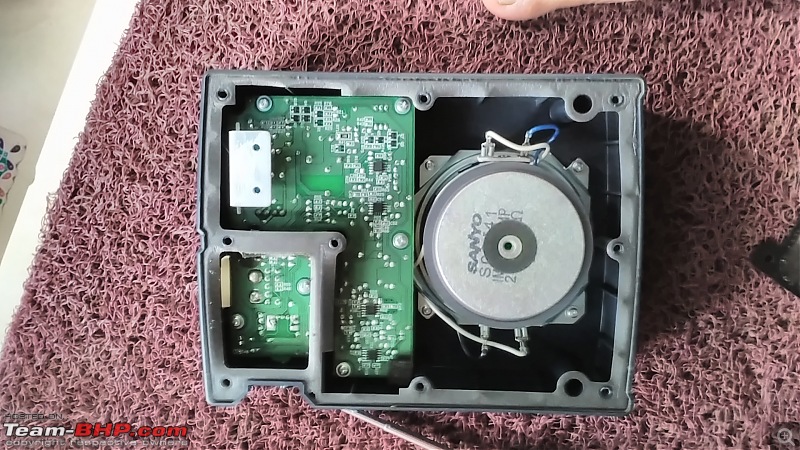

Did some tests on the Sub-woofer to see which would be the best way to upgrade the front speakers.
The unit with mounting bracket:
Made in China:
Boost control:
Internals:

I ran some test tones on the head unit to get an idea of the frequency ranges.
The sub-woofer starts from as low as 10Hz and peaks out around 60-70Hz.
Its sweet patch seems to be 35-50Hz.
The front speakers start sounding at 35Hz, but come into their own from 50Hz. onwards. Tweeters went up to 10000Hz. Did not have a test tone higher than that.
The front main speakers are paper bass full range. The tweeter is connected in parallel with the main speakers. I get a feeling that the tweeter are not getting sufficiently powered signal due to this arrangement.
I will now hunt around for a suitable component speakers so that I get better sound stage.
