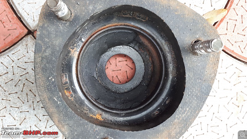

2. Front struts lift
I had reported on my suspension upgrade.
https://www.team-bhp.com/forum/long-...ml#post4524089 (The First Grand Vitara on Team-BHP)
However within a few months I started getting a lot of noise from the front struts. Eventually MASS insisted that I remove the rubber spacer in the front. The modified Support Front Strut brackets were replaced with OE spec ones. That solved the rattling. But the actual culprit was not the rubber spacer but the separation of the strut bracket rubber. But I do not want to take the risk of doing a repeat welding job on the new bracket.
The bracket.
The area marked in green and yellow is the spherical rubber part that sits into the frame housing.
The red and blue markup indicates the spherical rubber part.
The First Grand Vitara on Team-BHP-b4-seat-where-bonding-failure-occurred_compressed.jpg
The seat where the bonding failure happened.

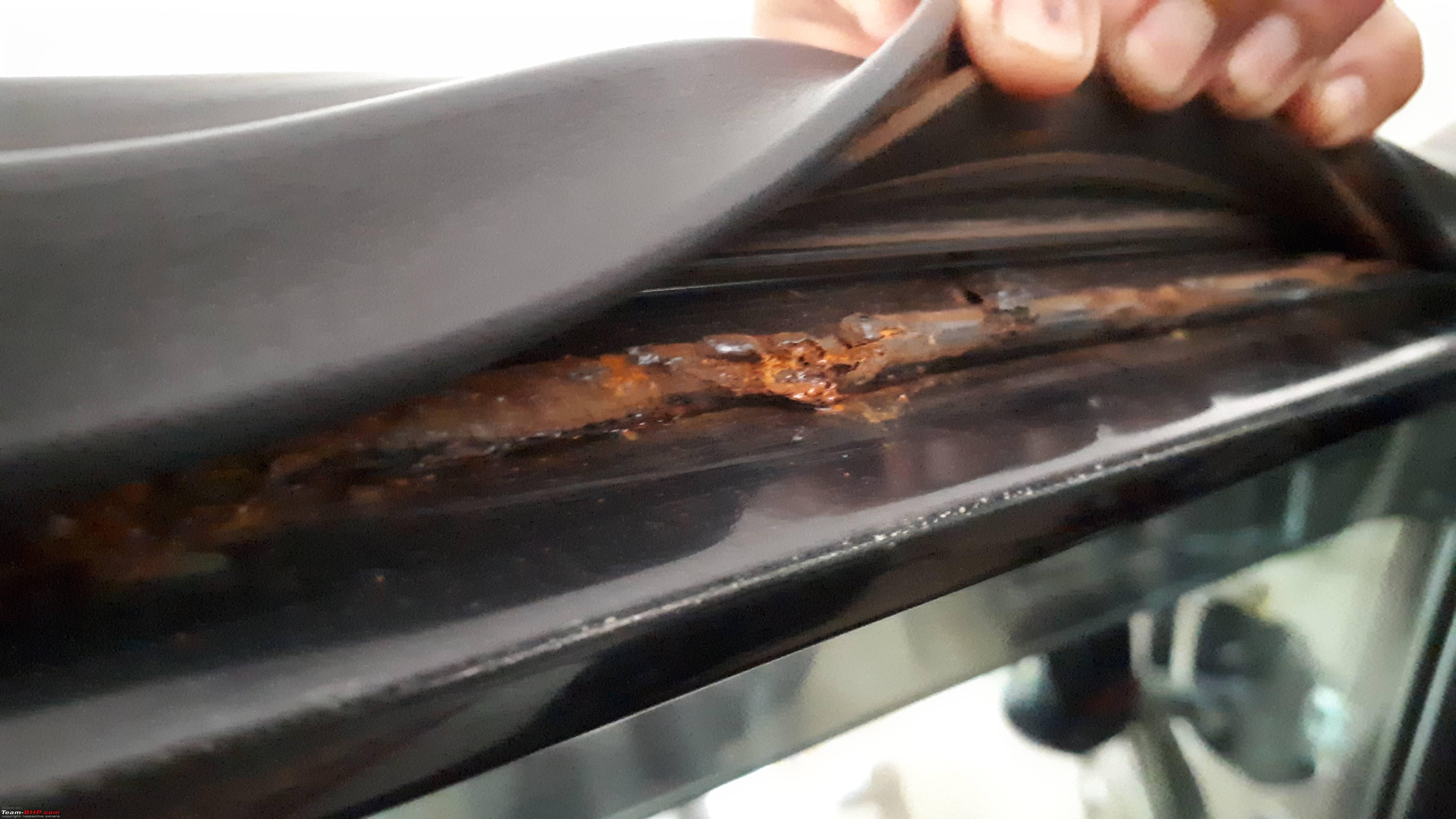

3. Door rust
The top of the LH passenger door had rust under the beading. I applied rust convertor, painted with black paint and refitted the beading.
The First Grand Vitara on Team-BHP-c3-after-applying-rust-convertor_compressed.jpg
After applying rust convertor.

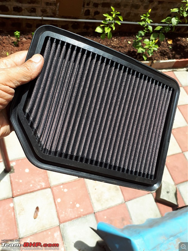

6. K&N cleaning in the lockdown
I had some K&N oil. But no K&N cleaning solution. So for cleaning I used a combination of IPA, water and Prill.
Dirty filter
cleaned
reoiled

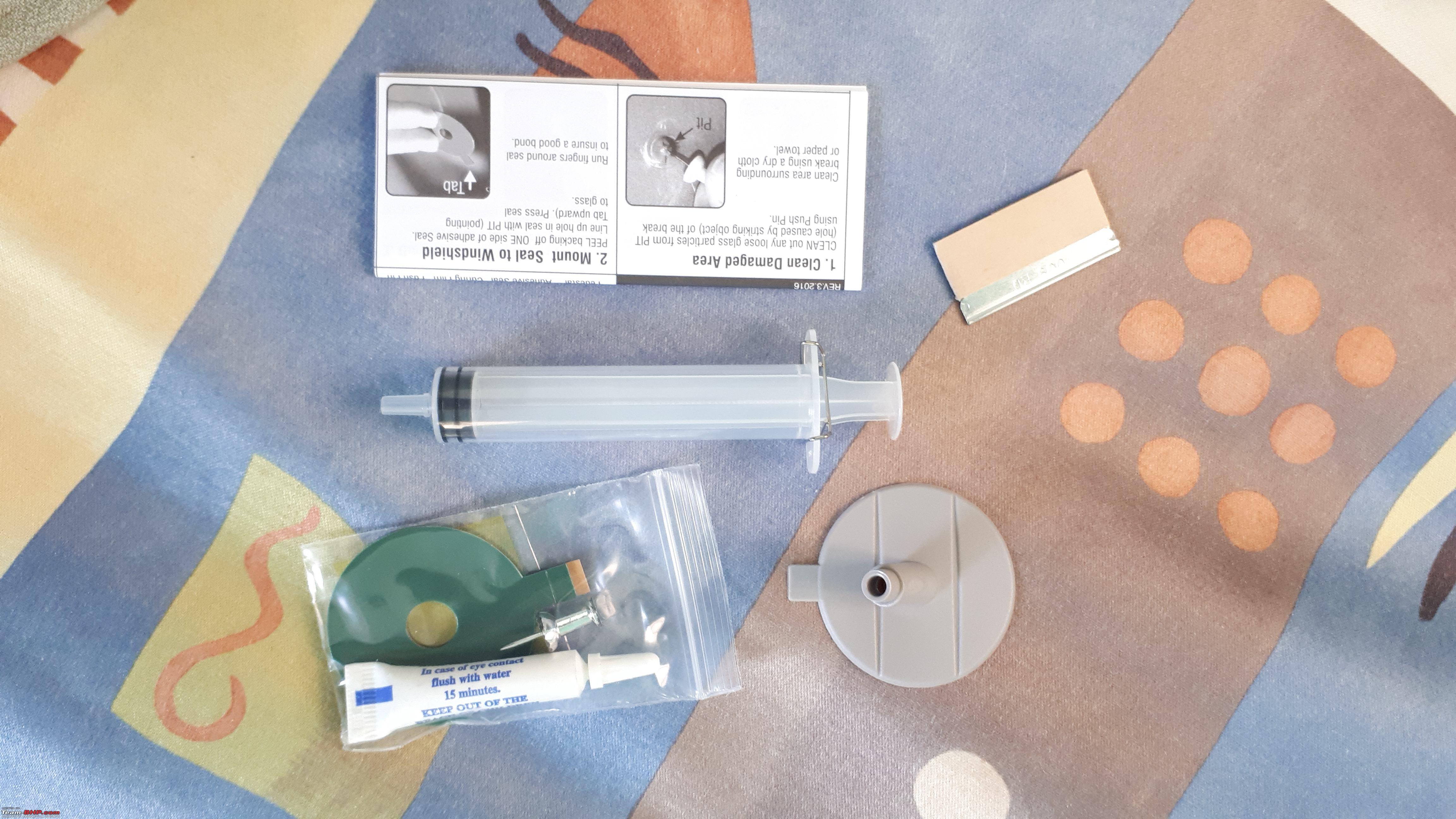

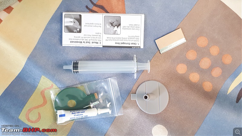

11. Windshield repair
In early 2019 the windshield got hit by some pebbles. There was a deep pit from the hits. This happened when I was going to Bengaluru on urgent work. I ordered a windshield repair kit online and the same was waiting for me when I reached back. I followed the instructions and managed to do a pretty decent repair. It has held up for all these years.
The kit
Cleaning the debris
Applying vavuum
After repair
The First Grand Vitara on Team-BHP-d5-after-repair.-only-hairline-crack_compressed.jpg
Hello Sridhar Sir,
Can you please provide link for the Windshield repair kit that you have used?
There are way too many options available on Amazon India and I'm not sure which one is good to use.
Jaspreet Singh
jsrakkar is offline
Old 14th July 2022, 17:57   #1629
Join Date: Sep 2010
Posts: 828
Thanked: 1,637 Times
Re: The First Grand Vitara on Team-BHP
Originally Posted by jsrakkar View Post
Hello Sridhar Sir,
Jaspreet Singh
The item I had ordered is no longer available.
These 2 are nearest to what I used.:-
https://www.amazon.in/Windshield-Win...s%2C248&sr=8-6
https://www.amazon.in/Permatex-09103...%2C248&sr=8-13
This is from a known brand, but I do not know how it will work:-
https://www.amazon.in/Rain-X-600001-...s%2C248&sr=8-5
Which car are you using? If it is a standard desi car it may be cheaper to just change the glass.
sridhar-v is online now   (1) Thanks

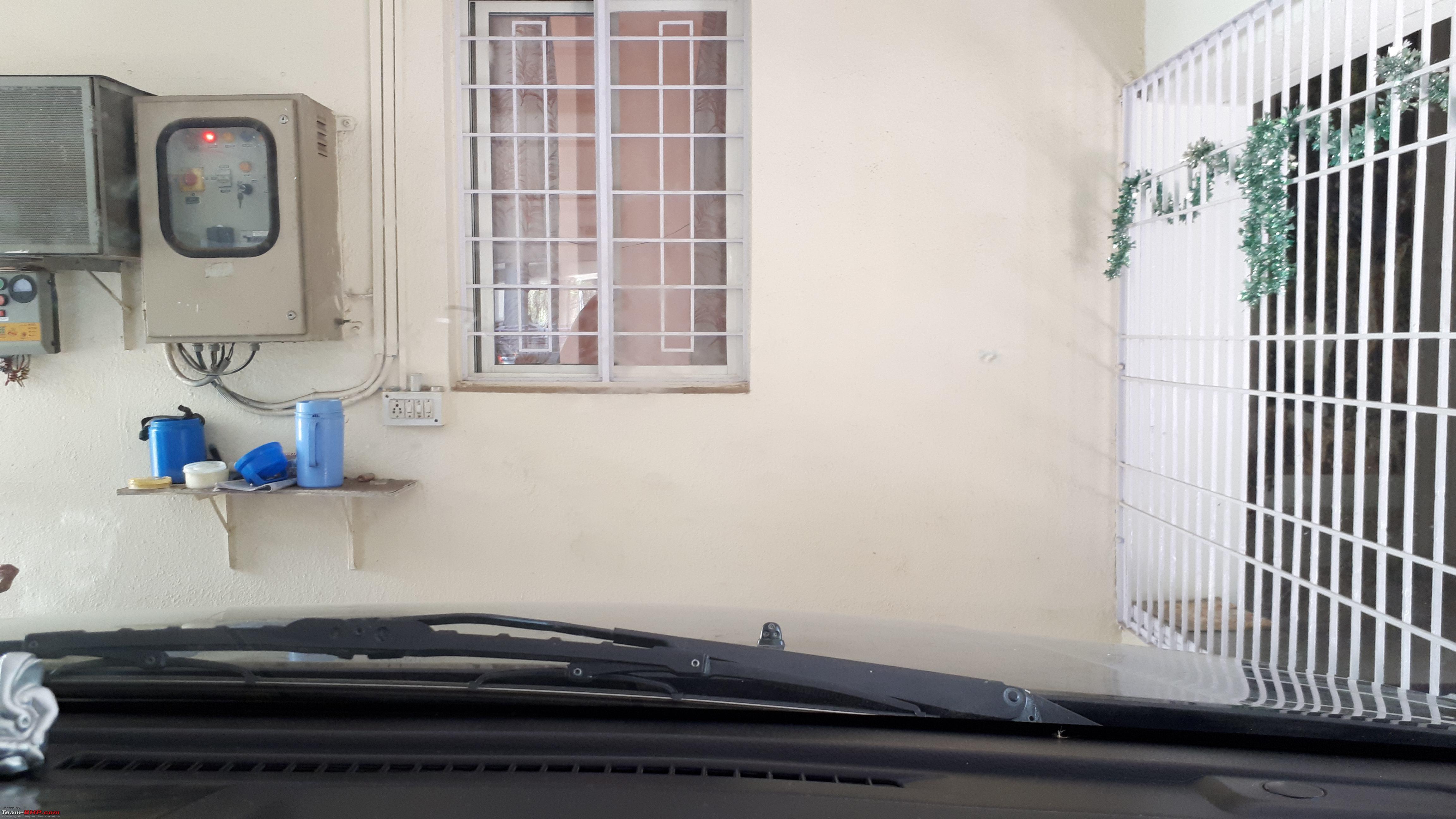

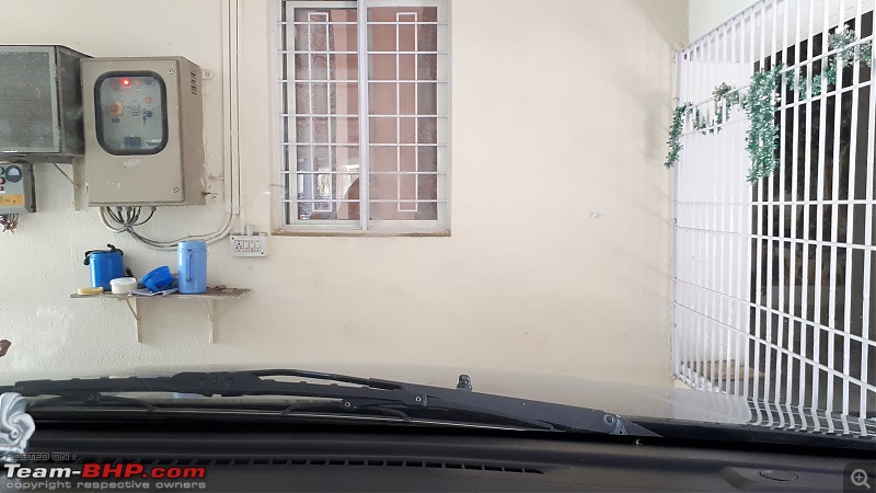

How does the windshield crack repair hold up, especially during rain and night driving?
~Zombie~ is offline
Old 20th July 2022, 10:58   #1632
Join Date: Sep 2010
Posts: 828
Basically my windshield glass was buffed many times in the past and twice, in 2017, after I bought it in 2015. As a result its thickness was reduced.
Because of this the flying pebble managed to chip off the glass.
The repair has held up very well. When viewed from inside there is a small line outline of the perimeter. But it is out of the line of sight for driving and it does not bother me.
The outside surface is absolutely smooth so there is no streaking or marking when using the wipers in the rain. Similarly, during night driving, there is no streaking of light of oncoming headlights.
sridhar-v is online now   (2) Thanks
