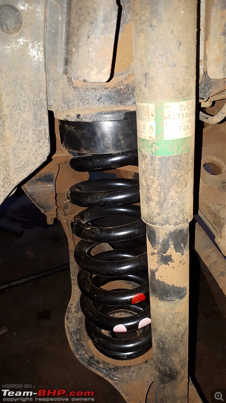

The KYB part nos are as follows:
RH Strut - 334464
LH Strut - 334465
These struts are exclusive for the 2005+ Grand Vitara and are not common with any other car.
KYB Rear Shock Absorbers - 343435. I did not replace my rear shocks.
I always wanted a moderate lift. But Ironman and OME were out of budget. So I settled for a simple lift of 25mm using spacers. These are hard rubber spacers made in India. These types of spacers are quite popular with cars getting cng tanks fitted.
The front spacers and extra long bolts.
The existing bolts in the Support Front Strut were pressed out and the extra long bolts were welded into place.
The First Grand Vitara on Team-BHP-09-top-bracket-bearing-fitted_compressed.jpg
The rear spring spacers. These replace the existing rubber seats at the rear.
A view of the old strut assly. removed from the car.
The First Grand Vitara on Team-BHP-06-old-strut-assly-unmounted_compressed.jpg
And a comparison of the old and new struts side by side. The old strut had lost a lot of its spring back.
A side by side comparison of the old and new strut assemblies.
The First Grand Vitara on Team-BHP-011-old-new-strut-asslys-comparo_compressed.jpg
I also got Camber adjustment bolts fitted.
The First Grand Vitara on Team-BHP-012-camber-adjust-bolt-fitted_compressed.jpg
Some views of the rear spring and spacer.
My front suspension used to make a lot of noise when going over bumps and rough patches. So I made it a point to replace the following parts of the strut assemblies:
Seat Coil Spring Rubber 41200-65J00.
The First Grand Vitara on Team-BHP-018-seat-coil-spring-rubber-bracket-side.jpgThe First Grand Vitara on Team-BHP-019-seat-coil-spring-rubber-spring-seating-side.jpg
There are some indentations of the spring end on the rubber. Cost was Rs. 276.56+taxes each.
To be on the safe side, I ordered Seat Coil Spring Upper 41311-65J00. Cost was Rs.434.38+taxes each. With hindsight this was one unnecessary replacement.
It is absolutely necessary to replace the strut bearings 41741+78K00. Cost Rs. 385.94+tax each. Both the old bearings had excessive radial play.
A view of the front wheel well after the upgrade
Height was 800mm. After the upgrade it is 840mm.
A view of the rear wheel well after the upgrade
Height was 805mm. After the upgrade it is 845mm.

The rubber spacer upgrade for the front suspension is not going well. I recently returned from a 1648 kms road trip. A few days after the trip I noticed a knocking sound from the front suspension. During a subsequent 80 kms bad-road trip, with the "whiteknight", the problem was identified as severe rattling from the front struts,
It turns out that the rubber spacers had metal sleeve inserts on the bolt holes. The rubber is getting compressed slightly after the bolts are tightened. This results in the sleeve getting deformed and touching the metal of the strut well housing. Removing the sleeves would increase play in the plane perpendicular to the strut length. So I am planning to revert back to original fitments.
Later on I will see if there is a proper engineering solution to using the spacer.

How is the vehicle stability after the spacer?
