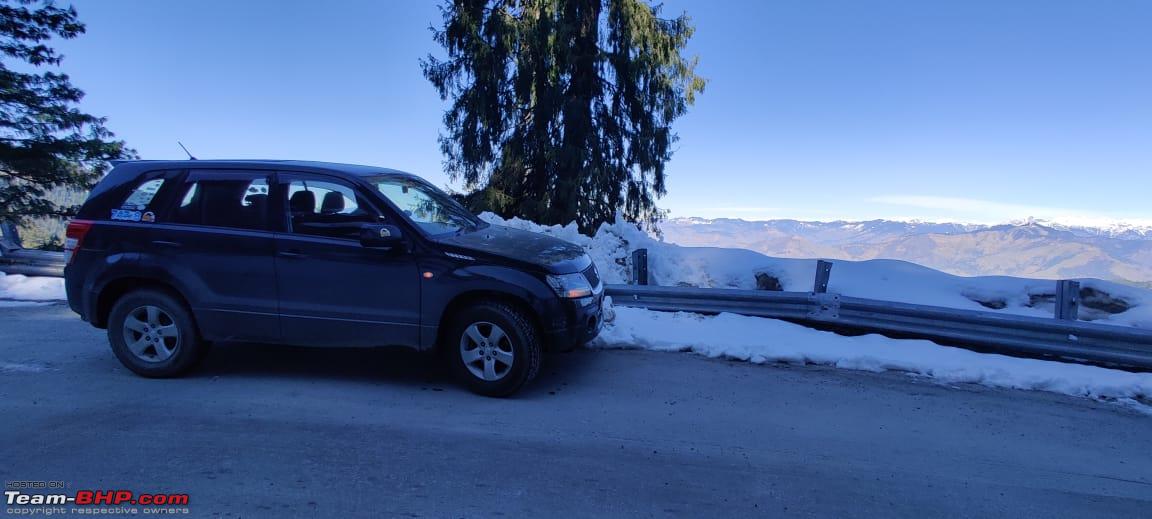

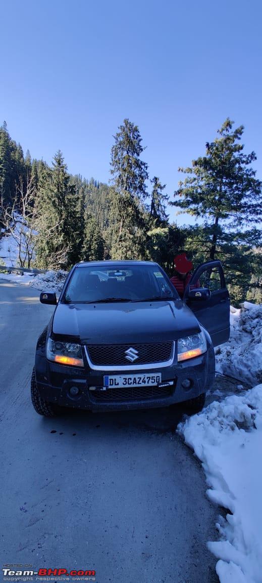

Another Year , another snow drive to the lower Himalayas .
The mileage went up after I got the clutch changed , the water pump was making a weird noise , so got a new one as well . Lead time for parts has increased lately , the pump took 8 days to be delivered to the MASS.
Last year after picking up the CRV and BMW , and after 12 years of owning GV's - I decided to let this one go as well , a dear friend has bought it , however still parked with me as the new owner lives abroad 10 months a year and is only expected in August 20 , when I indicated that I was looking to let it go he paid in full and said keep it for me even if I drive it after a year
Has been used for less than a 1500kms in the last 6 months on account of the automatic CRV for in town and the 320 for highways being there.
