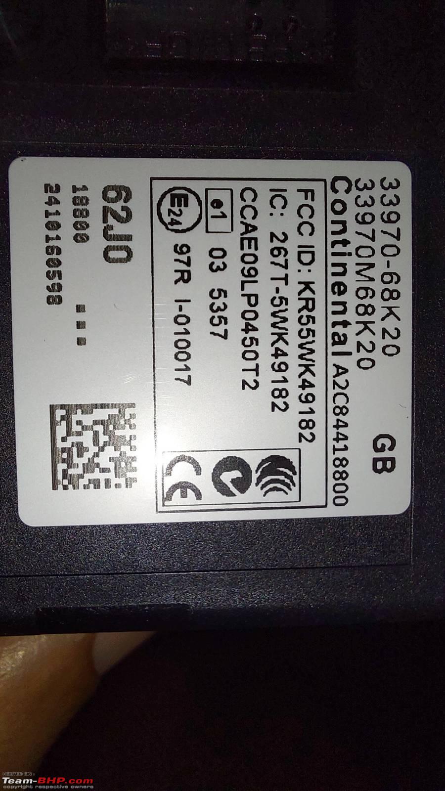

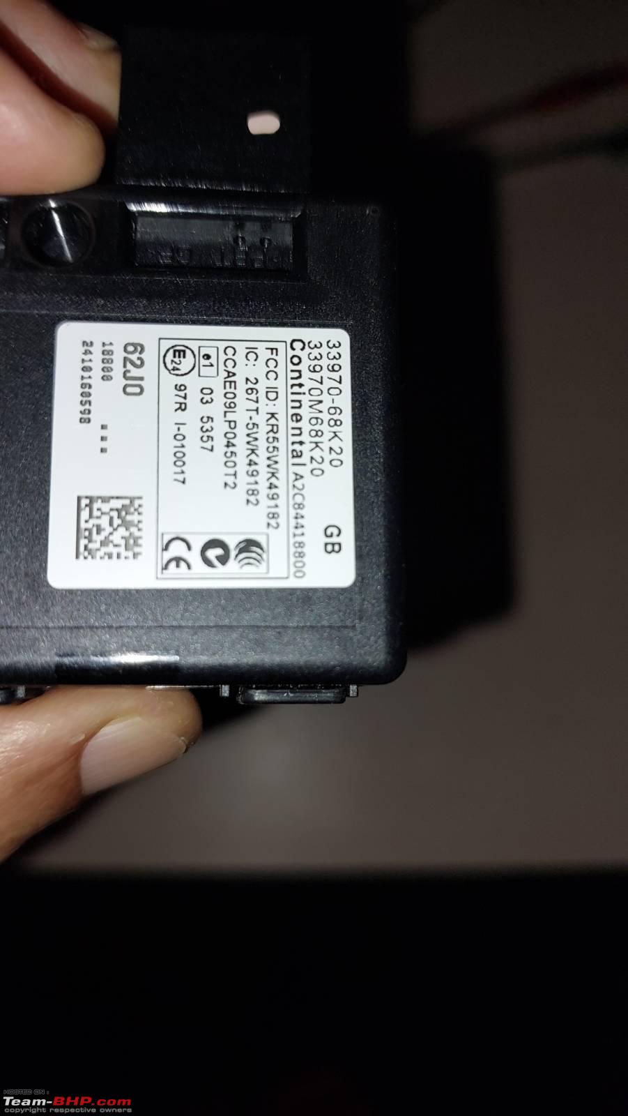

I had been facing, in 2022 & 2023, random starting issues. All investigations were turning out negative. Finally it was tracked down to a weak immopiliser chip on the main key. I had changed the keys and cloned the immobiliser chip in January.
In July end the issues with the immobiliser recropped up and it was diagnosed that the Immobiliser sensor was now faulty. Part number is 33970-65J00. My MASS promptly ordered the part. A 3 month wait later we decided to track down alternate items. SX4 immobiliser sensor 33970m68ka0 was shown as a replacement but stock was not available in the maruti system. Some clever online searching by the storekeeper threw up a likely candidate and we ordered it asap. Luckily it is a perfect fit for the Grand Vitara. Only the sensor illumination is not present.
Part no is 33970m68k20. Cost is Rs 1030.
Replacement is very easy. Remove the steering lower cover. Dsiconnect the sensor. Remove the mounting screw and replace the sensor. Only the sensor illumination is not present.
