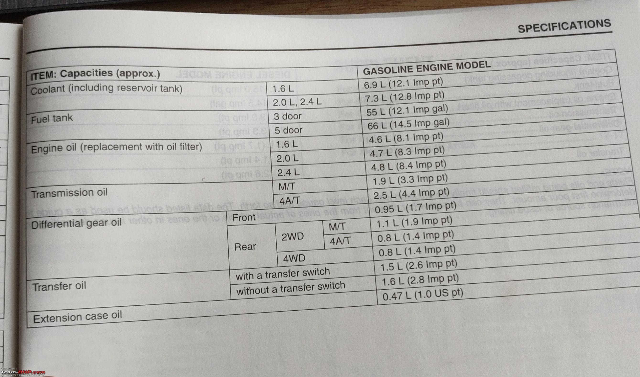

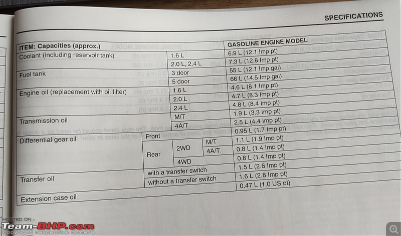

What's the "extension case" as mentioned in the manual?
It even says that it will take .47L of oil.
I can understand the following:
- engine oil
- gear box oil (transmission oil)
- Diff-oil (rear & front)
- t-case oil (transfer oil, for 4x4)
What's this extension case oil? Anyone changed this?
