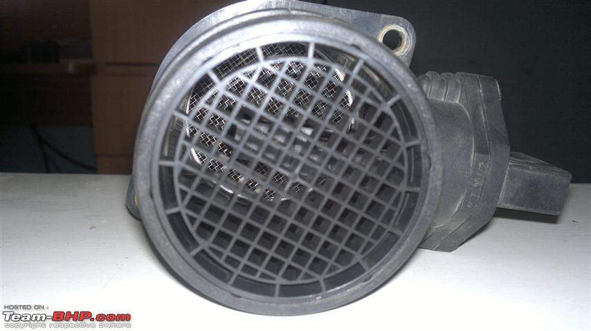

Last Sunday was DIY day. Workforce : Me, my son and daughter .
Agreement : Dinner at McDonald.
1. Cleaned MAF sensor : Ajmat thread was very helpful.
2. Air filter : Cleaned
2. Cleaned Sun roof : Cleaned drain and lubricated the channel.
3. Replaced fuel filter : Call update the local mechanic to do the job. Rs 100/-
4. Seats Waxed
MAF Sensor cleaning : Opened the air filter case and MAF sensor can be removed. Clean it with Rubbing Alcohol. Re-fit.
Skoda Octavia vRS - 12/2004 - Diamond Grey - Update @ 54000 kms-08062011603.jpg
Skoda Octavia vRS - 12/2004 - Diamond Grey - Update @ 54000 kms-08062011605.jpg
Skoda Octavia vRS - 12/2004 - Diamond Grey - Update @ 54000 kms-28072011905.jpg
Sun roof : Rail was lubricated with engine oil. drains were cleaned by pouring water. Luckily no blockage.
Seats were waxed with ArmorAll.
Skoda Octavia vRS - 12/2004 - Diamond Grey - Update @ 54000 kms-28072011906.jpg
Fuel filter : Only 1J0 is compatible not 1H0.
Skoda Octavia vRS - 12/2004 - Diamond Grey - Update @ 54000 kms-09062011610.jpg
