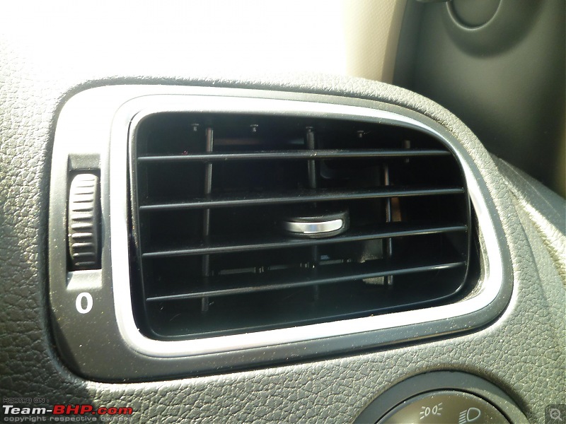

I have had the same exact problem pictures of which I have posted in another thread and posting it again now. Just to let you know, VW Downtown Mumbai has agreed to replace the louvers under warranty. But it took them nearly 3 weeks to come to the decision. Please check with your dealer again. I'll be going to the workshop this Friday to get all the vents replaced.
VW Polo 1.6 MPI - Ownership Report EDIT: 1,30,000 km up!-p1010595.jpg
VW Polo 1.6 MPI - Ownership Report EDIT: 1,30,000 km up!-p1010596.jpg
Great news. Please let us know once you get the replacement. Please insist on a bill/voucher for the replacement (they create a 0 value voucher for any replacement under warranty) and post it here. I will take a printout and go and claim the same from the local dealer here.
Hey my AC vents were fully replaced today with new ones. They feel much better now and move swiftly. The earlier ones felt too loose and fragile. Glad VW has replaced them under warranty. But the service advisor also told me that some warranty claims for the same were also rejected. Reason apparently being mine was a worse case than others
Hope yours also gets sorted soon. The warranty bill will be couriered to me later on as I took the delivery of the car when the workshop was about to close.
And BTW, my car was given a complimentary wash and interior cleaning as always This fact should be told to VW Bangalore who are charging 450 bucks for washing everytime!!
