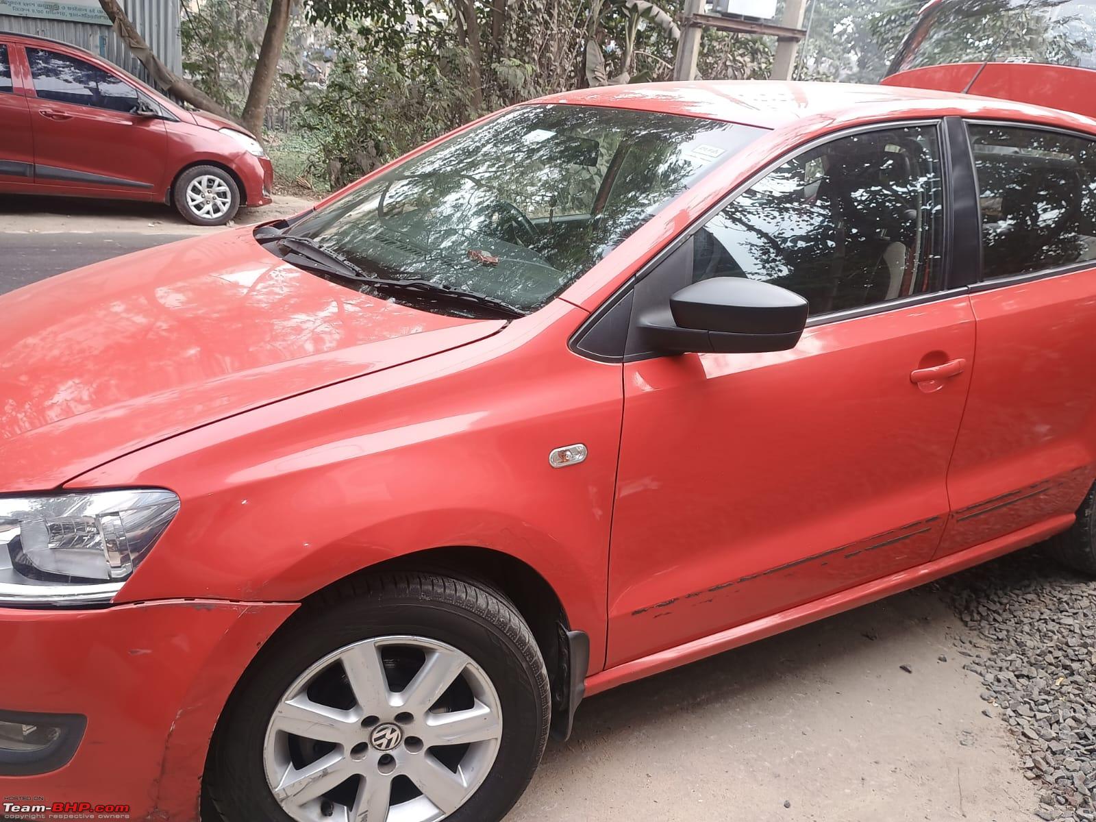

The last few years has not been very kind to the car. First, I do not have a covered parking in my new apartment. So the car was exposed to the elements since 2016 when we moved in. On top of that, the car was not being used extensively since the COVID lockdown started and post COVID was mainly doing college runs for my son during his UG and PG. Then when the boy moved to the hostel to pursue his MBA in June and the Jimny entered the scene in July 2023, the Polo was left totally unused.
This resulted in a bit or rusting on the doors, some paint fade on the roof and bonnet. One morning in late 2024, while I was driving it to the neighborhood hairdresser, a novice driver brushed the left fender and bumper leaving some visible scratch marked.
Then one fine Friday evening, my neighbour's part time driver misjudged the length of his car and banged on to the front of the Polo while parking. This impact left the Polo further bruised externally - the left fender was dented and front the bumper was damaged along with the grill and one headlight.
I was scheduled to start the Sandakphu drive on the Jimny the next morning. So I kept the Polo as it is and went for the Sandakphu trip. When I came back after a few days and took the Polo out for a drive, the ABS error lights flashed as well.
VW Polo 1.6 MPI - Ownership Report EDIT: 1,30,000 km up!-before.jpg

I started feeling bad for the car and decided to do some much needed pampering.
Recently, T-BHPian Samba had done a complehensive repair / painting job on his Etios while dogndamsel12 did a suspension job on her Polo. So I contacted them to find out more details about their experience.
It turned out that they went to Hritam of HB Autoneeds for both the jobs.
I first took an estimate from the VW ASS. Then took the Polo to Hritam for a inspection and estimation. Looking at the rusting on the doors / running boards and the accidental damages, Hritam gave a denting / painting estimate which seemed reasonable. The estimate contained 5 panels denting and repainting, 4 pcs ABS sensor replacement (2 of th existing set was throwing error), front brake discs, front grills and one head light replacement.
Then he came up with an alternative proposal - it may be quite difficult to do a very acccurate color matching for the repainted panels which were slightly faded due to the age and prolonged UV exposure. Although the difference may not be significant, but still it would still be visible to a discerning eye.
So, he proposed to add the remaining panels for a whole body repainting at 10K more than the current estimate. That seems quite a deal and given the fact that the official VW ASS estimate for the repairs was already double the amount.
So I signed up for it and decided to go for the suspension work after a month or so.
All that work finally completed yesterday. The final pocket pinch turned out to be considerably higher than the initial estimates - with more defects and damages starting to show up while the work was in progress. The steering rack needed replacement, the front shockers had lost it composure, some of the rubber beadings had hardened and needed replacement, the list goes on.
