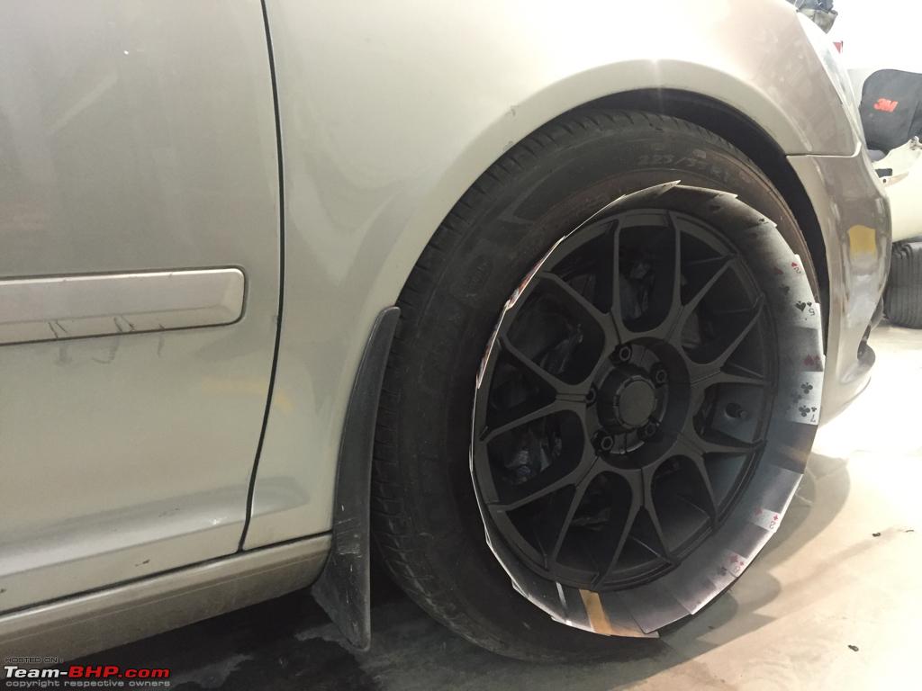

Plastidipped my alloys satin black
Plasti Dip in India? A Spray-on Rubberized Coating...-imageuploadedbyteambhp1453893222.853476.jpg
Final result
Plasti Dip in India? A Spray-on Rubberized Coating...-imageuploadedbyteambhp1453893253.283381.jpg
Rohan
Did you spray while the wheel was on the car?
Personally, I would have liked if you had
1) removed the wheel
2) sprayed only on the rim not on the nuts
3) removed the center cap and not spray on the cap
That way it would have looked more realistic (or more OEM, so to speak)
Rohan
Looks good Rohan! Where did you procure the plasti dip cans? I am unable to find any in paytm. It says out of stock. Also how many cans did you use for all 4 wheels? And how many coats?
Done as an experiment. I wanted to paint them black but wanted to see how they would look before hand. Didn't have the facility to remove the wheels
Agreed with this
The center cap is silver. Wanted it to be black as well- so sprayed it.
Answered above! :)
A friend had them with him so we used those. we ended up using almost 2 cans with 5 coats of the black and 2 of gloss on each wheel!

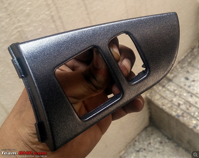

I tried plasti dipping myself this week and here are the results :
Plasti Dip in India? A Spray-on Rubberized Coating...-img_20160126_112747001.jpg
Plasti Dip in India? A Spray-on Rubberized Coating...-img_20160126_113449001.jpg
I used plasti dip and not regular paint since it gives a nice soft touch feel to the interior trim.
Well, technically I used Rust Oleum Peelcoat, which is similar to plasti dip.

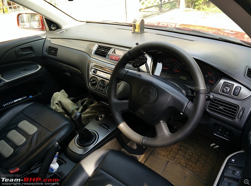

I re-did this panel (and a lot more) using graphite shade of Rust-Oleum. Its the perfect shade for interiors!
4 coats on all panels.
Plasti Dip in India? A Spray-on Rubberized Coating...-img_20160207_104725001.jpg
Plasti Dip in India? A Spray-on Rubberized Coating...-img_20160207_115443001.jpg
Close Ups:
Plasti Dip in India? A Spray-on Rubberized Coating...-img_20160207_104946001.jpg
Plasti Dip in India? A Spray-on Rubberized Coating...-img_20160207_121843001.jpg
Everything together. This picture does not do justice:
Plasti Dip in India? A Spray-on Rubberized Coating...-img_20160212_103408001.jpg
All this required almost half the can. So I have spare remaining with me in case I want to re-do any of the panels when it gets scratched/damaged.
