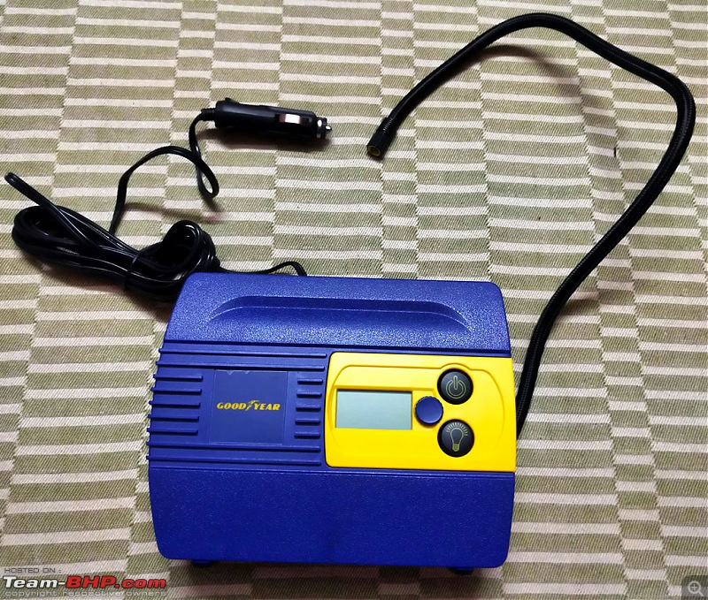

Review: Goodyear RCP-B31C Digital Air Compressor (Tyre Inflator)-gy001.jpg
Although the specs list the size clearly, it is still surprising to see how small it actually is. The phone is a Micromax Canvas 2, for scale. OK, you can see all the relevant information in this picture. What is doesn't mention is that the unit operates at 10A current rating. This is mentioned in the leaflet/manual inside the package, which is not very detailed, but then the unit is not very complex. Incidentally, the unit is Made In China. Looks like everything is made there, nowadays.
