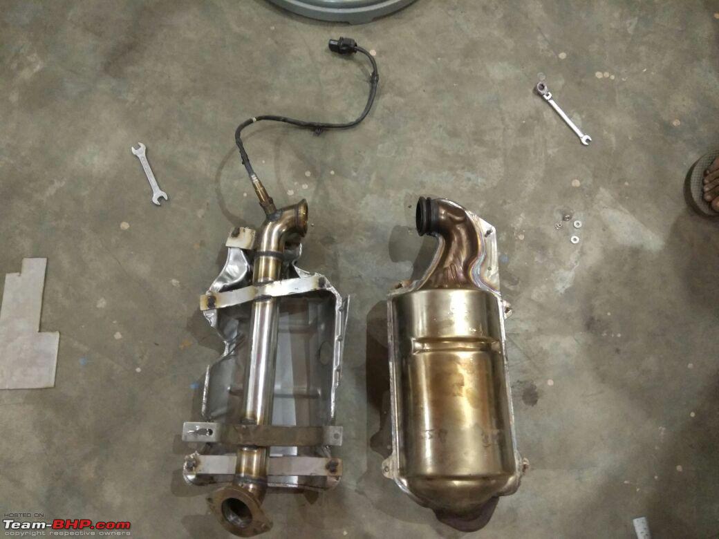

Venkat found the design simple and he said it could be done in a day. I left the car at Blackworks. I was thinking full night about losing power in low end. I had almost made up my mind that I would lose power at low end
I called Venkat next day and was happy to hear that the car would be delivered on same day. Venkat and his helper were working full time on it.
Blackworks Downpipe :
S-Cross 1.6L: Custom Decat SS Downpipe by Blackworks-img20170217wa0008.jpg
S-Cross 1.6L: Custom Decat SS Downpipe by Blackworks-img20170217wa0031.jpg
New Downpipe vs Stock Cat con
S-Cross 1.6L: Custom Decat SS Downpipe by Blackworks-img20170217wa0010.jpg
Stock exhaust pipes not tampered, direct bolt on fit with flanges
S-Cross 1.6L: Custom Decat SS Downpipe by Blackworks-img20170217wa0020.jpg
S-Cross 1.6L: Custom Decat SS Downpipe by Blackworks-img20170217wa0019.jpg
Finally it's the time to test my car. I was still worried about losing low end. I started the car and there were no errors or CEL. I revved up till 2000 RPM and engine sounded sweet. We decided to go for a short drive.
Now this was shocking and I have no words to describe the feeling. There was no loss at low end and it felt better. Also there was a sweet sound, louder turbo whistle. I slotted into 2nd gear and floored the throttle. You won't believe what happened, turbo spooled up pretty fast, very strong turbo kick and I was losing traction. I shifted to higher gears and there was good improvement across the revv band. It felt like the car had totally transformed. Power delivery was just brilliant. Car is a different animal if I floor the throttle. After driving for few KM, I felt totally home and loved this mod.
Below 1000 RPM : No Difference!!
1000 to 2000 RPM : Turbo lag has reduced. I did not expect this to happen.
2000 to 3000 RPM : This is pure fun. Turbo boost is stronger and holding for longer. Also the engine is lot more free revving.
Above 3000 RPM : I like the engine note and it's just sweet. There is improvement which is noticeable.
City driving has become effortless now and 3rd gear is very much helpful even in Bangalore traffic. Also the MID is showing good FE figures. I will confirm this with tankfull method soon.
Tune O Tronics remap + Blackworks Downpipe = Sweet combination!!! I am just loving it.

Originally Posted by vishy76 View Post
An excellent mod naren sir. You have truly become an ace at mods.
Kudos to you and specifically that one person in the Maruti management who decided to get the 1.6 s-cross to India instead of those vanilla marutis we see otherwise.
Had it not been for them, we wouldn't have realised that marutis too have great potential when it comes to driving dynamics.
I am eagerly waiting for a new map to exploit the exhaust setup and a vbox run too
Vishy76
Yes, we should thank Suzuki for getting 1.6 Fiat engine in India even before Fiat India . Best part is Suzuki has not compromised anywhere and entire power train in imported. Catalytic converter is also made by Fiat power train. Only the muffler is made by Suzuki .
S-Cross 1.6 has very good dynamics and let down only by the stock Elanzo tyres. Before doing any more performance mods, I will change those tyres. I would try to do a V Box run sometime next week.
