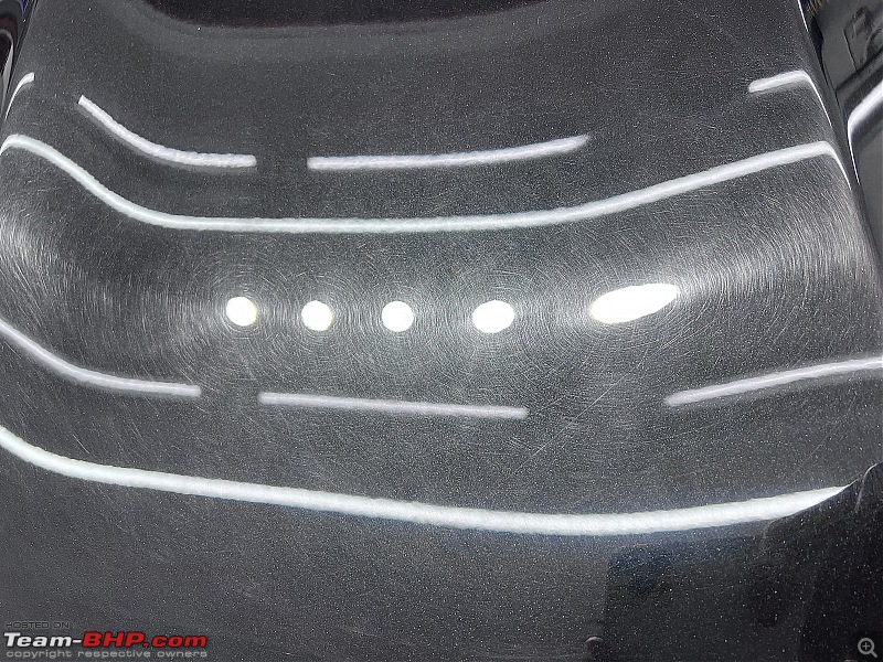

No, don’t use a Jopasu duster as it will swirl your paint over time. Forget about ceramic coatings for a second, just consider the clearcoat, which is a thick, transparent coating from the factory to protect your base coat.
Irrespective of ceramic coating, continuing with your daily cleaner will heavily damage your clearcoat, you’ll get heavy swirls with interlaced deeper scuffs as well as mineral deposits as they don’t dry properly in the morning and water in most Indian cities is hard.
For reference, this what a 2 month old black C-Class looks like after being attacked around 60 times by the daily cleaner-The Ceramic Coating Thread-img_7284.jpeg
To undo this damage, even the most skilled detailer will take off at least 4-5 microns from your clearcoat. You can do it once or twice but repeating this process frequently will result in premature clearcoat failure.
Point I’m trying to get across is, new cars have extremely soft water based paint that swirls like no tomorrow, this takes away the gloss and clarity and makes your car look old. So whether you get a coating or not, please wash it safely and I’d suggest putting a coating on for ease of maintenance as it makes washing a breeze.
You don’t need microfibres for the paint, just use water and air to rinse and dry in a touchless manner on most days and every couple of weeks do a full contact wash with shampoo and wash mitts. Keep 1-2 towels for cleaning your glasses but never wipe paint without lubrication (water is not a good lubricant, it’s a solvent.)
