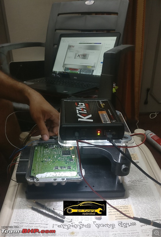

Process of Remap:
  • Disconnect the battery and remove it from the vehicle for easier access to the ECU and the bolts that hold the ECU;
  • Remove the two couplers from the ECU and pull the ECU out;
  • Unscrew the 4 hex nuts and carefully pull the cover off to expose the motherboard;
  • Setup the bench tool (K-Tag Slave Version by AlienTech)
  • Connect the required wires and all probes as prescribed;
  • Read the OE file from the ECU and then go about the modifications as per my requirements;
  • Write the modified file on the ECU;
  • Close the ECU using the sealant and tighten the hex nuts. Remount the ECU and connect the couplers;
  • Reconnect the battery and CRANK it! It's done!!

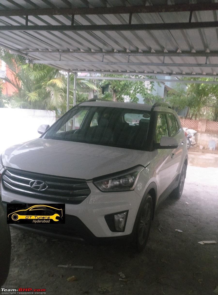

Getting ready to get remapped

ECU placed on the Bench tool for the job
Remapped - Hyundai Creta 1.6L CRDi-6.-ecu-placed-tool-designed-remapping.jpg
Required connections given

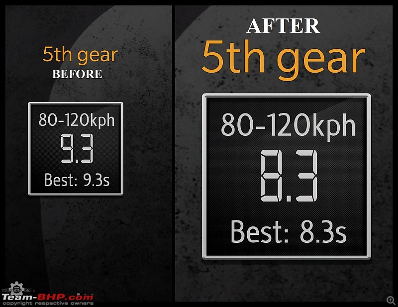

Have used both Torque PRO for 80-120 kmph and also a App called GPS Acceleration for measuring the 60-110 kmph & 80-120 kmph timings
80-120 kmph @ 4th gear
80-120 kmph @ 5th gear - Before vs After

Have driven for almost 120-130 kms post remap and glad to say that the effects are outstanding.
  • Lag in 2nd gear from 1000 RPM is gone
  • 3rd gear onwards the car is a different animal. Already in it's stock state the engine is crazy, now with the remap she is
  • I happy to have upgraded to Brembo's else life would have been miserable post remap.
  • 4th gear from 1000 RPM, it pulls so cleanly till red line without any drama.
  • 1st gear, it pounces ahead like crazy, I have to be careful in bumper to bumper traffic
  • The 'pushed into the seat' effect is fantastic in 2nd, 3rd and 4th gear mainly but in 5th gear the rate of acceleration is crazier.

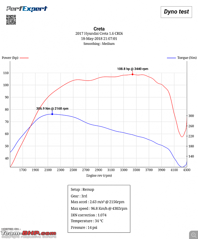

Using the PerfExpert App on my mobile (OnePlus 3T), tried checking for the Power & Torque figures (Approximate).
BEFORE REMAP
Data
Graph
Data
Graph
Data
Graph
Data
Graph
AFTER REMAP
Data
Graph
Data
Graph
Data
Graph
Data (This was in 4th gear)
Graph (This was in 4th gear)
A summary of the results so far

  • I am bad at these Acceleration test (read Launching the car correctly for 0-100 kmph timing values). If done correctly the timing after remap would be some 9.xx seconds.
  • All the videos were shot using mobile holder and NOT holding the mobile in hand.
  • Had a 1+ km long empty closed stretch of the ORR that I used for all these videos and PerfExpert Tests.
  • All the data above from the PerfExpert App should NOT be considered as final. It was just done for a rough idea till I put the car on a Dyno!
