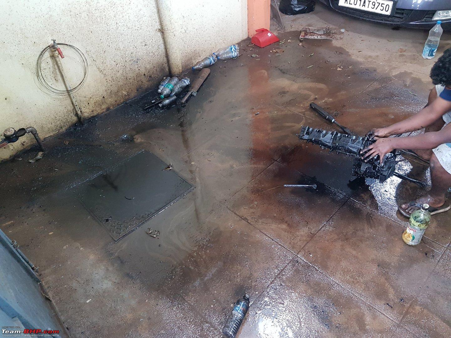

The manifold was first cleaned out thoroughly by Venkat and Chandru by emptying an entire can of gasket cleaner into it. It was then washed out by diesel and the result was a pristine intake manifold, which looked like new.
The picture shows maybe half of the gunk that came out of the manifold. Venkat removed, by hand, just as much of this sludge before this picture was taken. The exercise definitely has cost both of them a few years of their lives. Clean diesel - hah!
