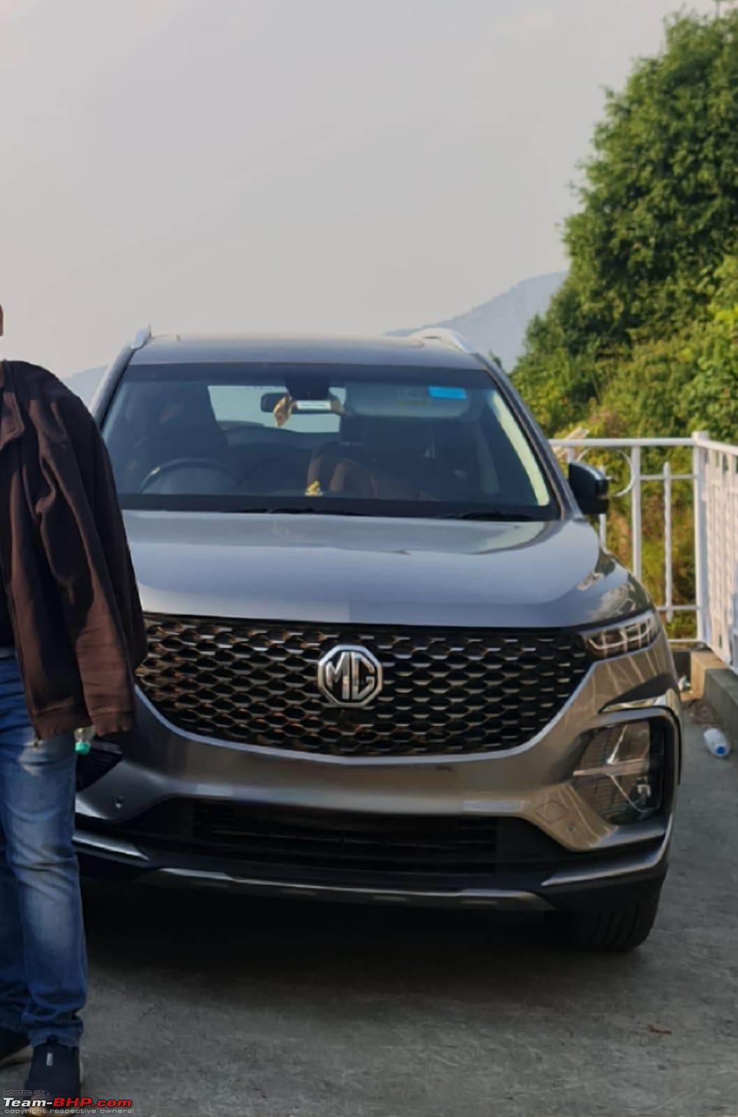

Mine is the pre-facelift Hector Plus. Just spoke with Mr Karan at Autobots and he suggested XP LED projectors from Xenon Planet (90W each). The XPLED 5.0 model with Bi-LED dual laser projectors would cost around Rs 38,000 including the fitment although he promised some discount. Does it look okay or should I go for OSRAM CBI Pro? Should I get my fog lights upgraded too?
My excitement hit a brick wall when I stumbled upon BoneCollector's thread about a "terrible experience" at Autobots Gurgaon. Now I'm having second thoughts about Autobots! Is there any other place that you would recommend?

Well I would recommend you go with Osram CBI pro - they are 45w in low beam and 57w in high beam. Anything higher than this you risk harming the wiring and the electricals of your car. The OE lights are actually 25w low beam and 35w high beam in the Hector Plus.
On Autobots, yes I had also gone through his thread and his experience had put me off. But Autobots is one of the most experienced installers in Gurgaon and I didn't see too many choices. Other options I know are in Noida and Greater Noida. So I took a calculated risk and went with Autobots. The installation in Hector Plus is easy though as it is a direct swap.
On the Xp micro option I would recommend not to go for it as Xp is overpriced and is basically Aes rebranded projectors.

Duly noted. I shall go ahead with OSRAM CBI Pro. Noida and Greater Noida are much closer to my home but finding a truly skilled accessory fitment center feels like searching for a unicorn! :confused: Please suggest some options in these locations. I will be immensely grateful.
Sure I feel that will be the best choice and is proven. Osram is among the best lighting brands in the world (it is German and supplies to all global car companies).
In Noida you have World of service (you can search for the thread on team-bhp) and in Greater Noida you have Uglare (Uglare.com) both are good.
