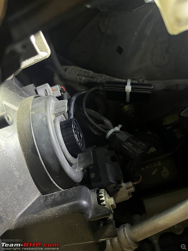

This is how they installed it:

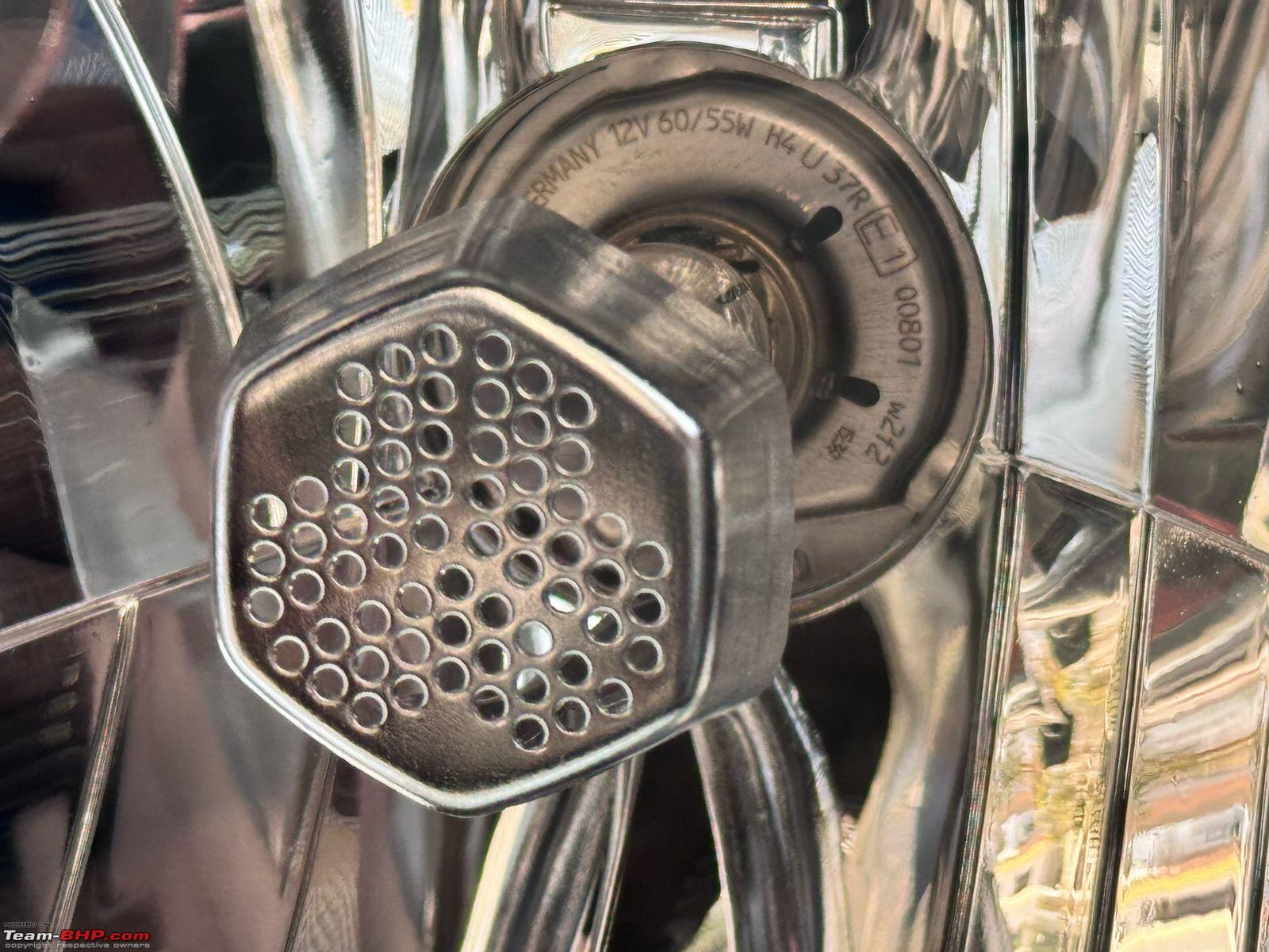

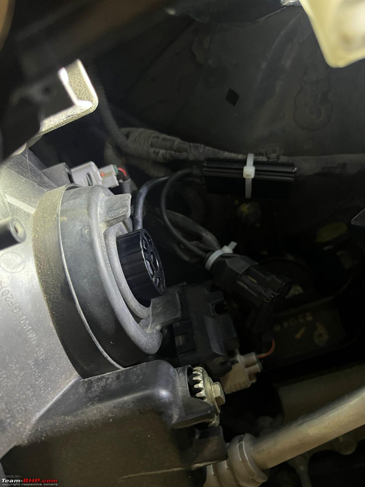

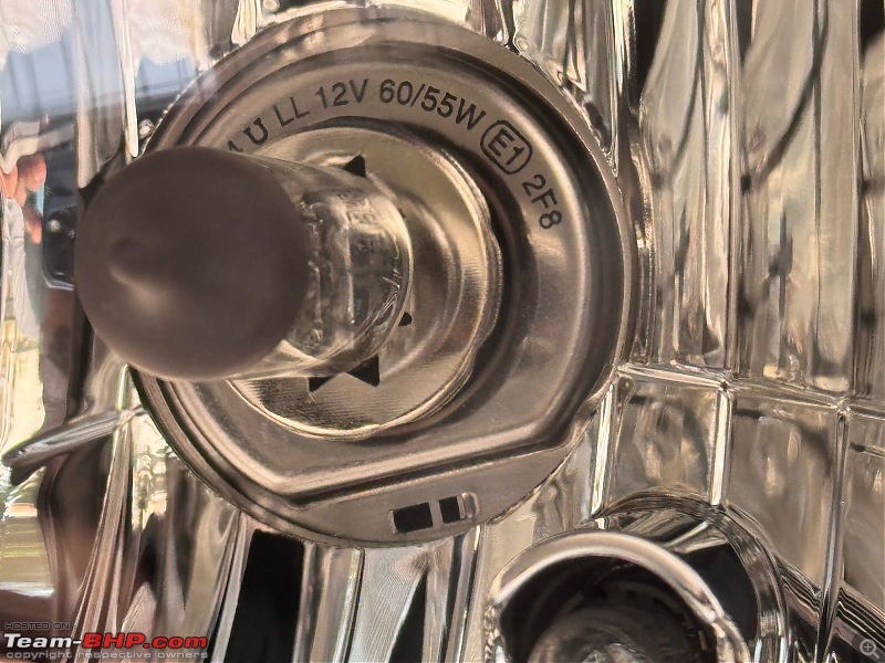

This is how I re-did the installation (For 2 of my cars) Reference video: Here

Just got LEDs for 2 of my cars. Dont go by the hype. Get standard Philips top of the line LEDs. This watt n all business is misleading. Check my post above. 1 car has Exelite Mark3 H4 220W (7000/-) and the other has Philips Ultinon 60W (4500/) philips is better build and overall better value for money. There is hardly any difference in the brightness.
My learning -
headlight housing built for halogens can never equal the quality and performance of true led headlights.
Aftermarkets have fan based heat sinks, which are known for failing. So be prepared to replace in 2-3 years.

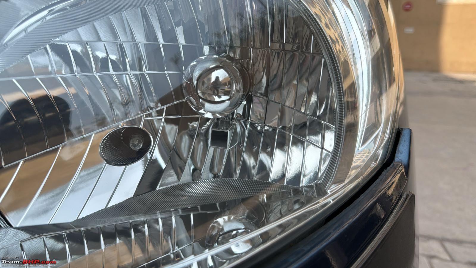

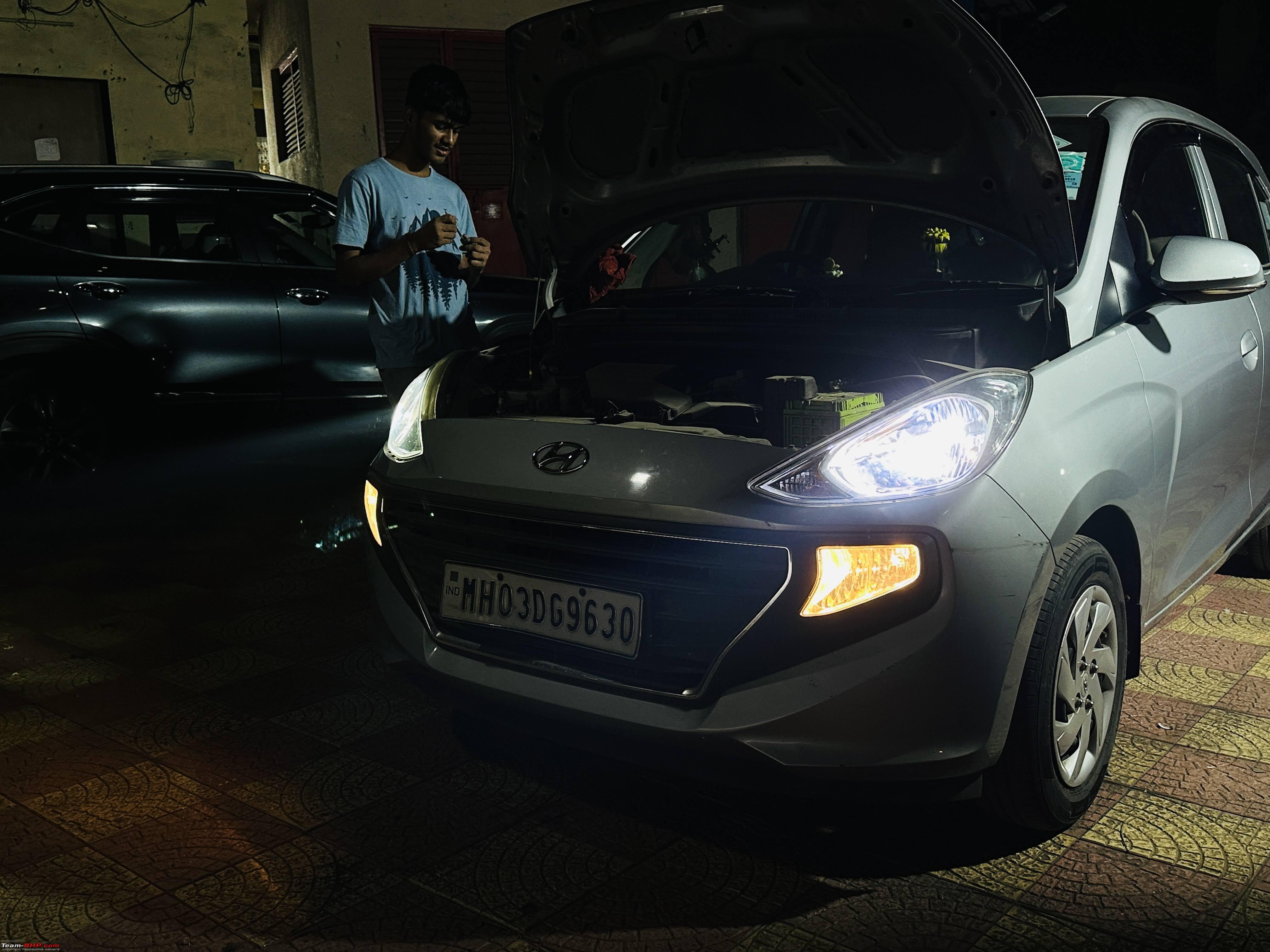

Installing LED Projector Bulbs on a 2019 Santro
I recently upgraded the stock halogen bulbs on my Friend’s 2019 Santro to brighter LED projector bulbs. The installation process was quite simple. First, I removed the original H4 halogen bulbs from the headlight housing. I then ordered a pair of LED projector bulbs from Durvient Lighting Solutions.

To install the new LEDs, I started by installing the LED bulb's mount, which locks the bulb securely in place using the clamp inside the headlight housing. The mounting also includes two small screws for alignment adjustment. By loosening these screws, you can rotate the mount clockwise or counterclockwise to achieve the correct beam alignment.
The mounting
Secured with the Lockpin provided int headlight housing.
Once the mounting was set, I inserted the LED bulb perpendicular to the holder, where it locks securely. After that, I adjusted the beam alignment with those tiny screws on the mount. The new LED bulbs provide a noticeably brighter and clearer throw compared to the stock halogen lights. The projector lens ensures a sharp beam that doesn’t disturb oncoming traffic. The high beam too is perfect, though a bit of alignment would make it more focused on the road.
The original dust cap from the headlight unit fits perfectly over the LED bulb, ensuring no moisture enters and protects the LED module. After aligning the upper beam correctly, everything works perfectly, delivering improved visibility and performance.
A video of it in action.

Precautions and Instructions for Installation
While these instructions are usually mentioned on the product's packaging, they are often overlooked in the excitement of installation. Be sure to follow these important steps:
1.⁠Halogen Bulb Removal: Allow the halogen bulb to cool down completely before handling it. Avoid touching the glass part of the bulb, as oils from your hands can cause damage or shorten its lifespan.
2.⁠LED Installation in a Projector Assembly: Never install the LED while the projector is powered on, as this may harm the projector’s reflector.
In many vehicles, particularly older models and bikes, there’s an external dust cap through which the LED must pass. Ensure the projector assembly is securely locked before completing the installation. A hardened or improperly positioned dust cap can push the LED out of place, risking damage to both the LED and projector components. Avoid touching the LED chip during installation, as this can also cause irreversible damage to the bulb.
Following these steps carefully will help ensure a safe and successful installation.

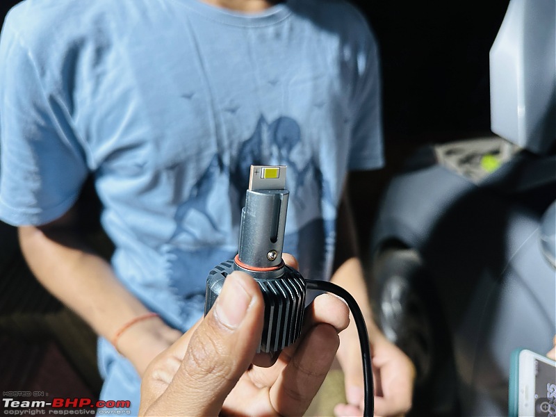

The mini projector bulbs mentioned in this post are compatible with H4, HS1 (commonly used in motorcycles), and H19 (commonly found in Kia and Hyundai vehicles). Although Hyundai sometimes uses H19 bulbs, the 2019 Santro specifically comes equipped with H4 bulbs.
If you require the H19 version, please inform the guys at Durvient. They can provide the necessary fitting, which features two notches/cuts on the mounting ring. Apart from this difference, the H19 bulb is identical to the H4.
Comprehensive guide to LED Headlight upgrades-whatsapp-image-20250317-10.58.40.jpeg
Mini Projector Bulbs Link: https://durvient.com/h4-mini-project...ght-35w-6000k/
Quick Note: These LED projector bulbs are not compatible with headlights that have a shield in front of the bulbs. However, the shield is typically easy to remove, allowing for efficient installation of the LED projector bulb. While older vehicles and motorcycles often featured this type of shield, some newer models, like the Tata Punch, also include it. Fortunately, this shield can be easily detached to accommodate the LED projector bulb. Attaching few Headlight housing Pictures of Punch, i20, and old gen Ertiga.
