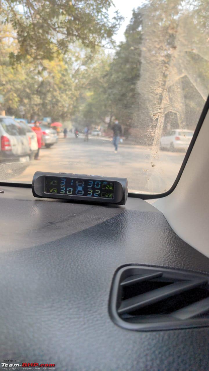

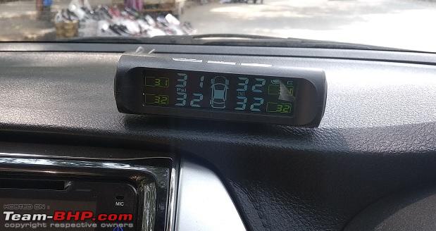

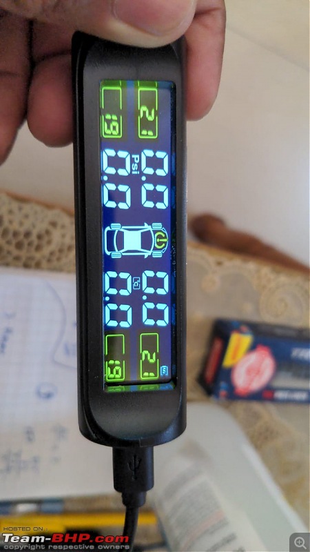

I've purchased and installed the product. Couldn't get time to post a full review. I'll keep this short.
This unit is imported from China and has been rebranded as a Skyshop product. The seller is decent, the unit comes with 6 months warranty, although you can get it extended to one year by posting a review online.
Tip: Contact the seller on Whatspp (no. 95883104(five)(seven)) he will sell the same for 2400 INR!
Coming to the unit, I purchased the internal one, as I didn't want to carry around the tool of the external unit every time you fill air. Additionally, there is a possibility of theft of the external unit.
The sensors are of good quality and looks like they would last a decent time, not sure about the battery life though.
You will have to get these installed at a wheel balancing store. I got the same installed at my local MRF dealer, I was charged 150 per tyre for installation of the sensor (balancing and alignment was charged extra). The total cost was around 1300 INR as I got the balancing and alignment done too.
The display unit has decent visibility in daytime and has a dim mode for night time as well. The features on this are standard- tyre rotation, temperature unit, pressure unit, reset etc. The unit will warn you with an audible beep in case of a tyre leak (both slow and rapid punctures). I'm worried about the quality of the battery inside the unit, as someone on the forum posted bulging of battery in the Chinese display. You may choose to remove the battery and run it directly on USB power (though I did not do this).
Overall, I would recommend this for anyone who is looking for decent and cheaper alternative to Sensyair. Personally, I've purchased two units, one for myself and the other for my dad's car.
Please let me know if you have any questions.
Sorry, don't have many pictures of the same. Attaching a couple.

The Aftermarket TPMS Thread & Review of my Visture Solar TPMS-whatsapp-image-20210211-9.55.49-am.jpeg
The Aftermarket TPMS Thread & Review of my Visture Solar TPMS-whatsapp-image-20210211-1.10.01-pm.jpeg

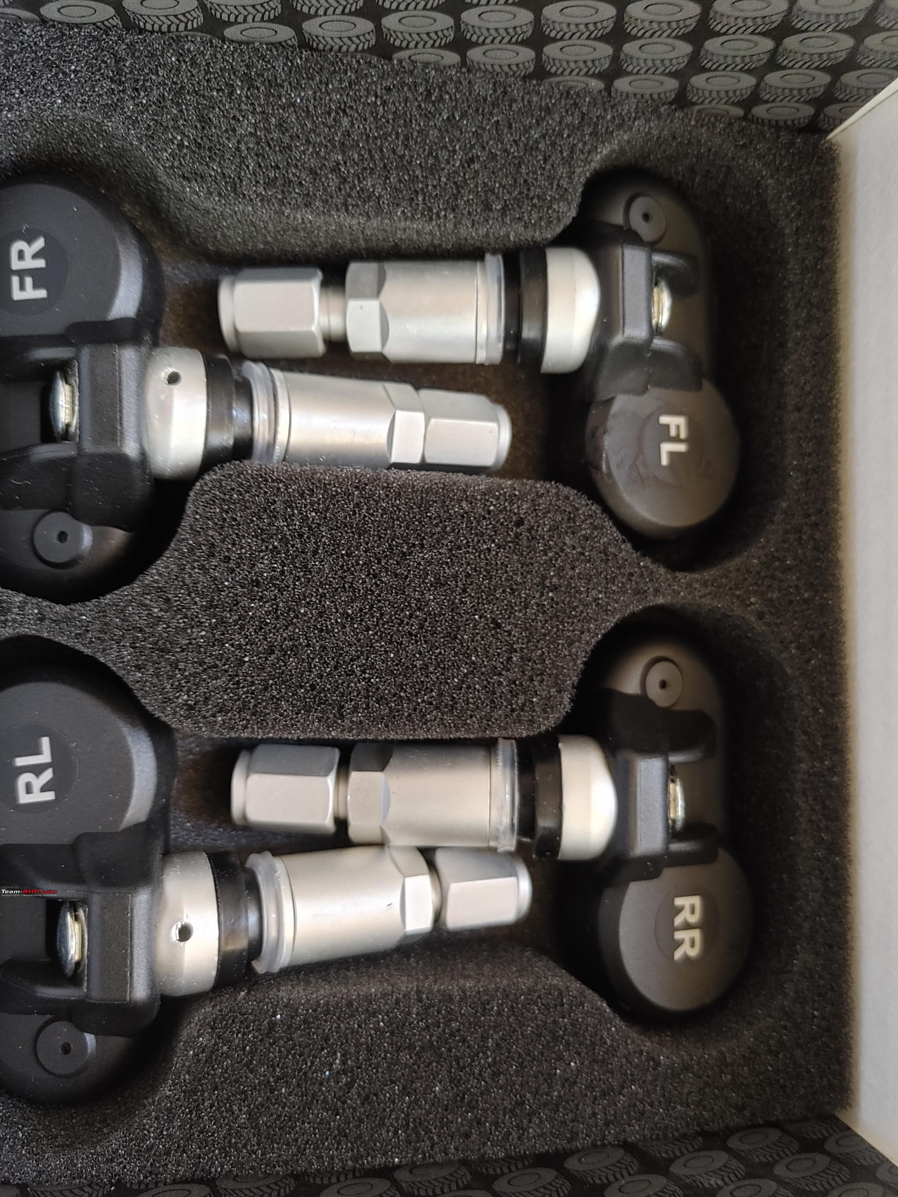

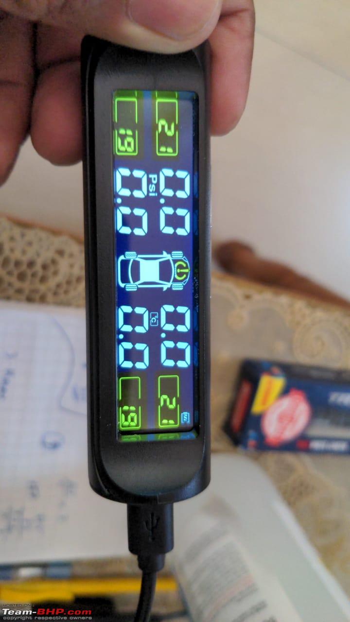

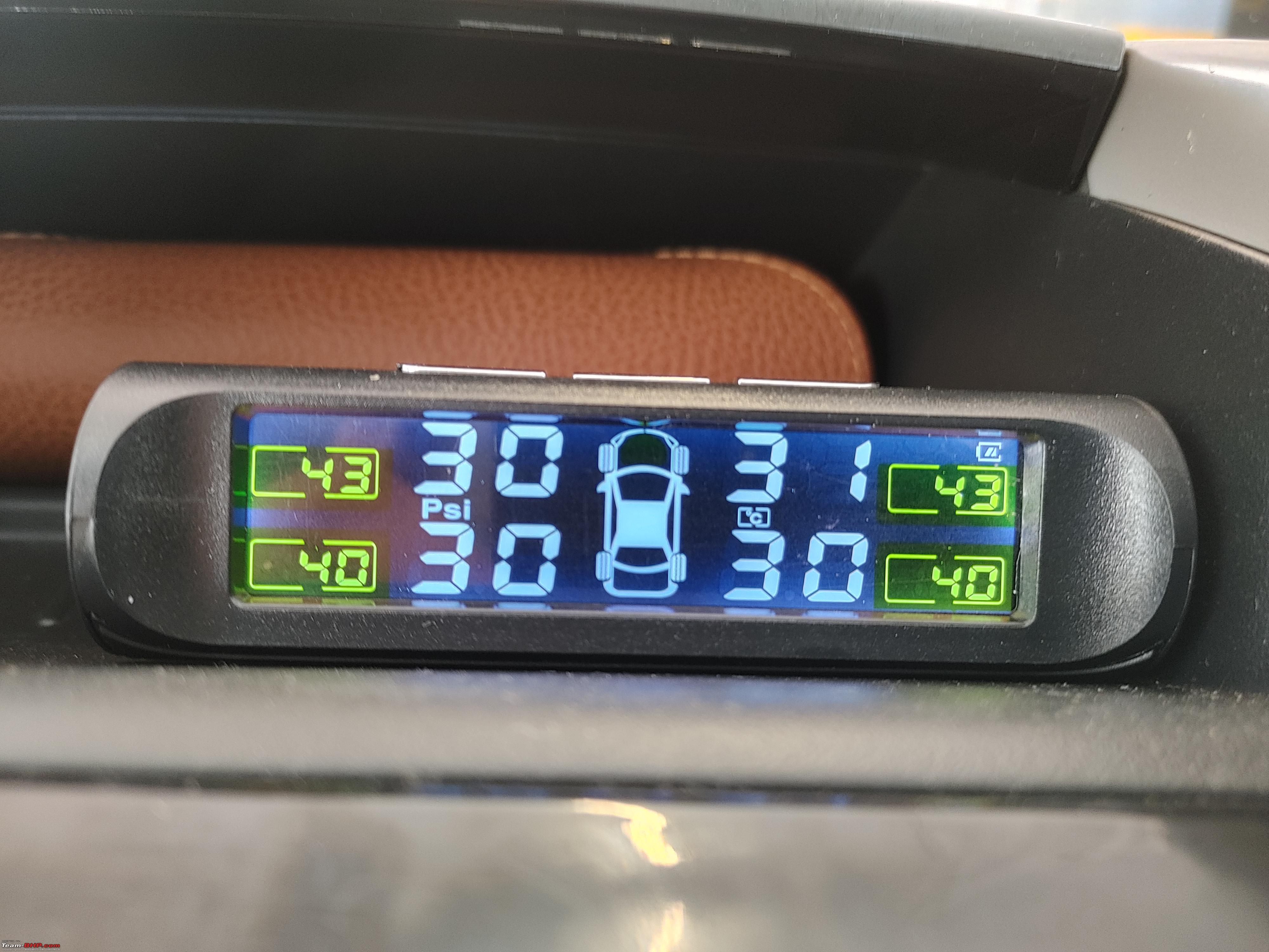

I ordered the internal sensors directly from the seller last week and got the installation done locally today.
All the points are already covered in the trailing post.
I have the same observations
-good quality for the price 2400/-
-quite accurate
-has psi/bar , c/f units
-1 year warranty
-i would recommend this over the app based / wired ones.
-internal sensors do not have replaceable batteries.life expectancy 3 years.
The Aftermarket TPMS Thread & Review of my Visture Solar TPMS-20210303_130620.jpg
The Aftermarket TPMS Thread & Review of my Visture Solar TPMS-20210303_130506_hdr.jpg
The Aftermarket TPMS Thread & Review of my Visture Solar TPMS-20210303_130452_hdr.jpg
The Aftermarket TPMS Thread & Review of my Visture Solar TPMS-20210306_130903_hdr.jpg
ms001 is offline   (7) Thanks

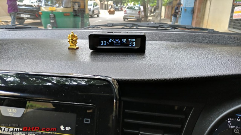

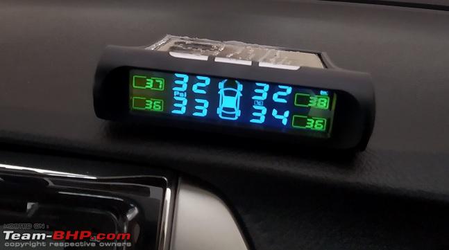

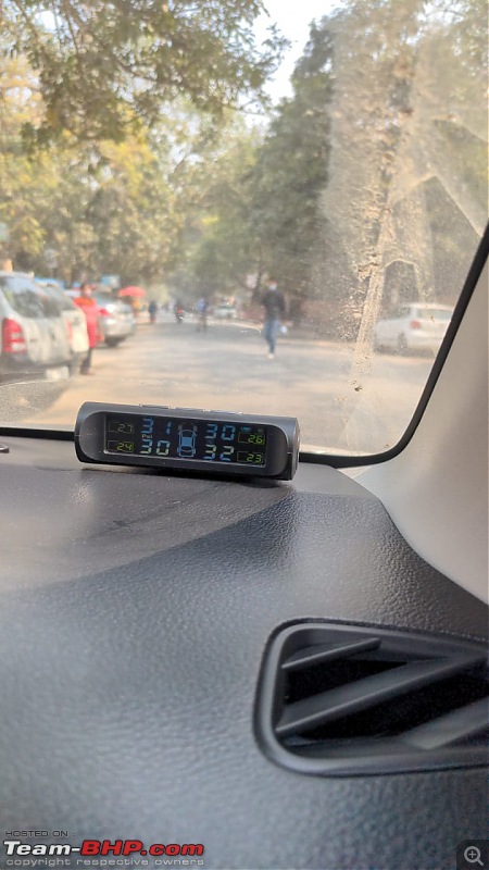

Thanks to both of you. I contacted the seller on WhatsApp. The price of external and internal solar TPMS is the same. Since, this was my first TPMS, I went with the external one as I wanted it to be DIY.
Before installing the TPMS today, I filled the tyre to 32 PSI at the MFR dealer. Noticed that the pressure in the front left tyre was less as compared to the others. Need to monitor it in the coming weeks.
After coming home, I installed the TPMS and noticed that the readings were accurate. After driving for some 15 to 20 minutes, observed that the tyre pressure increased by 1 PSI with the increase in tyre temperature.
After installation
The Aftermarket TPMS Thread & Review of my Visture Solar TPMS-start-reading.jpg
After driving for 15 to 20 minutes
The Aftermarket TPMS Thread & Review of my Visture Solar TPMS-driving-reading.jpg
Overall highly satisfied with the services of the seller and quality of the product.

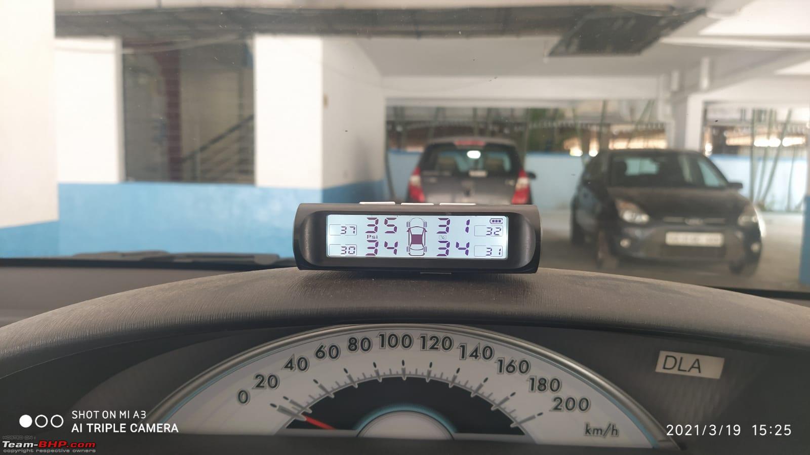

I am using a similar TPMS (external sensor type) which I had brought it in US. I have been using this since last one year or so and I am happy with its performance. For me, the batteries lasted for around 8 months.
But the replacement batteries are not that expensive and I brought them from Amazon at around Rs40 per cell.

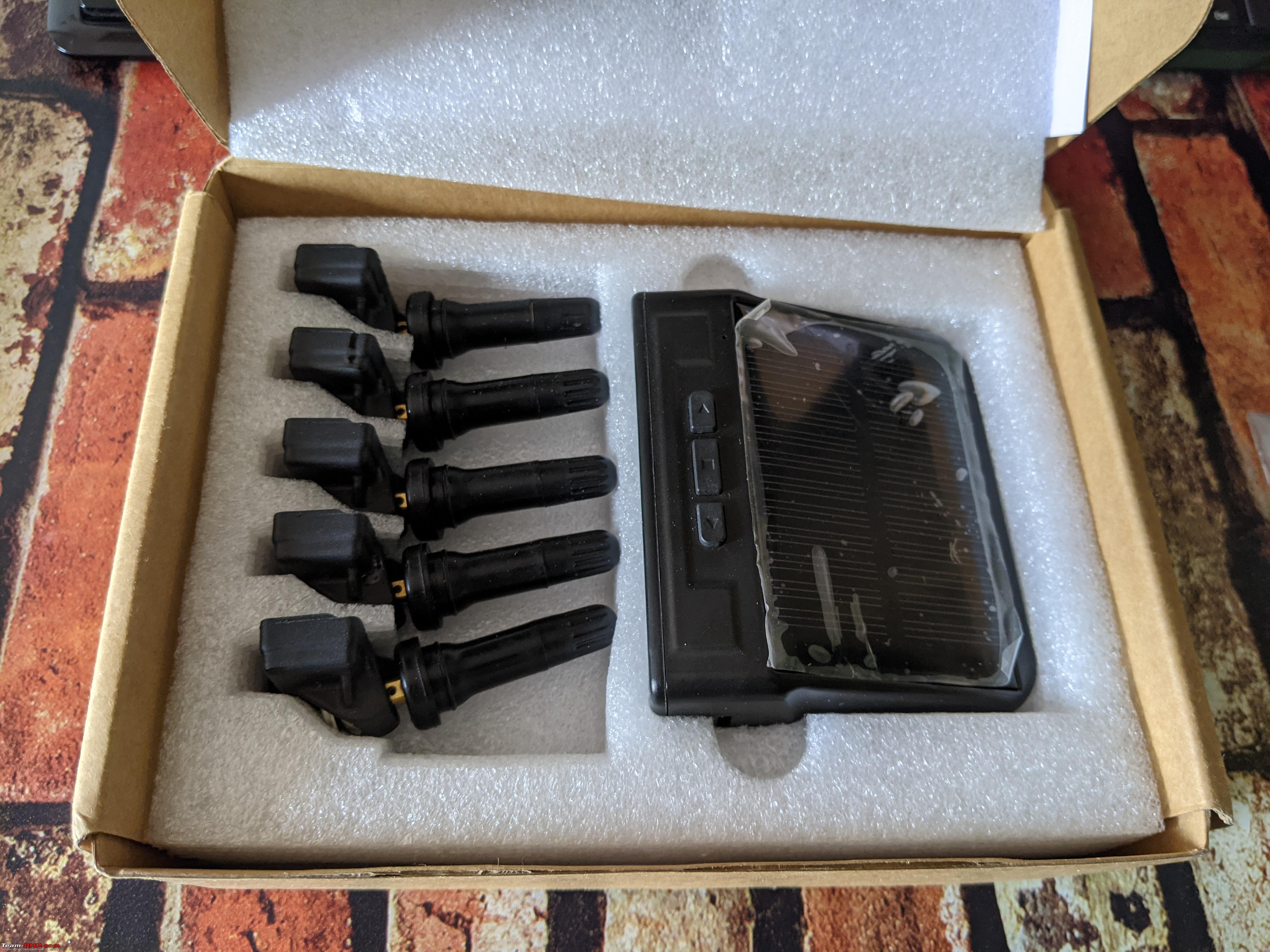

Installed the Manatec Internal TPMS in my XL6 while upgrading tyres. Decided on this TPMS based on feedback from Leoshashi as he does have the previous model of the same TPMS doing duty in his car.
Key Features
1. Display is a big clear monochrome unit that cycles between pressure, temperature and battery voltage readings. Cycling time can also be set.
2. Allows you to reconfigure tyre positions after wheel rotation in the settings menu.
3. Sensors come with replacable batteries (CR2032), which they claim should easily last 5 years.
Post installation, I did have trouble going into settings menu but the Manatec team was very responsive and they were able to provide clear instruction over phone to help complete setup.
Opted to buy the 5 sensor unit for 6.5K INR as I plan to use all 5 tyres of the car. Ordering and delivery experience was very smooth, all discussions were on phone and whatsapp. Payment was made via gpay and the produt was delivered within 2 days. I have not driven much post installation, but the sensors seems to be working fine and the PSI readings seems to be within the +- 2 PSI error range, as compared to the PSI reading in my Michellin tyre inflator.
