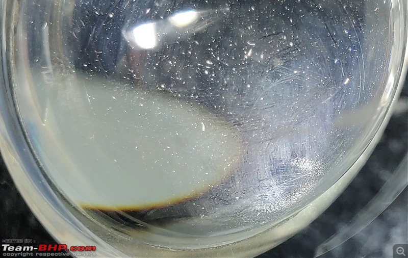

The projectors were installed in another few hours. Point to note is that the social media posts show that the projectors are handled with cotton gloves, wasn't the same here. My projector lenses have many smudges as they were handled with bare dirty hands.
Terrible experience with Autobots, Gurgaon (headlight upgrade)-img_20190901_195547.jpg
Right one with fingerprint marks.
Terrible experience with Autobots, Gurgaon (headlight upgrade)-img_20190901_195525.jpg
Left projector with smudged lense.

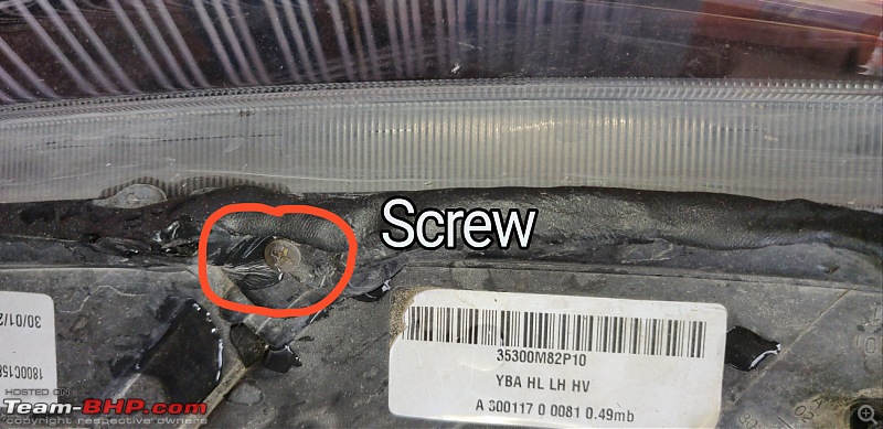

By this time, it was about 9pm and I was concerned with many things. My phone battery was going down, I was hungry and there was no sign of the work getting completed. Since Wednesday is a holiday for them ,I couldn't get it done next day and I couldn't even leave my car overnight. Moreover, they were already getting in holiday mood and partying, with the technician getting angry as he was not getting his share. This was irritating him. Then he got his share and started resealing the headlights. Before I could make out what he was up to, he fixed 2 screws in each headlight saying that it will keep the headlights properly sealed and in the process , screwing my headlights permanently. So much for professionalism. They've used a butyl based sealant which is still soft even after nearly 2 months!
Screw for sealing!!
After resealing the headlights, he fixed it back and then proceeded with wiring. The ballasts were fixed using double sided tape on right side to the headlight's side and on left side it was fixed over the fuse box! I told him that it won't hold but he was adamant that it'll not fall even after few years.

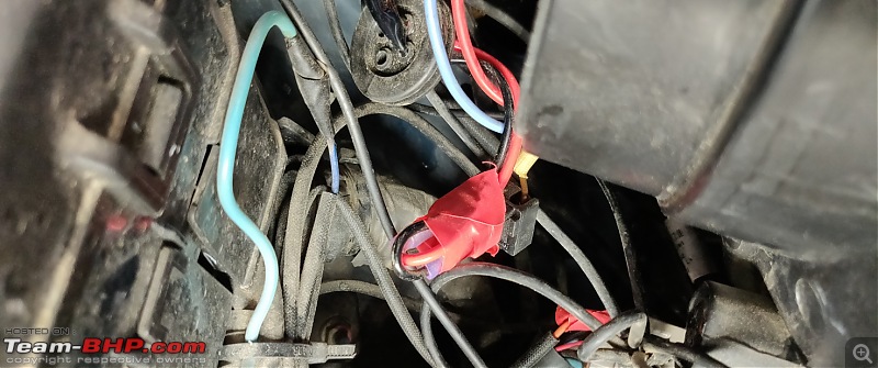

Then he went ahead with the connections and used the electrical tapes to seal it. I told him it won't stay, he said that it's waterproof and doesn't require anything else. Thankfully wires were not spliced.
Terrible experience with Autobots, Gurgaon (headlight upgrade)-uncovered-wiring.jpg
I wonder why they call themselves professionals.
Electric insulation tape which would have come off in a few days.

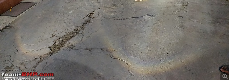

Once the wiring was done, the headlights were switched on first time after resealing and the cut-off and alignment was way off. The technician tried to adjust it but it wasn't happening so he said that this is perfect. By that time, it was 11pm and the owner was busy partying, the technician was in bad mood as he was not given his promised share, and I was aghast! One of the co-owners came and we settled the bill. During the entire crucial period of alignment, only the technician was there and no one else was there to oversee what was happening.
I was scared with the wiring and drove home with a prayer that there shouldn't be any short circuit or fire. Next morning, I checked the wiring and fitment and was dejected. It was not at all the way it should have been as claimed on their social media sites. I was wary of visiting them again, once you lose trust, it's just not possible to do anything. Moreover, I was tied up for next few days till my return and there was no way I was going to waste my 8-9 hours with them. The headlight cutoff was off as you'll see in snaps I'll share, the left side high beam (Brezza has a separate one) was shooting to the ground and the right side beam was tilted in such a way that it wouldn't illuminate the road more than 20 feet.
Terrible experience with Autobots, Gurgaon (headlight upgrade)-poor-cutoff.jpg
Mal-aligned cut-off.
Terrible experience with Autobots, Gurgaon (headlight upgrade)-slant-cutoff.jpg
Slanted right side beam.
Mismatched cut off.
Terrible experience with Autobots, Gurgaon (headlight upgrade)-high-beam-hotspot-.jpg
Left side high beam hot spot is going to the ground.

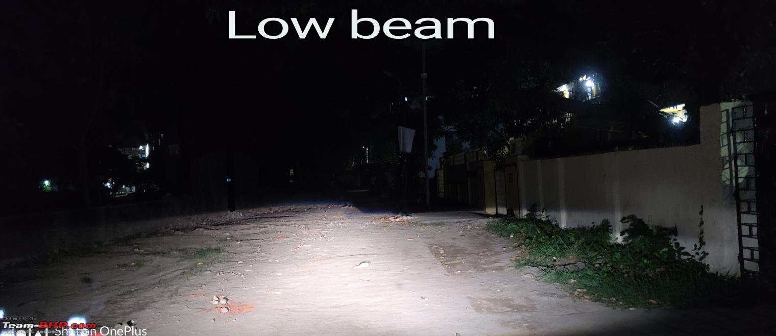

Terrible experience with Autobots, Gurgaon (headlight upgrade)-low-beam1.jpg
Terrible experience with Autobots, Gurgaon (headlight upgrade)-low-beam2.jpg
Low beam hitting the ground too close on right side.
Terrible experience with Autobots, Gurgaon (headlight upgrade)-high-beam.jpg
Acceptable, I can live with it but can't be driving with high beam all the time.

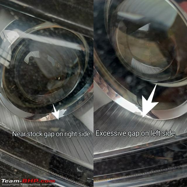

Terrible experience with Autobots, Gurgaon (headlight upgrade)-pixlr_20190821100933584.jpg
Irregular gap on both sides.

I came back home and discussed this with a4anurag and Dr Parvez (X-roaders). I was told that they should have also provided me with a relay for wiring. When I checked with XP guys, they said that the technician may not have felt the need to use it. I was surprised. Their kit also mentions this. I was really not happy. Then I started sending them the cut-off images and other snaps to which they agreed that the work was below expectations and they asked me to come back so that they can get it fixed again at Autobots. Till this time I had not contacted Autobots and seriously I was in no mood to do that, moreover XP guys asked me that they'll themselves deal with Autobots and do a refresher training sort of things, I need not contact them. I told them politely that its not possible for me to drive another 1100kms just for this. I asked them what else can be done? They asked me to get in touch with a local technician who can open the headlights, which is not available here sadly. They asked me to do the alignment by the knobs on the headlights and that's when I realized that their technician had broken those on both sides. I was really helpless. I had a botched retrofit with broken alignment knobs with a very bad wiring. I was really worried so with help of Dr. Parvez, I procured the relay and over a period of 3-4 days, did a thorough redo of the wiring with sealing all joints with waterproof tape. This also gave me an opportunity to open up the front bumper myself thereby sealing the open points of fog lamps as well anything else that I thought required waterproofing.
Terrible experience with Autobots, Gurgaon (headlight upgrade)-img_20190821_112807.jpg
Fixing up the relay and securing the wires and wiring.
