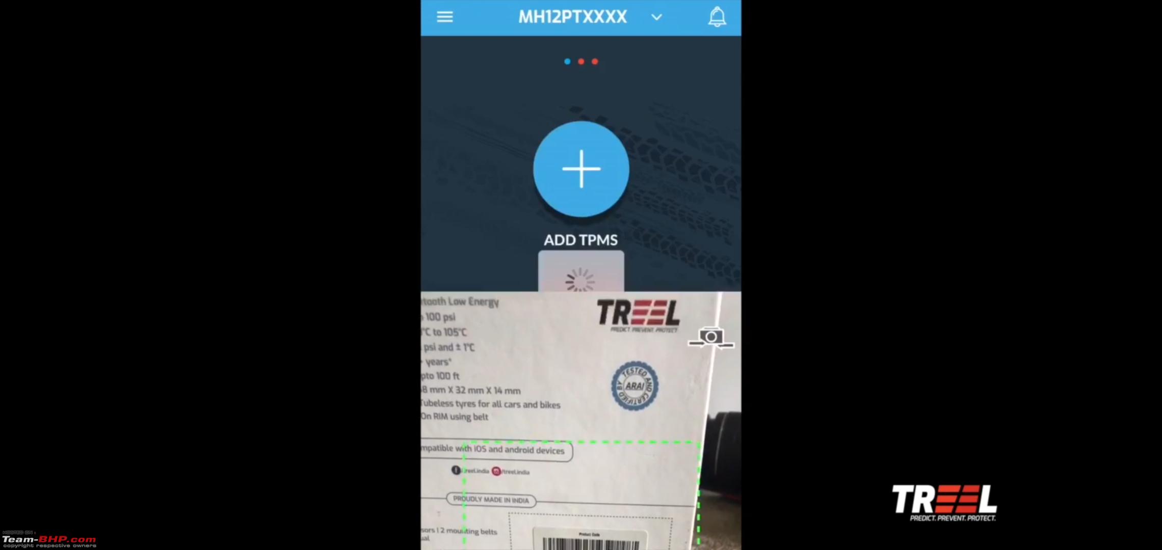

Scan the QR code from app to synchronize and connect the TPMS
Treel (by JK Tyres) launches internal TPMS sensors with Bluetooth-screenshot_20191115100619.jpg

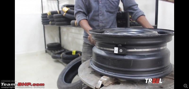

Sensor along with the steel tie along the rim
Treel (by JK Tyres) launches internal TPMS sensors with Bluetooth-screenshot_20191115100746.jpg

However tight one would wrap the metal band, it would still move around, causing issues with wheel balance. There's nothing preventing the band from moving around due to slippage of some kind.

I asked them about slippage and they said the steel wire is wrapped very tightly on the rim ensuring it does not move.

= No it won't required any balancing as the sensor weight is not more than 23 gms and also sits at geometrical center point of Tyre
Do the sensors rotate around the rims freely inside or are they locked in position? The steel wire lock seemed loose in the video.
= No sensor won't rotate as it is locked around rim using ss belt

Got treel installed today. The package also has a set of 3m tapes to hold it in place although the metal strap when tightened leaves little room for movement.
The installer also said that once the air fills up , it will put enough pressure on the sensor to not move. Don’t know if thats true.
