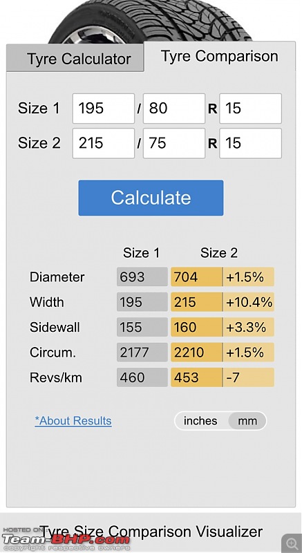

Lift Kit is not required if you stick to tyre size upto 215/75R15. The next size 235/75R15 would require some lift in extreme articulation of axles. I upgraded the tyres to Ceat Crossdrive AT 215/75R15 for the time being, and am extremely happy, very silent tyres on the highway – they perform very well under all extreme conditions.
As Indian law does not allow metal bumpers or bull bars (snorkel at front), so lift kits do not have to compensate for overhanging heavy weights. So I wanted a lift kit which was on softer side, gave a cushioned ride and helped in extreme articulation.
The very stiff and overpriced well known suspensions were ruled out by me. I settled for a European Lift Kit which offered all options of Soft, Medium and Stiffer suspensions depending on individual requirements and accessories to be added. And they offered PU bushes on Shockers and Castor & Pinion Angle Correction Bushes. This made in EU kit included all parts required for the upgrade. And I was informed that they have an Indian partner who has kits in stock in India – WOW.

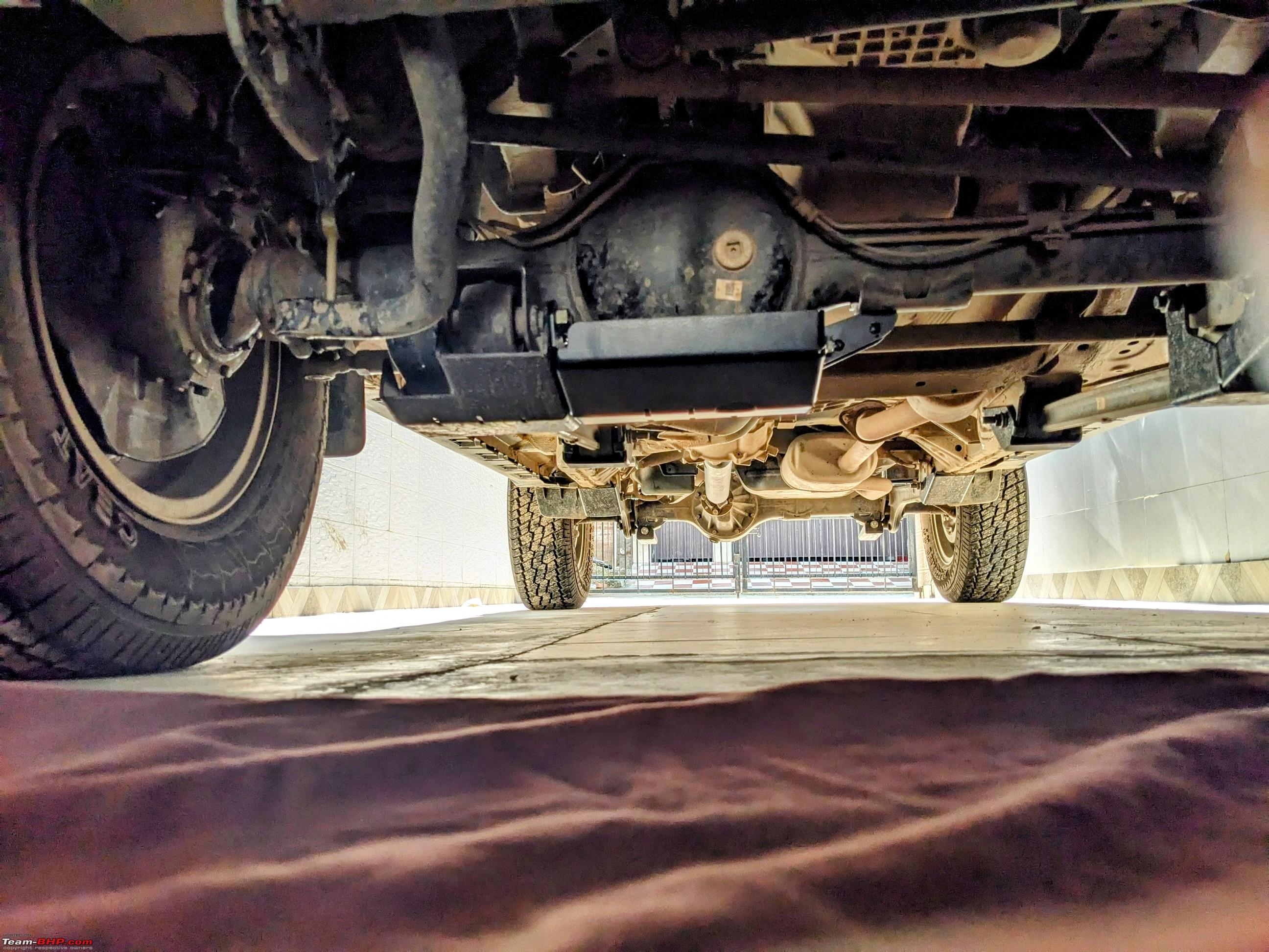

PROTECTIONS FOR THE UNDERBODY
All though I did not face any problems with the ground clearance on my Sach Pass trip (without Lift Kit) with four adults and their luggage in the car, still I wanted to install underbody protections for extreme off-roading if I plan someday. And I wanted these to be practical and light weight considering the Jimny’s Weight and Power. The excellent design team at 4XFORZA came out with unique skid plates for the Jimny. I could see these designs were new, unique and different from all other types available elsewhere (In China, UK, Australia or Japan).
Another reason for installing these is to bring the lifted Jimny’s CG lower by adding some weight down under.
I intend to install these protection in a couple of days and will surely share pictures here.

Regarding tyre size of 215/75R15 vs. stock size of 195/80R15, I am posting a tyre comparison done using an online calculator linked below:
https://tiresize.com/tyre-size-calculator/
The difference in diamter, circumference and revolutions/mile (1.6km) can be seen in the screenshots below along with the speedometer error. Your car speedometer will show slightly lower reading compared to actual speed so you need to drive 3-4kmph slower than the speed limit to stay within range (Car manufacturers caliberate the speedometer to show marginally higher speed than actual so I guess it would be fine).
As a rule, upsize in a manner that the speedo error and diameter of the upsized tyre stays within 2% of the OEM. Yours is within that limit so you are fine.

I will share the pictures of some underbody protections that I have installed:
Rear Shocker Skid Plates as seen from all sides:
Personalizing my Maruti Jimny - Lift Kit, Snorkel, Protections, Storage Spaces, Seat Height & Winch-pxl_20230911_112111548.jpg
Personalizing my Maruti Jimny - Lift Kit, Snorkel, Protections, Storage Spaces, Seat Height & Winch-pxl_20230911_112120310.jpg
Personalizing my Maruti Jimny - Lift Kit, Snorkel, Protections, Storage Spaces, Seat Height & Winch-pxl_20230911_112137620.jpg
Personalizing my Maruti Jimny - Lift Kit, Snorkel, Protections, Storage Spaces, Seat Height & Winch-pxl_20230911_112441863.jpg
