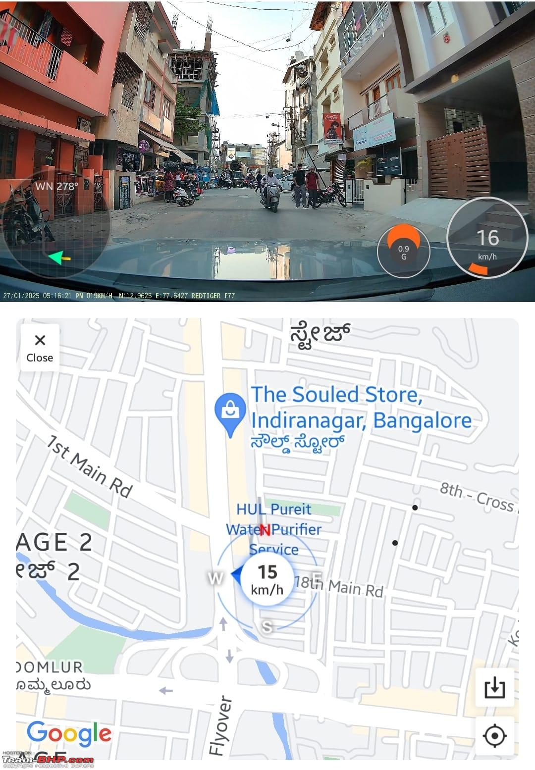

Redtiger F77 review:
The Redtiger F77 is a great VFM dashcam with the World's first Dual 4K HDR Sony Starvis 2 (IMX 678, 1/1.8" 8 MP) sensor for both front and rear cameras. It may sound like an overkill but it fitted my budget and also has a built in 128GB eMMC storage, which is more reliable and faster than SD cards. Nearest competitor is the VIOFO A329 priced at 40K with only a Starvis 2 (IMX 675, 1/2.8" 5 MP) rear sensor, without any free SD card and no free hardwire kit.
What I liked:
• Dual Starvis-2 sensor 4K Recording is amazing (Don't miss the day & night video footages at the end)
• HEVC/H.265 codec consumes half of H.264 storage space
• Free 128GB eMMC 5.1 Built-In Storage
• Super capacitor based
• 5.8GHz WIFI & APP Control (224 MB file download takes 28 secs i.e 8 MB/sec)
• Smart Voice Control (Take picture and Lock the video are my favourites)
• Vibrant and sharp 4" display (Clock view is handy)
• Real-Time GPS Tracking
• Free Parking Monitor Hardwire Kit
• 2 Year warranty (Register on Redtiger website to get extra 6 months)
• It's a steal for that price (Cheaper to buy in India than in the USA)

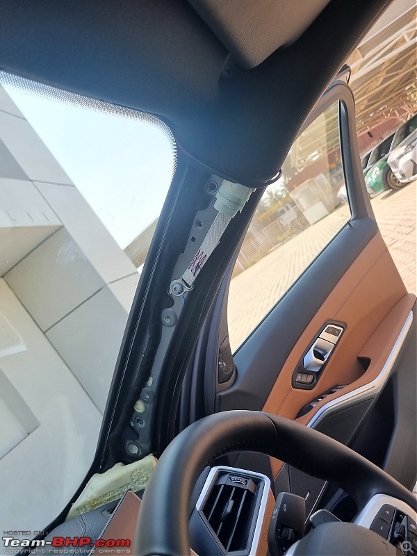

DIY Install:
Took me around 90 minutes to install it including the pre-planning to position it correctly. In spite of this, I had to remove and reposition the front camera once. In both the A pillars some wiring is visible because I didn't want to open the airbag cover and I couldn't pry open the C pillar section. Rest of the cabling is hidden. Overall, I didn't expect the cabling to come out so well. I am sure it can be bettered.
I routed the front camera cable exactly as shown by the blue line (see pic below), but on the driver side. For the rear camera, I routed it on the passenger side down the A Pillar and under the door weather stripping at the floor level. I placed the front camera slightly below the IRVM so that I can see the clock display while driving.
Wiring route:
Grey Hulk gets a Redtiger - Why I chose Redtiger F77 Dual Starvis 2 (IMX 678) Dash Cam for my 330Li-f77-wiring.jpg
Passenger side view:
Grey Hulk gets a Redtiger - Why I chose Redtiger F77 Dual Starvis 2 (IMX 678) Dash Cam for my 330Li-20250104_191344.jpg

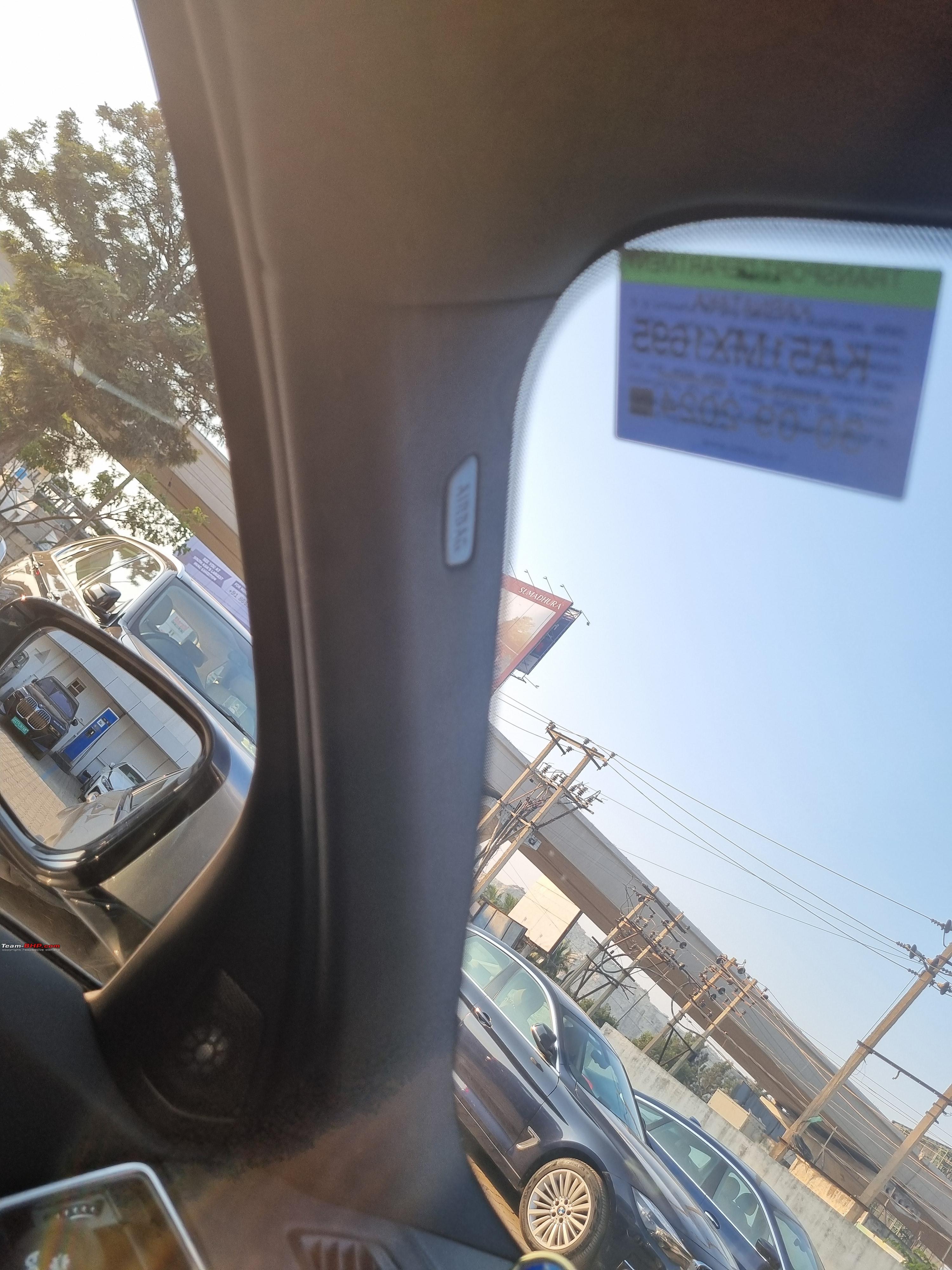

Front camera routing:
Grey Hulk gets a Redtiger - Why I chose Redtiger F77 Dual Starvis 2 (IMX 678) Dash Cam for my 330Li-20250104_192249.jpg
Grey Hulk gets a Redtiger - Why I chose Redtiger F77 Dual Starvis 2 (IMX 678) Dash Cam for my 330Li-20250103_194113.jpg
Grey Hulk gets a Redtiger - Why I chose Redtiger F77 Dual Starvis 2 (IMX 678) Dash Cam for my 330Li-front-wiring.jpg

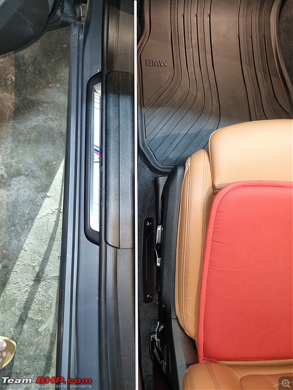

Rear camera routing:
Grey Hulk gets a Redtiger - Why I chose Redtiger F77 Dual Starvis 2 (IMX 678) Dash Cam for my 330Li-20250104_191850.jpg
Grey Hulk gets a Redtiger - Why I chose Redtiger F77 Dual Starvis 2 (IMX 678) Dash Cam for my 330Li-20250104_192826.jpg
Grey Hulk gets a Redtiger - Why I chose Redtiger F77 Dual Starvis 2 (IMX 678) Dash Cam for my 330Li-20250104_193409.jpg
Grey Hulk gets a Redtiger - Why I chose Redtiger F77 Dual Starvis 2 (IMX 678) Dash Cam for my 330Li-20250104_193423.jpg
Grey Hulk gets a Redtiger - Why I chose Redtiger F77 Dual Starvis 2 (IMX 678) Dash Cam for my 330Li-20250104_193442.jpg
Grey Hulk gets a Redtiger - Why I chose Redtiger F77 Dual Starvis 2 (IMX 678) Dash Cam for my 330Li-20250106_183804.jpg
Grey Hulk gets a Redtiger - Why I chose Redtiger F77 Dual Starvis 2 (IMX 678) Dash Cam for my 330Li-20250106_183859.jpg

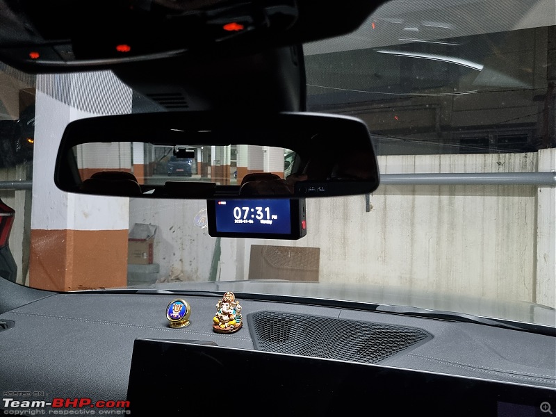

Driver side view (you can see the rear camera through the IRVM):
Grey Hulk gets a Redtiger - Why I chose Redtiger F77 Dual Starvis 2 (IMX 678) Dash Cam for my 330Li-20250106_193147.jpg

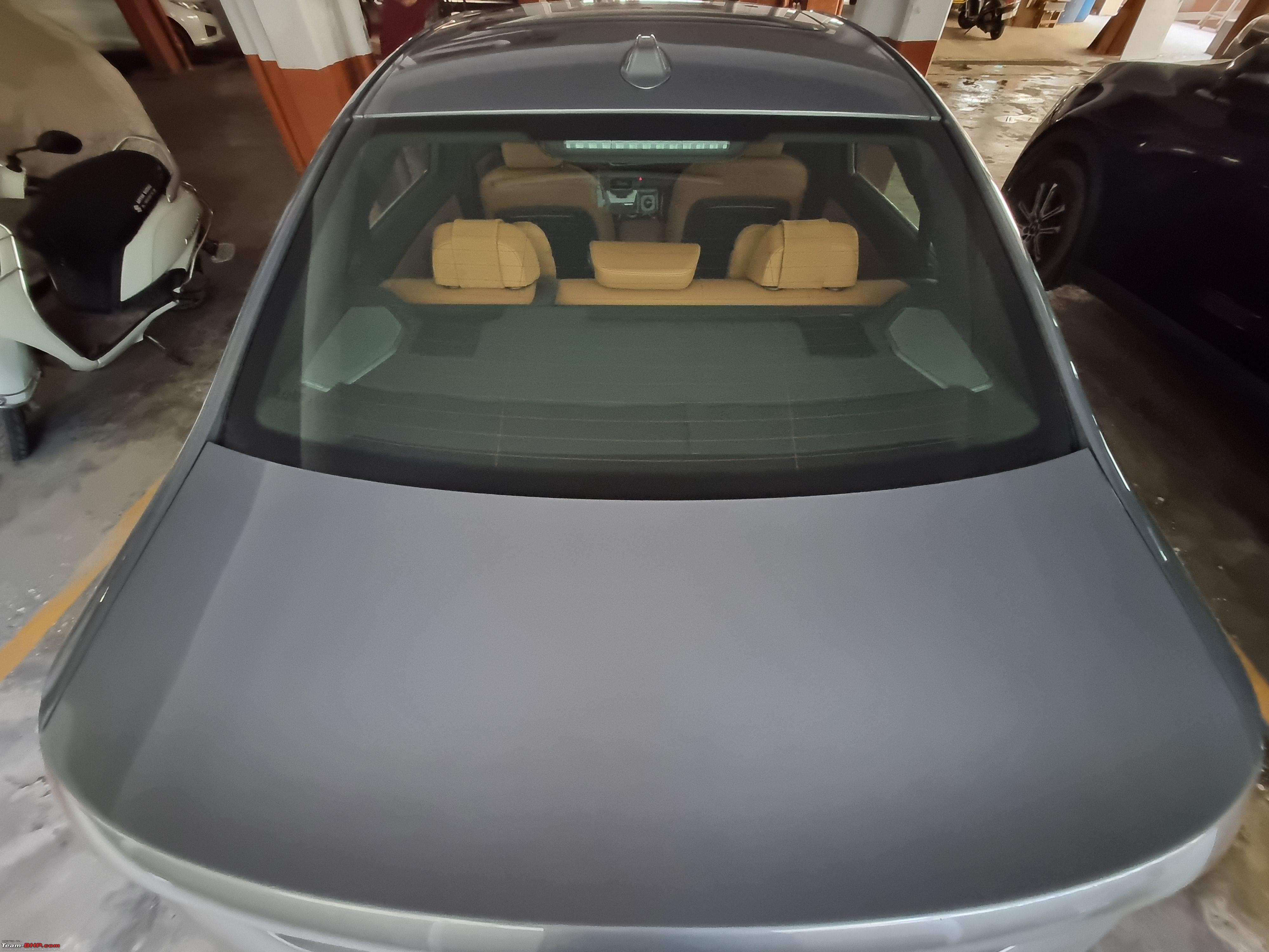

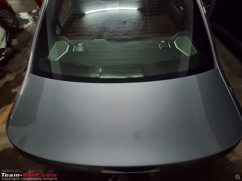

View from Outside:
Grey Hulk gets a Redtiger - Why I chose Redtiger F77 Dual Starvis 2 (IMX 678) Dash Cam for my 330Li-r77-front-view.jpg
Grey Hulk gets a Redtiger - Why I chose Redtiger F77 Dual Starvis 2 (IMX 678) Dash Cam for my 330Li-20250106_193317.jpg

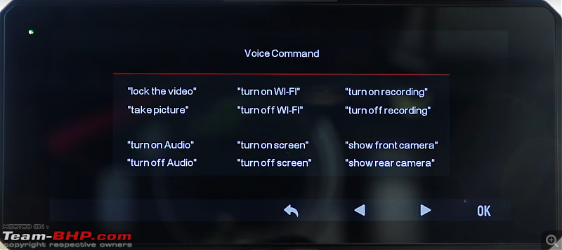

F77 Software settings:
Grey Hulk gets a Redtiger - Why I chose Redtiger F77 Dual Starvis 2 (IMX 678) Dash Cam for my 330Li-redtiger-setting1.png
Grey Hulk gets a Redtiger - Why I chose Redtiger F77 Dual Starvis 2 (IMX 678) Dash Cam for my 330Li-redtiger-setting2.png
Grey Hulk gets a Redtiger - Why I chose Redtiger F77 Dual Starvis 2 (IMX 678) Dash Cam for my 330Li-redtiger-setting3.png
Grey Hulk gets a Redtiger - Why I chose Redtiger F77 Dual Starvis 2 (IMX 678) Dash Cam for my 330Li-redtiger-setting4.png
Grey Hulk gets a Redtiger - Why I chose Redtiger F77 Dual Starvis 2 (IMX 678) Dash Cam for my 330Li-redtiger-setting5.png

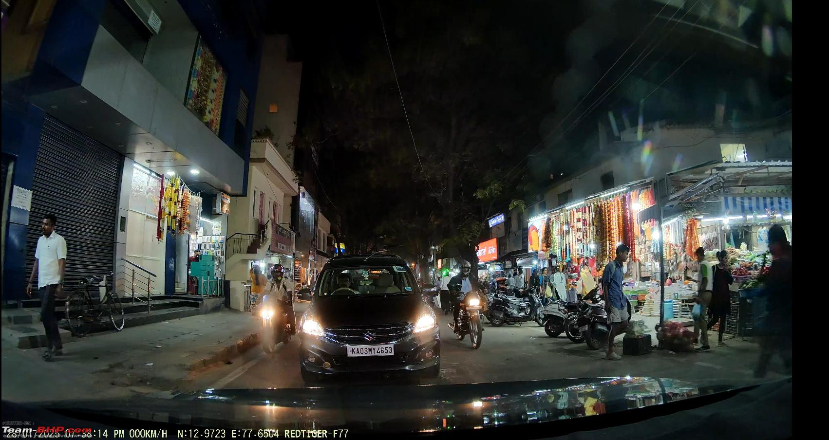

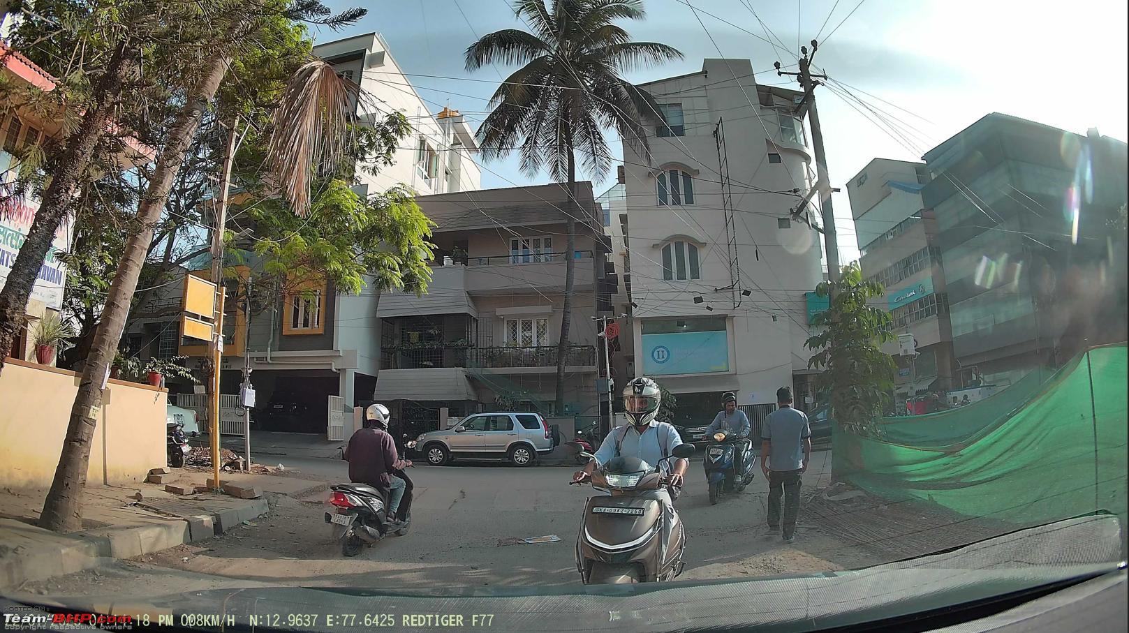

How to reduce glare & reflections in your dashcam footage without a CPL Filter:
Since there is no OEM CPL for the F77, I was forced to find my own way of reducing glare in the dashcam footage. The front camera lens diameter is 14.9 mm and has a 1.5 mm bulge. Space around the lens is only 35mm x 23mm, so a third party CPL filter cannot be installed.
Windscreen reflections were visible during day & night at the front & rear.

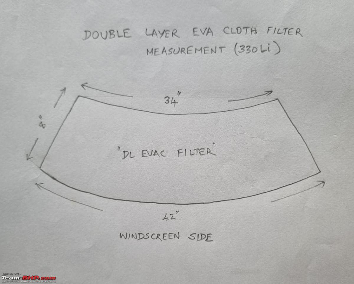

Evolution of the EVA Cloth (EVAC) filter:
Grey Hulk gets a Redtiger - Why I chose Redtiger F77 Dual Starvis 2 (IMX 678) Dash Cam for my 330Li-gridart_20250121_104951583.jpg
The above Single Layer (SL) (3.5" wide) EVAC Filter (created a black shadow in the footage because of undulations in the cloth when placed at the rear):
Grey Hulk gets a Redtiger - Why I chose Redtiger F77 Dual Starvis 2 (IMX 678) Dash Cam for my 330Li-20250126_125759.jpg
FINAL Double Layer (DL) EVAC Filter: I made another piece of EVAC filter that would slightly ovelap the first layer and make it wider (8") so that the undulations are away from the FOV as shown below:

Note: The DL EVAC filter can be made as a single 8" piece measuring: 42" circular width (near windscreen) and 34" circular width at the other end (to make it 8" wide)

Daylight view Near KR Puram Rly Station (Before)
Grey Hulk gets a Redtiger - Why I chose Redtiger F77 Dual Starvis 2 (IMX 678) Dash Cam for my 330Li-near-kr-puram-rly-station-before.jpg
Daylight view Near KR Puram Rly Station (After EVAC filter) - It was the day before I darkened that stitching
Grey Hulk gets a Redtiger - Why I chose Redtiger F77 Dual Starvis 2 (IMX 678) Dash Cam for my 330Li-near-kr-puram-rly-station-after.png

Low light (Before)
Grey Hulk gets a Redtiger - Why I chose Redtiger F77 Dual Starvis 2 (IMX 678) Dash Cam for my 330Li-night-front-before.png
Low light (After EVAC filter) - Starvis 2 Sensor is at its best when headlight falls directly on the number plate
Grey Hulk gets a Redtiger - Why I chose Redtiger F77 Dual Starvis 2 (IMX 678) Dash Cam for my 330Li-night-front-after.png

The rear blind reflection was really testing my patience which led to the creation of the Double Layer (DL) EVAC filter.
The greyish black textured EVA Mat gave it this look:
Grey Hulk gets a Redtiger - Why I chose Redtiger F77 Dual Starvis 2 (IMX 678) Dash Cam for my 330Li-eva-textured-side.png
The cloth tape covered EVA Mat gave it this look:
Grey Hulk gets a Redtiger - Why I chose Redtiger F77 Dual Starvis 2 (IMX 678) Dash Cam for my 330Li-eva-tape.jpg
The Black T-shirt cloth wrapped EVA Cloth Filter (i.e. Single layer (SL) EVAC) gave it this look:
Grey Hulk gets a Redtiger - Why I chose Redtiger F77 Dual Starvis 2 (IMX 678) Dash Cam for my 330Li-sl-evac.png
In pics with the SL EVAC filter, there was a slight black shadow above the boot lip, which can be clearly seen in the above and below pics.
With SL EVAC filter:
Grey Hulk gets a Redtiger - Why I chose Redtiger F77 Dual Starvis 2 (IMX 678) Dash Cam for my 330Li-rear-prefinal.jpg
Finally, nailed it with the Double Layer (DL) EVAC filter.
With DL EVAC filter:
Grey Hulk gets a Redtiger - Why I chose Redtiger F77 Dual Starvis 2 (IMX 678) Dash Cam for my 330Li-rear-final.png

• To see the GPS map view along with video footage and to slow down/speed up the downloaded video use the Redtiger app on your phone/laptop and view it in its Album:
Grey Hulk gets a Redtiger - Why I chose Redtiger F77 Dual Starvis 2 (IMX 678) Dash Cam for my 330Li-reditger-app-view.jpg
• Only way to zoom into a downloaded video is to go into the Redtiger folder in your phone's gallery.

I visited the Kun SC last weekend and learnt that the airbag goes along the headliner all the way from the A pillar to the C pillar and drops down along the window. Actually, the airbag strap is behind that cover and you can see the start of the airbag.
I got them to remove the airbag cover on the right and left side and the technician routed the wire behind the black cable that goes between the A pillar and windscreen. It was a 15 min job.
Fortunately, didn't have to remove/re-route any other part of the dashcam cable since the previously routed length was perfect for this re-route.
Sharing some pictures below (couldn't find any such pictures in my searches):
FR airbag cover removal
Grey Hulk gets a Redtiger - Why I chose Redtiger F77 Dual Starvis 2 (IMX 678) Dash Cam for my 330Li-fr-airbag-cover-removal.jpg
FR airbag cover removed
Grey Hulk gets a Redtiger - Why I chose Redtiger F77 Dual Starvis 2 (IMX 678) Dash Cam for my 330Li-fr-airbag-cover-removed.jpg
FR wire re-routed
Grey Hulk gets a Redtiger - Why I chose Redtiger F77 Dual Starvis 2 (IMX 678) Dash Cam for my 330Li-fr-wire-rerouted.jpg
FR finished view
Grey Hulk gets a Redtiger - Why I chose Redtiger F77 Dual Starvis 2 (IMX 678) Dash Cam for my 330Li-fr-finished-view.jpg
FL airbag cover removal
Grey Hulk gets a Redtiger - Why I chose Redtiger F77 Dual Starvis 2 (IMX 678) Dash Cam for my 330Li-fl-airbag-cover-removal.jpg
FL airbag cover removed
Grey Hulk gets a Redtiger - Why I chose Redtiger F77 Dual Starvis 2 (IMX 678) Dash Cam for my 330Li-fl-airbag-cover-removed.jpg
FL wire re-routed
Grey Hulk gets a Redtiger - Why I chose Redtiger F77 Dual Starvis 2 (IMX 678) Dash Cam for my 330Li-fl-wire-rerouted.jpg
FL finished view
Grey Hulk gets a Redtiger - Why I chose Redtiger F77 Dual Starvis 2 (IMX 678) Dash Cam for my 330Li-fl-finished-view.jpg
Hope this helps!
