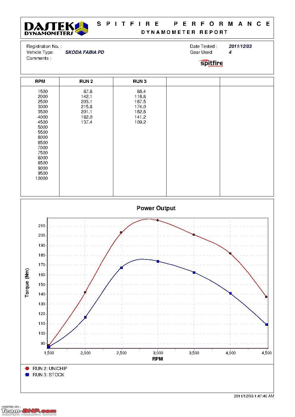

Re: Fabia modification 1.4 tdi - dyno results
Dyno results of the Skoda Fabia PD attached. With the right tune, you can easily get 25% extra torque and power.
