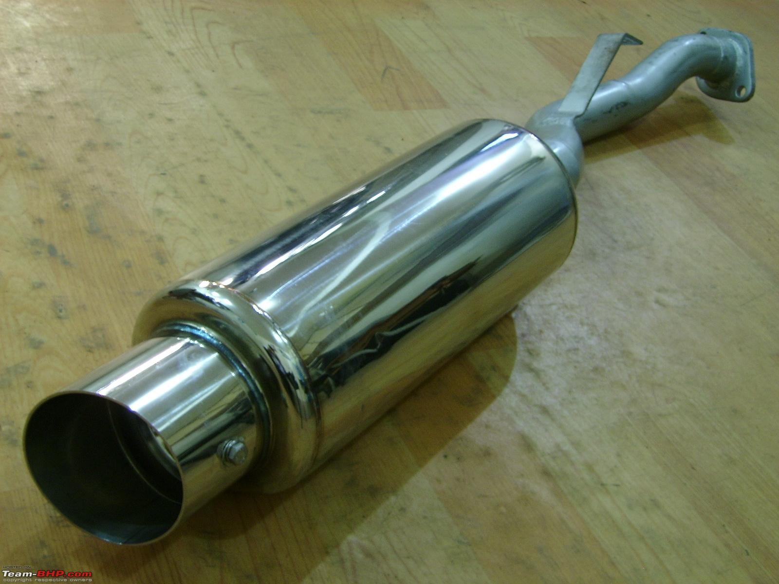

Thanked: 12 Times
HKS with removable inner silencer
Search for "hks removable inner silencer". The db range should definitely be between the stock mufflers and the other performance muffler designs out there. And what I had seen elektra was the exact same design on these Hks ones.. so may be you should have a talk with them first IMO..
See attached pics of the end-can that is part of the FFE made for my Lancer by Electra. It is based on the HKS Silent Hi Power design. Note the inner "ring" that is attached in the muffler - this is what muffles the sound a bit more. Unlike the original HKS mufflers, these aren't very easily detachable. The heat of the exhaust tends to "weld" the nut in place!
This is definitely a little lower on the sound, but you have to sacrifice a bit on the power gains too (about 5% less gain as per Krupesh Patel).
