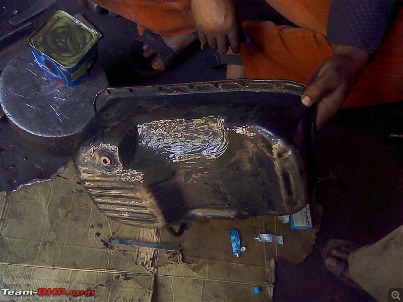

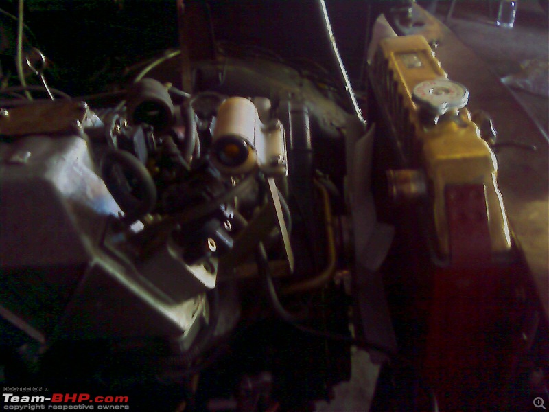

GTO, checked with Lawrence Radiators in Mumbai. He quoted 9 k Rs. for radiator to be shipped to Bangalore. Felt very costly affair presently. Bought a MM 540 Heavy duty at Rs. 3,200 with a warranty of two years in JC Road Bangalore.
Here are new pictures of modifications:
Dwarak

Looking good, radiator seems to be big enough for the engine shouldn't be a problem. Are you planning to redo the front grill/bumper, those look restrictive for the airflow.

Jaggu,
Thanks! Front grill is accommodative enough for radiator and AC condensor, which is already fitted. Airflow is not restricted and taken care .
Dwarak

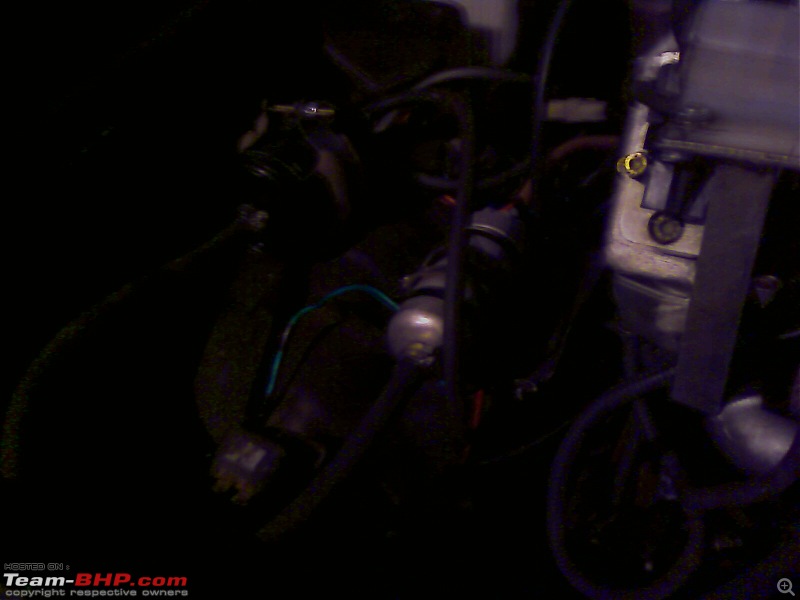

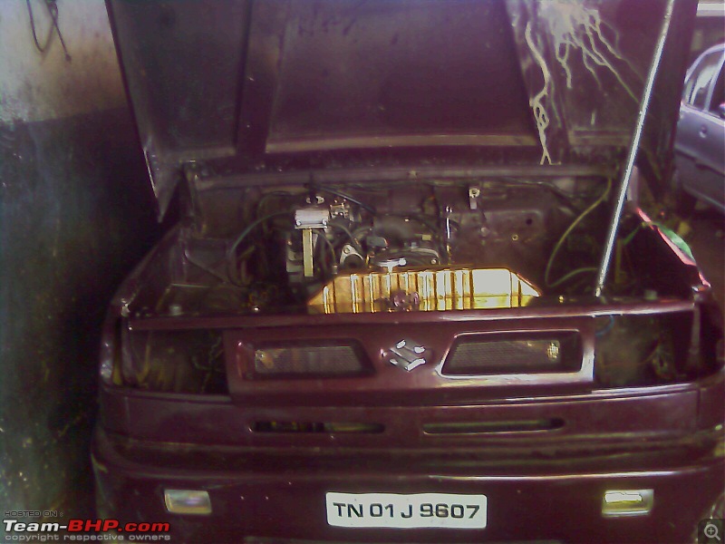

Hi All,
Back from Garage. Here are the progress:
Engine fitted and MPFI connected
Radiator fixed
Condensor for AC fitted
Compressor will be fitted today with custom made bracket
Gearbox mounted and gear shift is perfectly matching the earlier position
Transfer gearbox shifted about 5 inches to the rear and lever comes next to handbrake lever.
Propellor shafts front and back altered for length and new yoke and milling fitted
K&N open filter fitted with extension pipe
Started the engine after fitting MPFI harness. Smooth as cheese. Vibration is very much nil.
After final check up by the mechanical team, will take the Isuzuki for a ride today afternoon, in all probabilities. Need lot of luck.
Things to do yet:
fitting AC blower and fixing the AC line and gas.
Power brake booster , which will be taken up next month
Must say excellent work done by Babu Bhai, Shabbir Bhai and his team.
Here are the pictures:
Dwarak
