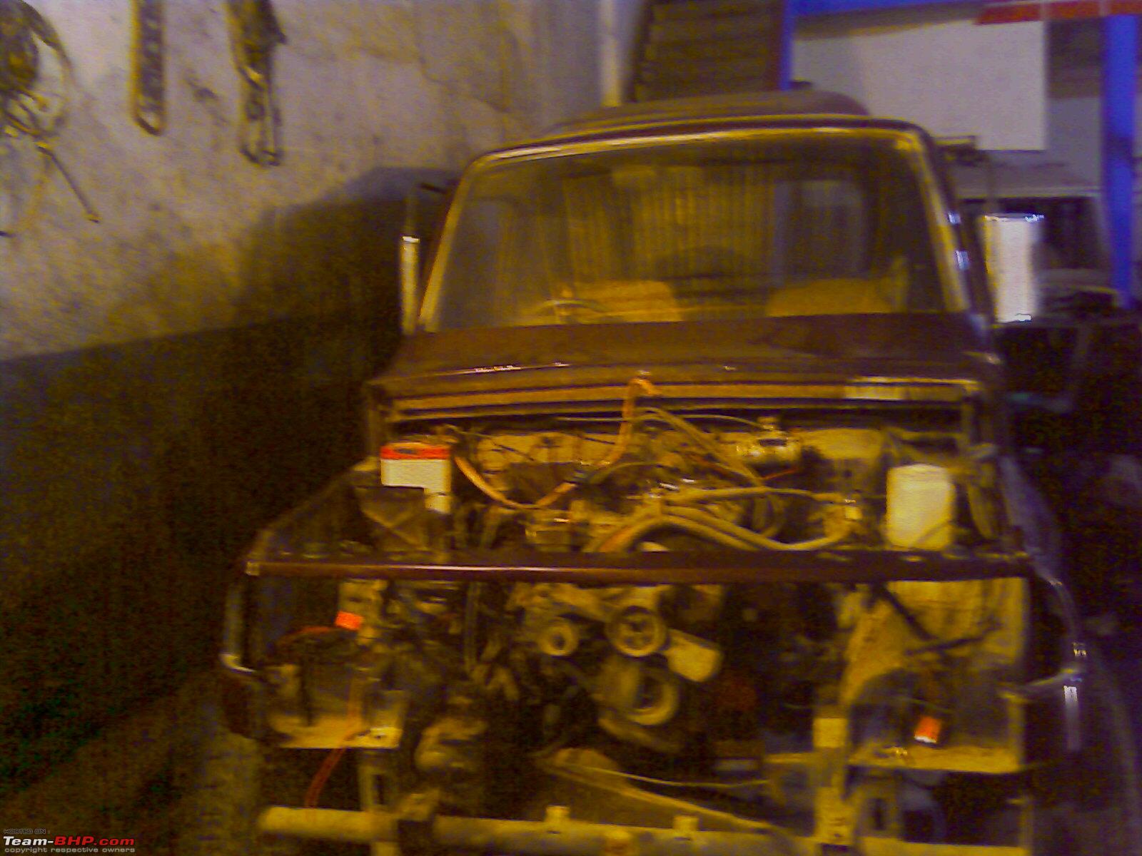

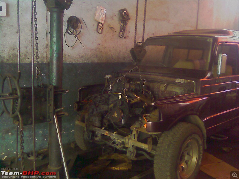

Have engaged Shabbir-Mechanic and expert in engine modifications for the task. Engine and gearbox transplant for my gypsy has already begun. Mods, involved extracting 1000 cc engine , changing the engine bedding fixture, gearbox bedding fixture, alligning the power train, fixing the connecting rods to transfer gearbox, etc. Very time consuming task indeed.
In the bargain, I learnt that the gypsies are easy to modify on power train. Reason being, the transfer gearbox is divorced one and supports mods. Positioning the T-Case (transfer gearbox) changes.
More report to follow.
Dwarak

Suzuki T-case will be retained. connecting rod from gearbox will drive the t-case for 2 WD and 4 WD.
Yes, the overall length of the powertrain is more than MG410 by about a foot from bedding point. Shabbir-Mechanic is fixing the bedding in different places matching the Isuzu. Gear lever and 4 WD lever positioning will change a few inches backwards. Levers will get bent for usual position after the work is completed.
Dwarak
