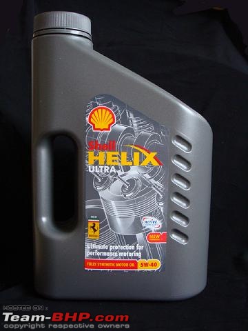

Replaced engine oil with Shell Helix 5w40 to reduce wear n tear of the engine.
