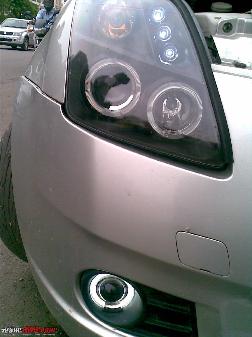

Is it possible to fit a projector lamp for the foglamps in the swift? Without HID's and running higher power halogens with relay, will these be effective? And what would be the reliability since these will be placed low and can possibly be hit by small stones?
It is possible to attach projectors for the fog lamps. See pic.
Auto Lighting thread : Post all queries about automobile lighting here-l8.jpg
Since these are really low to the ground, these will be prone to damages very easily and there will be water seepage. The best bet would be to go for higher rated bulbs on the existing assembly or go for a new assembly. My friends got Volvo headlight unit fixed onto his swift fog lights. It's expensive though.
Thanks Naveen. This is exactly the setup I was looking for. How fragile are these setups? Shouldnt it be possible to seal the bulbs using sealants like anabond and avoid water seepage? How much would such a setup cost (2 projector's with angel eyes)?
Anytime. You can use silicon gel to avoid water seepage but to avoid stones, well am clueless. This is the problem when going for projectors in the fogs. The entire kit (excluding the HIDs) would come around 6k depending upon the brand.
