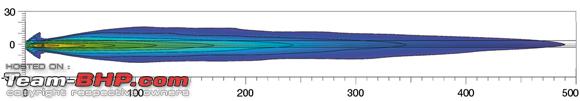

Originally Posted by rm_arjuna (Post 2346971)
I have upgraded my Scorpio Headlamp bulbs with 100/90 Hella bulb , however the low beam is prefect covering around 30-40mts, High beam is okish with average visibility . Now i want to add Aux lamp mounted on a DIY fabricated unibar ( my scorp doesnot sport a bullbar).Have shortlisted Hella 700 FF / Rallye 1000 Black & 3000 . which would be a perfect fit and also can the H1 12v bulb be upgraded to 100w. any user review would be helpful.
I am looking for alteast 100mts of perfect illumination .
Hella Rally series will the best bet for long throw and visibility.
Hella Rally 4000 which is almost the same size of FF 700 but with a better beam throw.
Auto Lighting thread : Post all queries about automobile lighting here-large_1366.jpg Auto Lighting thread : Post all queries about automobile lighting here-1366_dia.jpg
Auto Lighting thread : Post all queries about automobile lighting here-1366isoluxnew.jpg
