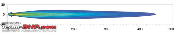

can anyone recommend a pencil beam type unit for high beam thats cheap and as small in size as possible
Best pencil beam you can get from Hella Comet series which starts from 5K onwards. All that depends on your ride and budget.
Hella Comet 200
Auto Lighting thread : Post all queries about automobile lighting here-1313_largenew.jpg
Comet 200 Beam Spread Pattern
Auto Lighting thread : Post all queries about automobile lighting here-1313_isoluxnew.jpg
Hella Comet 300
Auto Lighting thread : Post all queries about automobile lighting here-large_1314.jpg
Auto Lighting thread : Post all queries about automobile lighting here-1314_isoluxnew.jpg
Hella Comet 450
Auto Lighting thread : Post all queries about automobile lighting here-1310_isoluxnew.jpg
Hella Comet 550
Name:  H Comet 550.jpg
Auto Lighting thread : Post all queries about automobile lighting here-h-comet-550-beam-spread.jpg
