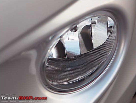

I wanted to upgrade the fog lamps in my i20 to something which is much brighter and has a lil' whitish shade!
Current bulbs are equivalent to 2 lanterns on the front bumper lol :D
It currently H27 Halogen lamps!
What are my options starting from a simple bulb change to a projector setup in there?
Here's a illustration of i20's fog lamp
(Took the pic from google image search! this is not my car. Credits to the original photographer)

Projector setup is possible but need proper installation. Needs to be water proof. Another option is to fit Volvo headlight units.These fit perfectly onto Swift. My friend got that installed with Philips 80/90w. They will come around 7k approx. Go for 6000k bulbs for white output but please remember visibility decreases as the color temp goes up.
All the "Visions" from Philips are more of bling bling effect rather than more usable light on the road !
Best option - switch to HID's - worth every rupee spent !
I almost completed 2 years & 17,000 kms on my HID upgrade on my Swift & boy, was it worth it ! It has made my outings on the lunar landscape roads of Blore so much more safer !
That too, running on the stock reflectors :) Little scattering but nothing to worry.
Suhail - Philips has different versions of Crystal vision bulbs which emits a whitish light ! I have a pair in my Swift fogs. It is the same H type as the original but 55W compared to the stock 35W. Check on the Philips website for authorised distributors in Delhi & contact them ! You can call the company reps too.

Biggest hassle is, to access the fog lamps I'll have to dismount the bumper which requires quite a bit of hand dirtying and stuff! :(
Thanks Nirmal, I know a guy selling philips H27 bulbs, will check with him!
