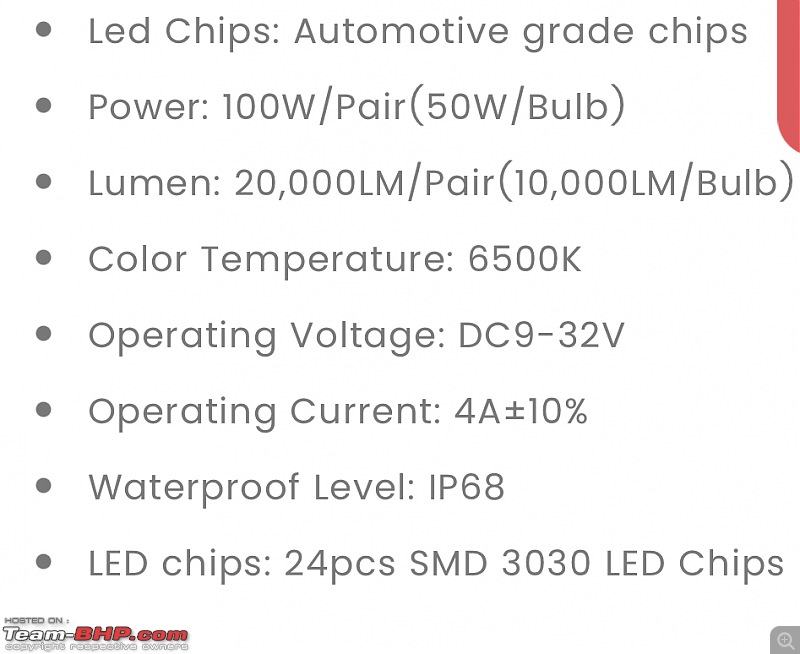

Hello !
I’ve ordered Novsight N52 Series 9005 HB3 LEDs directly from the brand. I believe the package will be shipped from China and would take 15-20 days to arrive.
Specs are as below-
Auto Lighting thread : Post all queries about automobile lighting here-7d7b853dbf794a00b44194339f3b8fc4.jpeg
Auto Lighting thread : Post all queries about automobile lighting here-3b59d80939e2462e8ab42cff5a287329.jpeg
As @Behemoth explained earlier, Lumen rating might be inflated and real world figure would be around 14000 Lumens/Pair.
