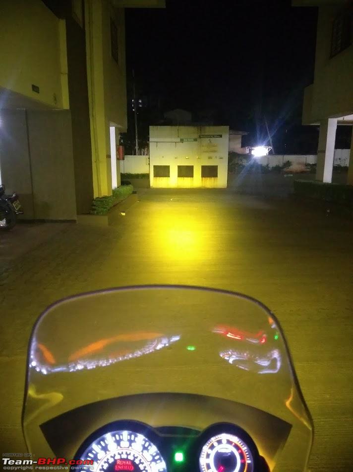

So I did consider your advise and have installed 2 (3Wx6LED) on the bike, the net expense was INR 1500 clap: and must say am very very satisfied with the output.
With only the LEDs switched on, as you can see the area where I have clicked this picture is not really dark as such, but still the illumination stands out by itself. Along with the stock lights this has pretty much solved the issue.
Auto Lighting thread : Post all queries about automobile lighting here-led-lights-1.jpg
Position and placement of the LEDs (one on each side)
Auto Lighting thread : Post all queries about automobile lighting here-led-lights-2.jpg
These are operated via a separate switch and it really helps in teaching pesky High Beam lovers to give some respect to other travelers.

Where are the LED's installed?
The LEDs are installed to the left and right side of the headlight by way of clamps, you can refer to the second pic in my last post for reference.
Thanks for pointing that out. It was hidden in plain sight.
I was also planning to install a LED projector in my Scooty Zest 110. Seeing your setup, I wonder if just having a LED bar would suffice.

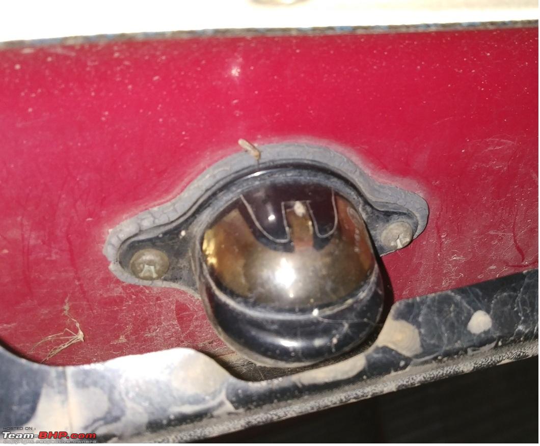

Every time I used to follow a TATA Zest during night time, I used to ogle at the rear number plates which were illuminated by white LED bulbs. Recently one of my friends sent me a link for some LED bulbs which could be used as a plug & play replacement for number plate lights. I ordered 2 of them (each contained 2 bulbs) to fit in our Ecosport & Zen. Here is the link: http://www.amazon.in/Osram-Retrofit-...-02B0+LED+bulb
I fitted the bulbs as a DIY, strangely this time the Ford was easier to work on than the Maruti. The number plate lights in the Ecosport are locked in placed by a simpler push type locking mechanism, while the Zen's number plate lights have a screw type arrangement.
The replacement bulbs were plug & play in both the cars, one thing to look out for is the correct polarity. So, I would recommend you guys to check if the bulb glows or not before fitting the holder back in place. If the bulb doesn't glow, one should fit the bulb the other way round in the holder (for the correct polarity). Also if your car has an advanced CANBUS system (e.g Fiat Punto) which detects a blown bulb, then fitting the LED bulbs might force the MID to show an error.
The results during night time are good, it seems that the 860 rupees spent was worth it. The coolness of both the cars have increased considerably. Even the brightness of the LED's are spot on, not too bright as I had feared earlier.
A close look at the Ecosport's number plate light:
Auto Lighting thread : Post all queries about automobile lighting here-ecosport-light-1.jpg
Auto Lighting thread : Post all queries about automobile lighting here-ecosport-light-2.jpg

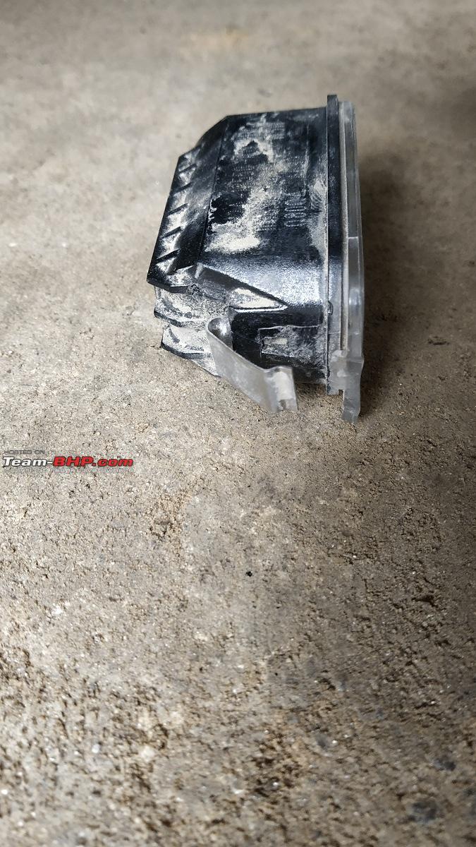

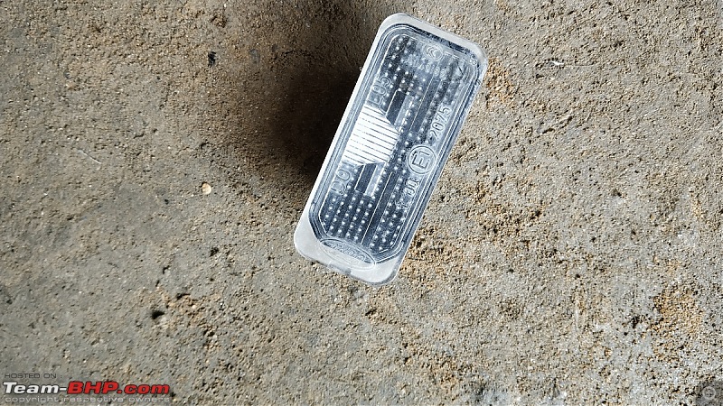

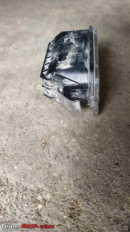

The Zen's bulb has a screw type mechanism:
Auto Lighting thread : Post all queries about automobile lighting here-untitled.jpg
Note: The above photo is from the Omni, the Zen also has the exact same arrangement.

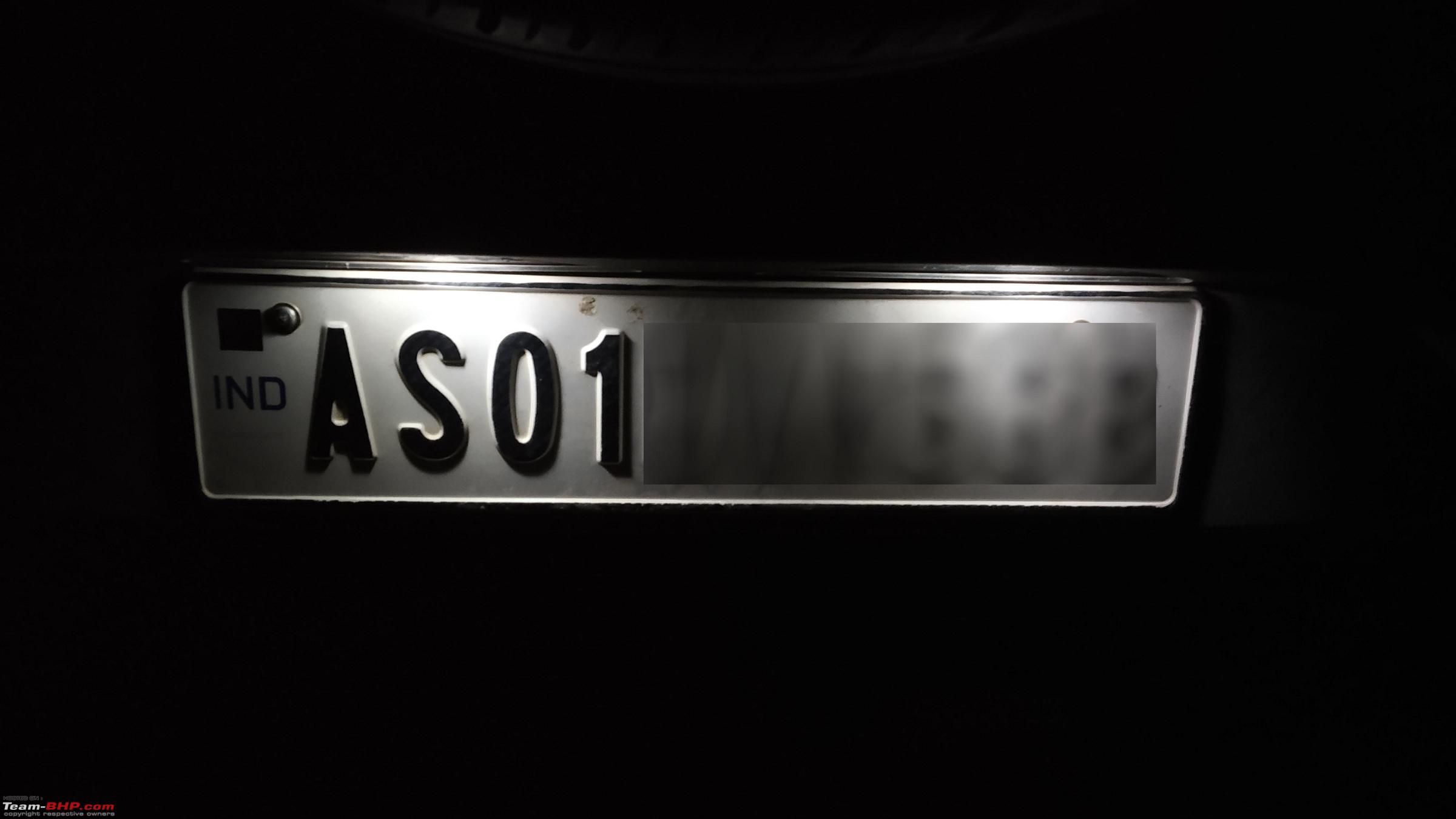

Zen's number plate at night:
Auto Lighting thread : Post all queries about automobile lighting here-zen-number-plate.jpg

Fantastic work sir. I love the way the white LED's impart a clean look over the stock yellow bulbs.
