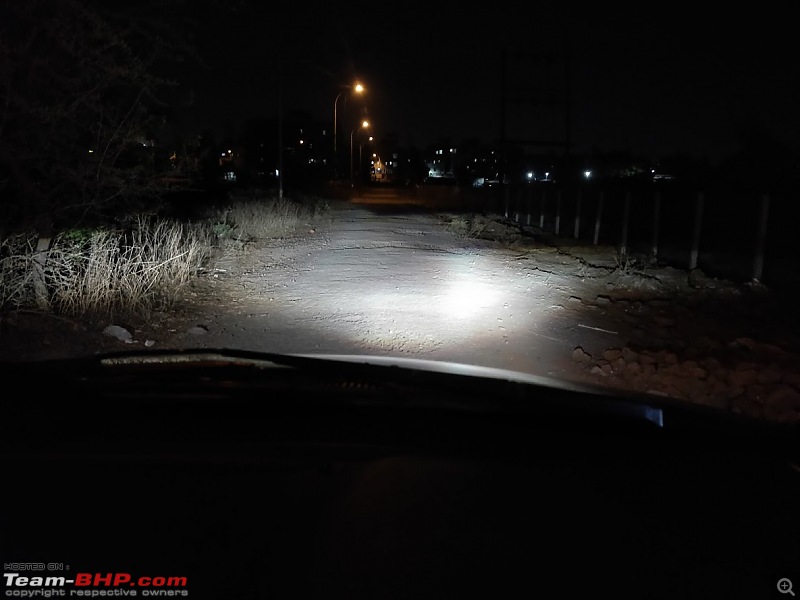

Here you go. Couldn't really find a place with total darkness but guess this is good enough to see the difference.
With only low beam projectors on
Auto Lighting thread : Post all queries about automobile lighting here-aria-low-beam.jpg
Low Beam plus High beam. You can see the difference and it is more evident to the naked eye as compared to the photo

Though you have got a near ideal setup, there are two observations:
1. The RH projector is not aligned properly, it seems to be pointing downwards.
2. Consider changing to quick start ballasts, especially for the high beam. The greenish initial state will go and the light will come to life almost instantly. In your case, it seems to take a long time to stabilize the actual 4200K output.

Thank you Audioholic, the HIDs have really helped in upgrading the illumination quotient.
The kit is original, both the low and the high beams were bought from a reputed dealer.
Regarding
1. Yes, that hotspot is something which I want to have aligned, not getting the time to visit the service center. Is this something I can do by myself?
