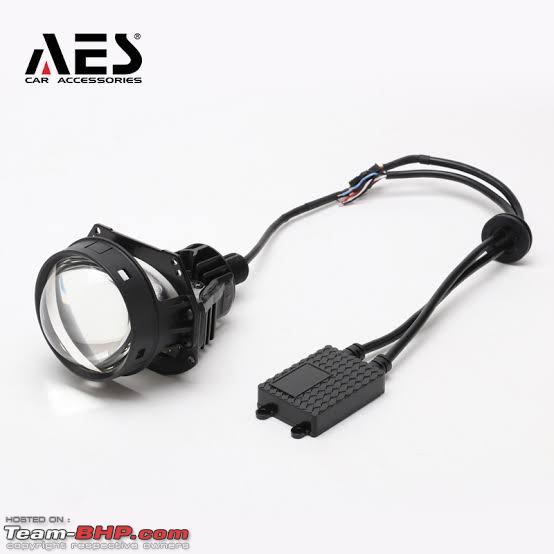

My Bi-LEDs are AES A8 projectors.

I installed the projectors, but I am having hard time aligning them. Cut off line in both projectors are slanted. Did you have any such trouble?
The H4 socket is slightly rotated in the halogen headlights in india. You have to fix by having it installed straight. Options are:
1. Modify the H4 locking part that goes from the bulb replacement side.
2. Fix projector using 4 nuts drilled through the reflector.
