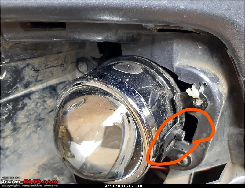

Please see the throw of the fog lamps in the bumper of SX4 from position similar to that of Figo. Also, please refer to the two pics where I have marked the screw which can be used to aim your fog projector either higher or lower as per your requirement - Pic credits - BHP-ians - chiranjitp & audioholic
Auto Lighting thread : Post all queries about automobile lighting here-3679ef6e5ca44fa4a9eefdd839c6f7a9.jpeg
Auto Lighting thread : Post all queries about automobile lighting here-final-fitting_li.jpg
Auto Lighting thread : Post all queries about automobile lighting here-l-n-key-adjustment_li.jpg
35w HIDs will not be as intense as 55w HID kit; but will have far higher brightness than halogen bulbs. Also, they will have better life span than 55w HID kits. So, in the end; the trade-off is with respect to life vs. performance. You can take a call accordingly.
