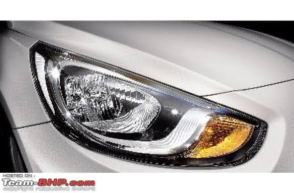

So you have this..
Auto Lighting thread : Post all queries about automobile lighting here-1359d120ac0e41a996b1d51fe389a94b.jpeg

The answer is an obvious no. Unless you’re talking about the actual projector lens, in which case you’re better off installing aftermarket ones, say Morimoto etc.
A better solution would be to swap out your existing headlights for those on the updated Verna (NOT the facelifted 2015 4S).

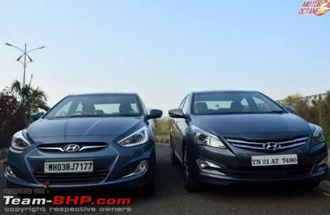

Auto Lighting thread : Post all queries about automobile lighting here-756720e7a0b244f8a97b0452a0cb1f4e.jpeg
Auto Lighting thread : Post all queries about automobile lighting here-14ebaf2e7ff049948cfbe2e33e80ebbb.jpeg
The car on the left is the one you’re taking the headlights from; the other is the facelifted 4S.

No, I was wondering about the actual headlights. Can they be interchanged with the 2019 ones. The wiring can be spliced and connected somehow.
TheHelix has said No as it's pretty obvious from the pictures.
Thank you so much for the pictures. It's pretty clear that they can't be interchanged.

The car on the left isn’t the 4S (that’s the one on the right), but an updated version of your model of the Verna. Its headlights would be a direct fit. The 4S is different, as you could see from the pic.
