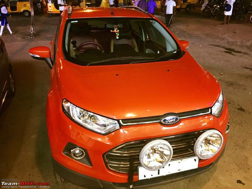

As a first; within a few months of buying the car – I tried to use Hella Rallye 3003 with 100w Philips Rallye Bulbs. The light output was phenomenal and I really liked it. But my service advisor at Ford warned me that taking a massive 17-18A load straight from the battery would possibly cause issues in the car's BCM and if some electrical issue were to crop up; they would outright deny my car's electrical warranty. So, I had it removed within 2 weeks of install. But the highway drive with those lights at night was awesome during the 2 back to back trips and I was hoping to see some proper upgrade to my car’s light output without creating a major fuss with the extremely supportive Ford Dealer.
See the photo of the car fitted with Hella Rallye 3003 below.
Auto Lighting thread : Post all queries about automobile lighting here-ecosport-hella-rallye-3003.jpg

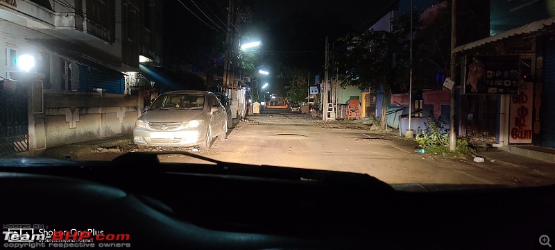

The results speak for themselves in the photos taken below:
IN A NARROW POORLY LIT STREET

Fog Lamp Low Beam + Headlamp Low Beam – This is the most widely used light mode for my driving (100% in city and when there is oncoming traffic on the highway)
Auto Lighting thread : Post all queries about automobile lighting here-dark-road-fog-low-main-low.jpg

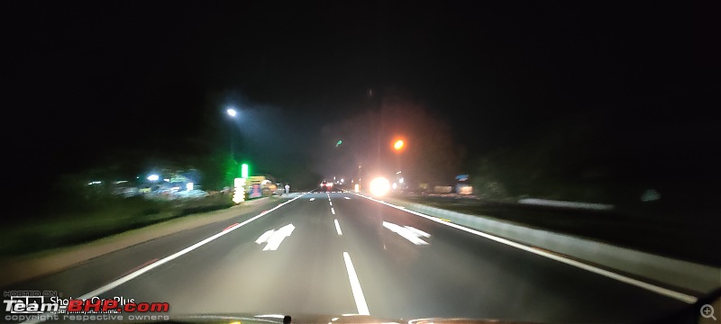

OUT ON THE OPEN HIGHWAY
Auto Lighting thread : Post all queries about automobile lighting here-img_20191206_200730.jpg
Auto Lighting thread : Post all queries about automobile lighting here-img_20191206_200735.jpg
Auto Lighting thread : Post all queries about automobile lighting here-img_20191206_213820.jpg
Auto Lighting thread : Post all queries about automobile lighting here-img_20191206_213823.jpg
Attachment 1964598
Cheers & Safe Driving
