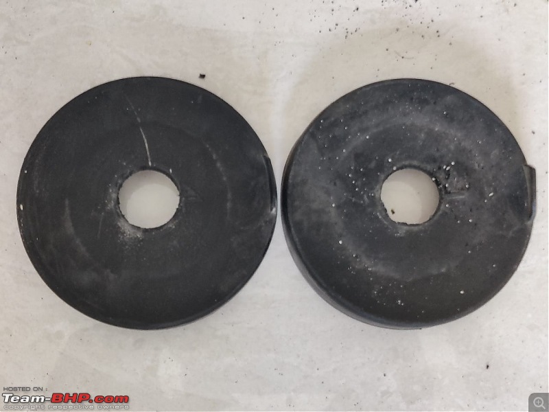

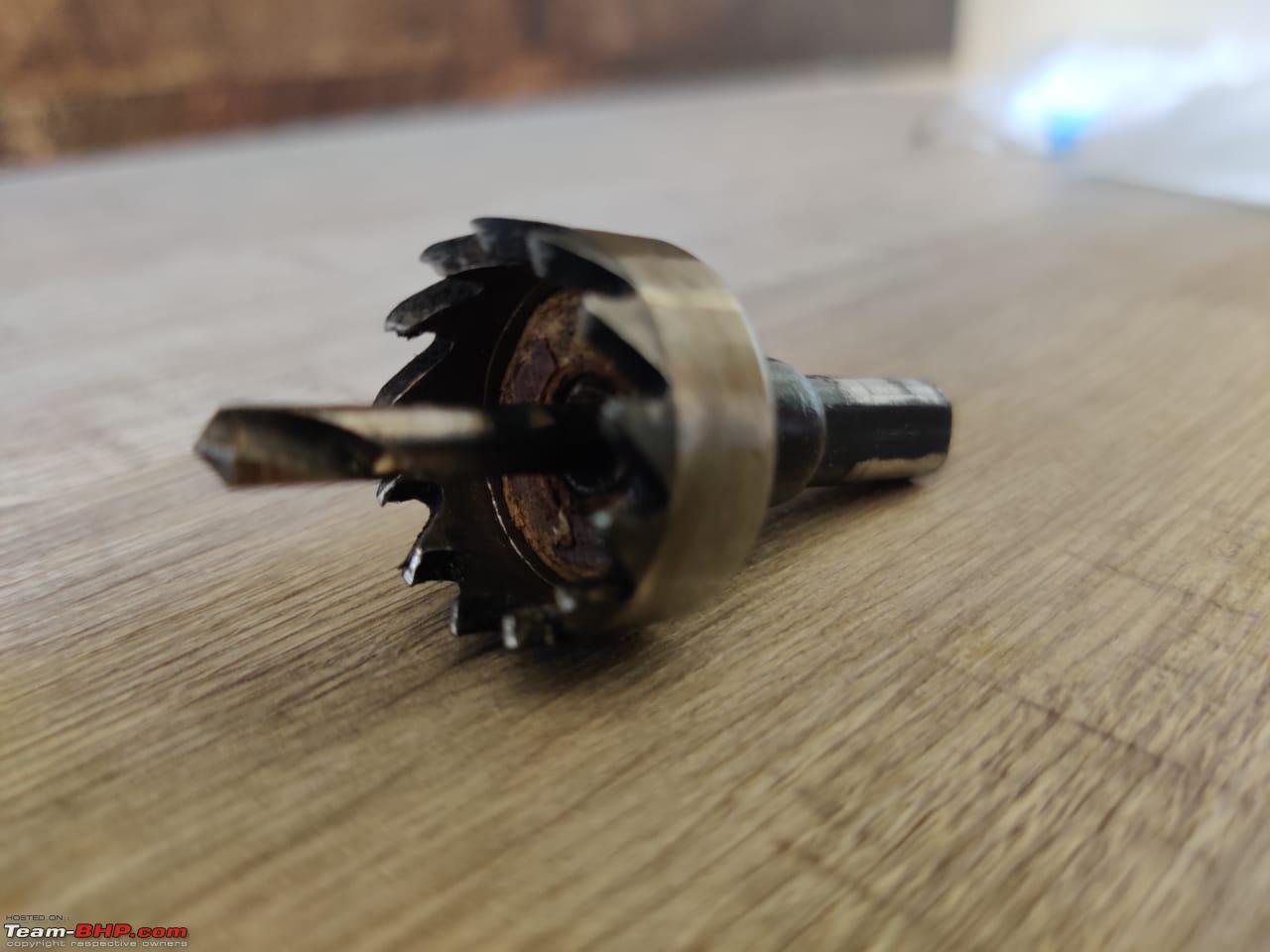

Installed OSRAM HID conversion for Maruti Suzuki Vitara Brezza:
The experience from the Ciaz installation was excellent for the money spent. It was no brainer that for Brezza too, which runs on the same set-up for low beams, this would be a sensible upgrade without a fuss. Did that for a friend this morning and here are some work in progress pics along with the final output.
a. Drill bit for making a hole on the dust cap
Auto Lighting thread : Post all queries about automobile lighting here-01-bit.jpg
b. Brezza's dust cap are of rubber unlike Ciaz that uses plastic
Auto Lighting thread : Post all queries about automobile lighting here-02-dust-cap-before.jpg

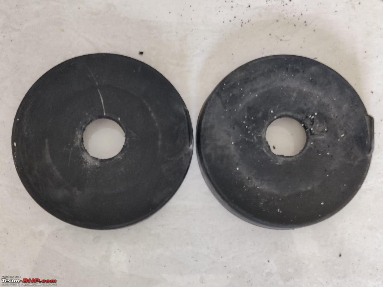

c. Drilling in progress
Auto Lighting thread : Post all queries about automobile lighting here-03-dust-cap-hole.jpg
d. Both the dust caps ready to pass the couplers through them
Auto Lighting thread : Post all queries about automobile lighting here-04-dust-cap-after.jpg
e. After passing the couplers, and securing the hole with Orsam provided caps
Auto Lighting thread : Post all queries about automobile lighting here-05-cables-through-dust-cap.jpg
f. Ensures no dust or moisture enters through this set-up
Auto Lighting thread : Post all queries about automobile lighting here-06-cables-through-both-dust-caps.jpg

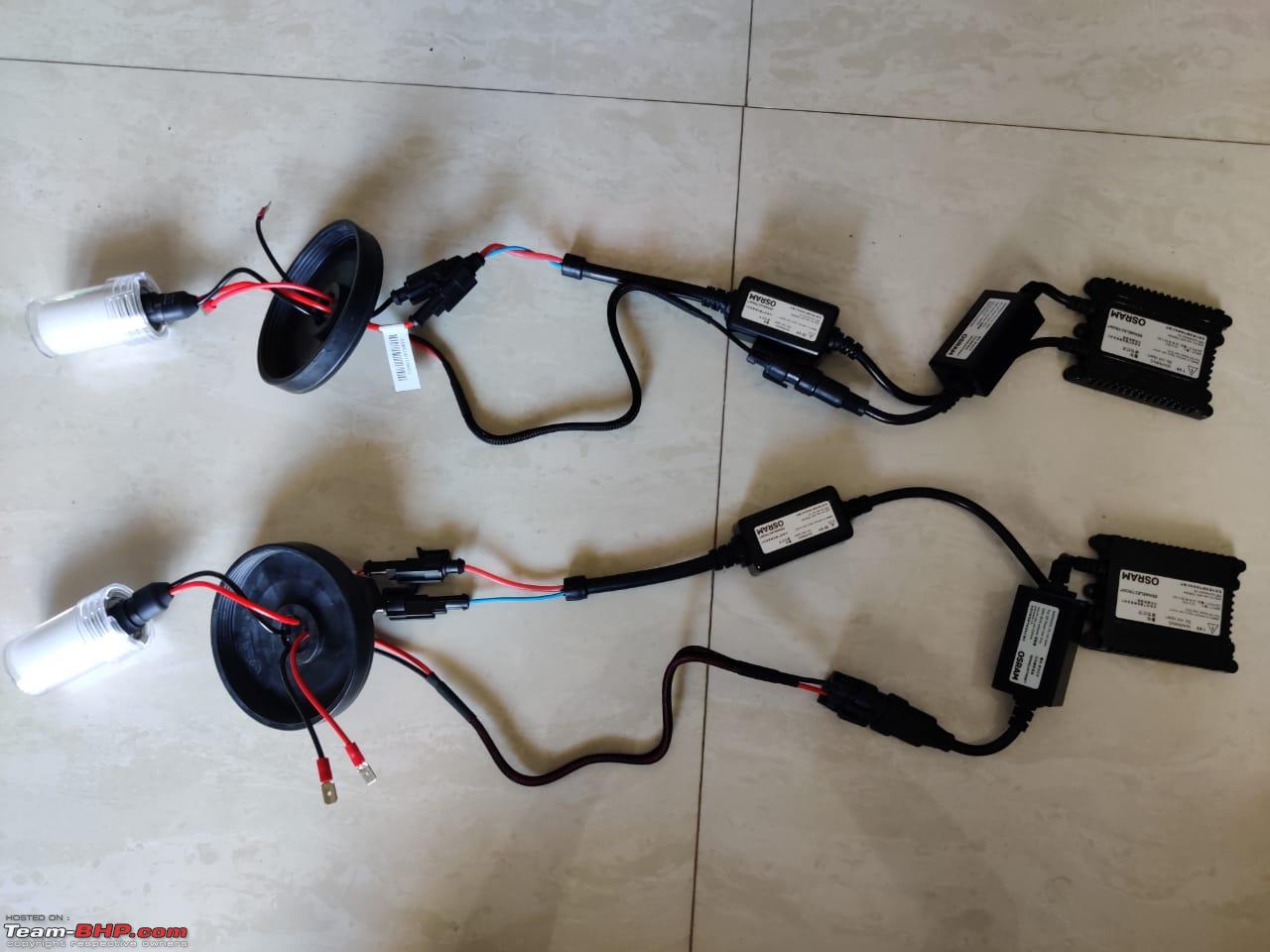

g. Harness ready for installation (simple plug and play)
Auto Lighting thread : Post all queries about automobile lighting here-07-complete-harness.jpg
h. Right hand side
Auto Lighting thread : Post all queries about automobile lighting here-08-rhs-hid.jpg
i. Left hand side
Auto Lighting thread : Post all queries about automobile lighting here-09-rhs-hid.jpg
j. The OE coupler from each bulb is pulled used to power up the harness
Auto Lighting thread : Post all queries about automobile lighting here-10-power-connection.jpg

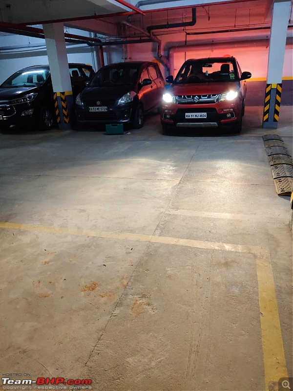

k. Beam when looked from front
Auto Lighting thread : Post all queries about automobile lighting here-12-beam-front-2.jpg
l. Another one from the front
Auto Lighting thread : Post all queries about automobile lighting here-11-beam-front.jpg
m. When it lights up the near dark path
Auto Lighting thread : Post all queries about automobile lighting here-12-beam-path.jpg
n. Cut-off when parked in front of the wall
Auto Lighting thread : Post all queries about automobile lighting here-13-beam-cut-off.jpg
