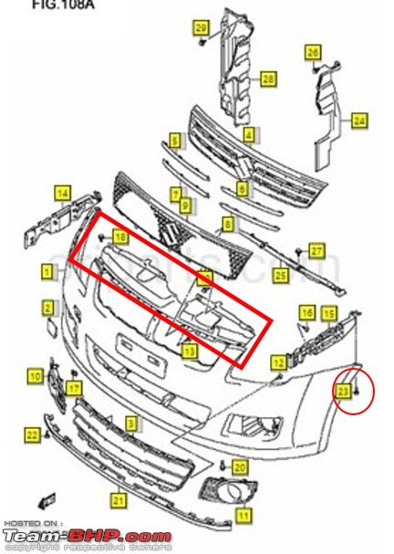

This hopefully should help some of you who have older Maruti's that use this foglight (A lot of them do) and who want better illumination without blinding the guy on the opposite side of the road, or like Bangalore driving on the same side as you.
This DIY started out as an exercise to clean and adjust my 15 year old OE fogs since I was blind driving in the dark even with 4300K HID's in the fogs (yeah, Bangalore is that bad).
The first step was to get the bumper off and thanks to Boodmo's OE catalogue figured out the location of the Screws, Clips, and Bolts. I didn't want to remove the whole bumper as I had no idea how easy or tough it was going to be to put it back, so I started out removing stuff from one side and under the hood and voila managed to pull the bumper and create enough space to reach the fogs. The stock fog assembly is held in place with 3 Phillip's screws which was easy peasy to remove. The inside of the projectors had a fine film of dust which I first cleaned with a brush followed by a solution of diluted IPA. Feeling very pleased with myself I fitted back the first fog and repeated the steps on the other fog. Now to adjust these stupid fogs one needs to have a really long star screwdriver which goes through a tiny hole in the bottom of the bumper and if you have the luck of the Irish find the adjustment screw. It was only after swearing for a good 15 minutes that I figured out a much simpler way. The fogs are covered with a black trim piece from the front that pops out if you lever it from one side exposing a lather large hole from which one can either use a stubby screwdriver or use ones fingers as a guide to for the long screwdriver to work from below. Long story short, I managed to adjust my fogs to the point where I could see clearly but when I stepped out and looked at my car I was completely blinded by the overpowering fogs (sorry, forgot to take a pic).
Stupid me then realized I had a spare set of Sinolyn Projectors that I had bought for my Linea, never used and stored away that I could maybe use if the supplied bracket matched the mounting holes in the bumper. So out came the Sinolyns, out came the bumper (again) and out came one fog assembly to check if the bracket would work. Superimposing the metal bracket on the OE foglight was a thank God moment, it was going to mount without any 'juggad'.
Once I knew that the bracket would fit adrenalin managed to get both projector fogs installed and aligned in 30 mins.
Tips:
1. Assemble the Bracket and Projector Fog assembly outside and then install. The Bracket I had could be fitted in a few ways so I checked which one suited my mounting points best and had the end of the projector sitting outside the external plastic trim for easy adjustment and also it looked better this way.
2. You will need to shave off two tabs on the bumper that slide into the OE fog. I did that with a heated blade cutter and made sure the bracket would sit on a smooth surface
3. I tightened the screws between projector and bracket fully but made sure that it had enough 'give' to be adjusted from outside with my hand.
I will now let the pics do the talking.
Auto Lighting thread : Post all queries about automobile lighting here-oefog-35500m75j11.jpg
This is the standard fog that is used in several Marutis
Part # 35500M75J11 (Boodmo)
Auto Lighting thread : Post all queries about automobile lighting here-boodmobumper.jpg
Screws, Bolts and clips that need to be removed to remove the bumper. Also need to remove 4 clips that hold the fender liner in place (Credit : Boodmo)
