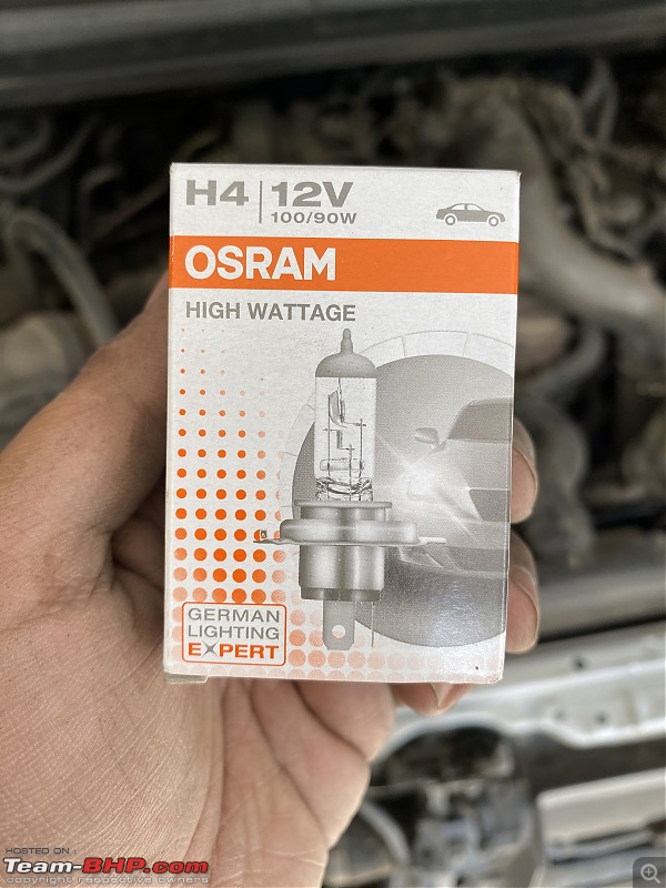

So, the only option left was to buy a pair of higher wattage bulbs and a relay wire harness (completely plug and play).
Many years ago, I had upgraded my RE thunderbird to Osram all season bulbs and it’s been running fine so far. It emits a slightly green light and makes a significant improvement even with OEM wattage. However, for cars this bulb was not available at 55/60 rating and was only available in 90/100 and I was fine with this. Everything was available on amazon, but for my patience.
So, I dropped by to my neighbourhood spares shop to try my luck. The Osram green bulbs were not available, so I settled with regular 90/100 H4 bulbs. Saw relay wire harness from Phillips and Super. Both looked and felt same so went with Super Auto as it was 250 rupees less.
Bulbs costed 100 bucks each and the wire harness was 750.

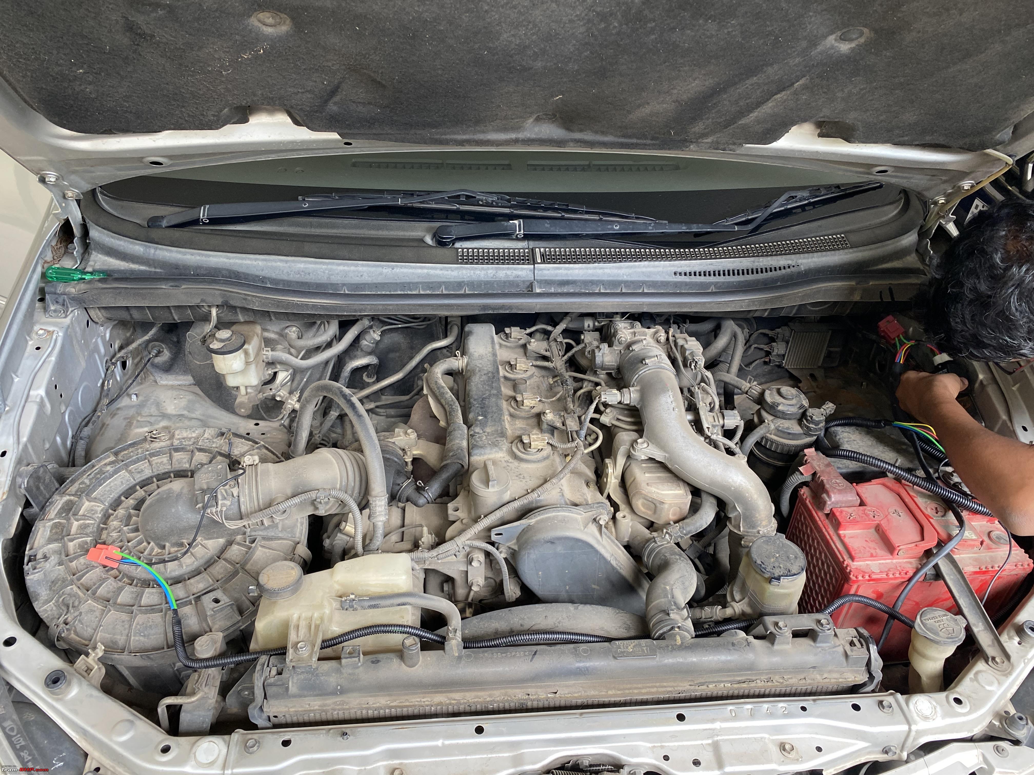

Called up my friend and booked him for a Sunday morning DIY session and he happily agreed.
I first laid out the wire in the encopa and planned where to fit the relay box and how to route the wire. I found that running the wire on the radiator shroud was much better that any other location near the engine.
To access the bulbs, our fat hands could not sneak in the gaps between the headlamp and airfilter box on the left nor between the battery on the right and we realised we had to either.
1. Remove the battery and the air filter box and avoid removing the headlamp.
2. Remove the bumper and the headlamp and avoid touching the battery and the air filter.
We chose option 2 in order to avoid messing with functional parts.

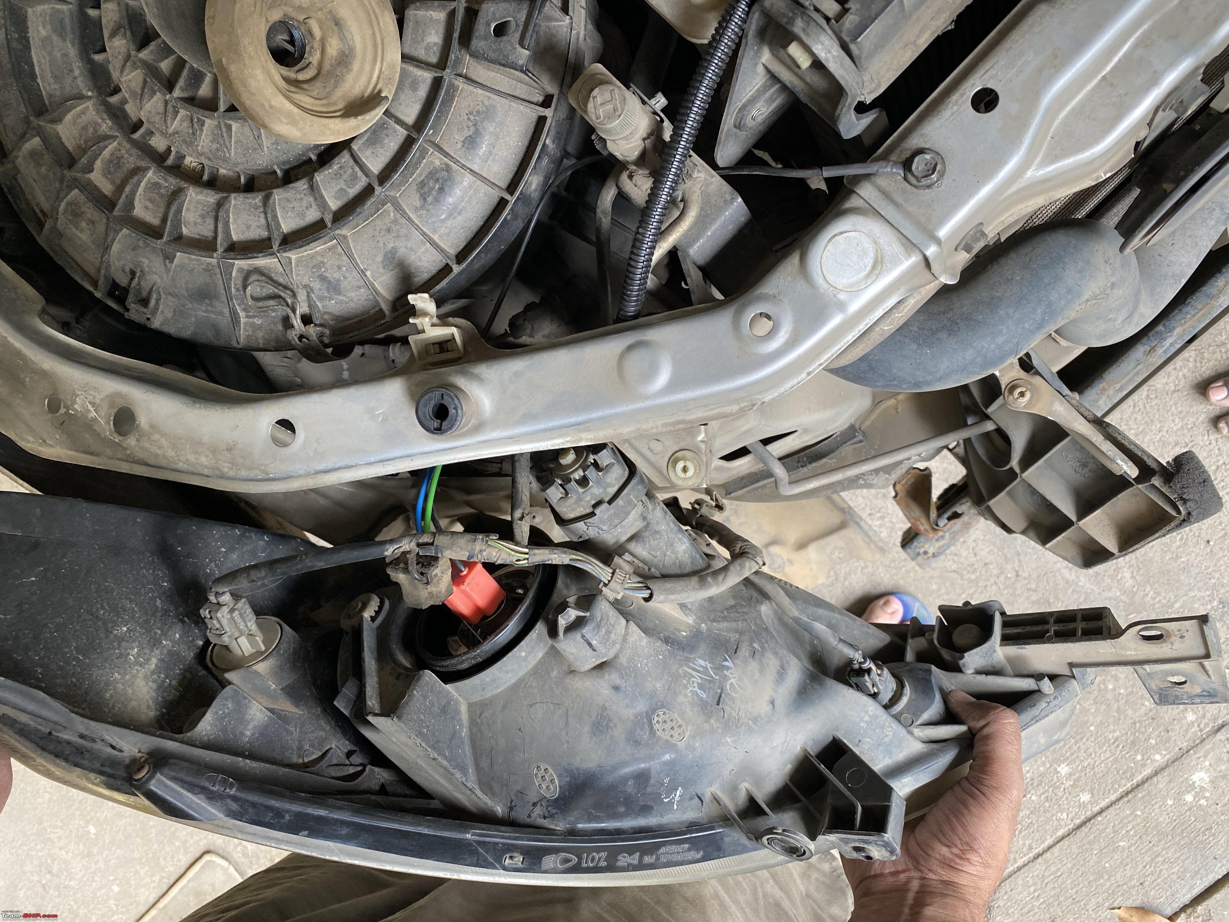

All screws, clips and bolts were quickly removed, and the headlamp came out of its housing.
We made sure if we can remove the bulbs easily and if the new ones fit properly and then proceeded to wire the new harness. This was fairly simple, and we started from the headlamp end and ended with connecting the positive terminal to the battery. Steps as below.
1. Unplug the OEM plugs and plug in the new holders to the bulbs.
2. Connect the right OEM holder to the signal plug of the new wire (the RH OEM holder is left dangling uselessly forever)
3. Find two negative ground bolts and tighten LH and RH black wires to them.

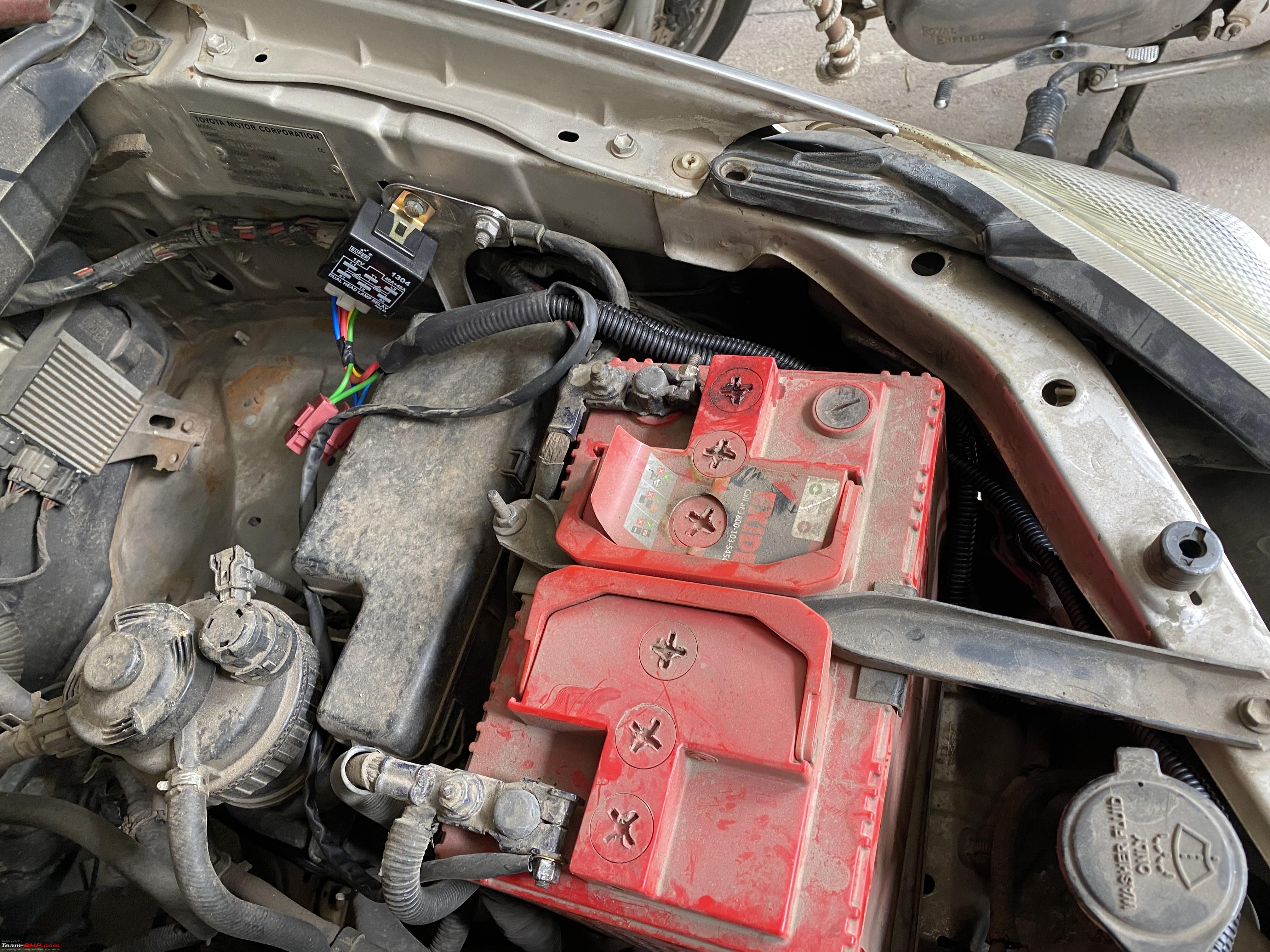

4. Find a place to mount the relay box and tighten it.

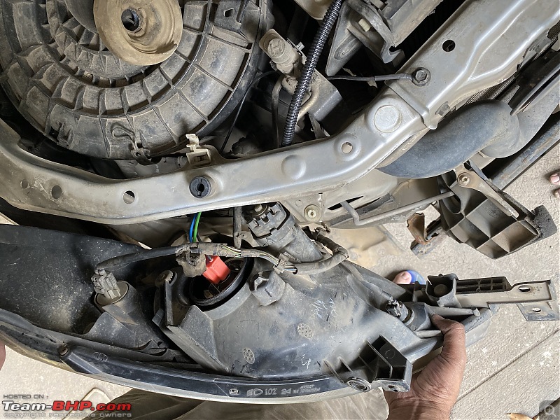

Final LH side
Auto Lighting thread : Post all queries about automobile lighting here-4.-final-lh-side.jpg
RH side. Notice the now dummy OEM holder right next to the new pink bulb holder
Auto Lighting thread : Post all queries about automobile lighting here-6.-rh-dangling.jpg
Final look of the encopa. The negative ground wires are in front of the left and right edges of the radiator.
Auto Lighting thread : Post all queries about automobile lighting here-8.-after-cable-tie.jpg
The new bulbs
Auto Lighting thread : Post all queries about automobile lighting here-9.-new-bulb.jpg

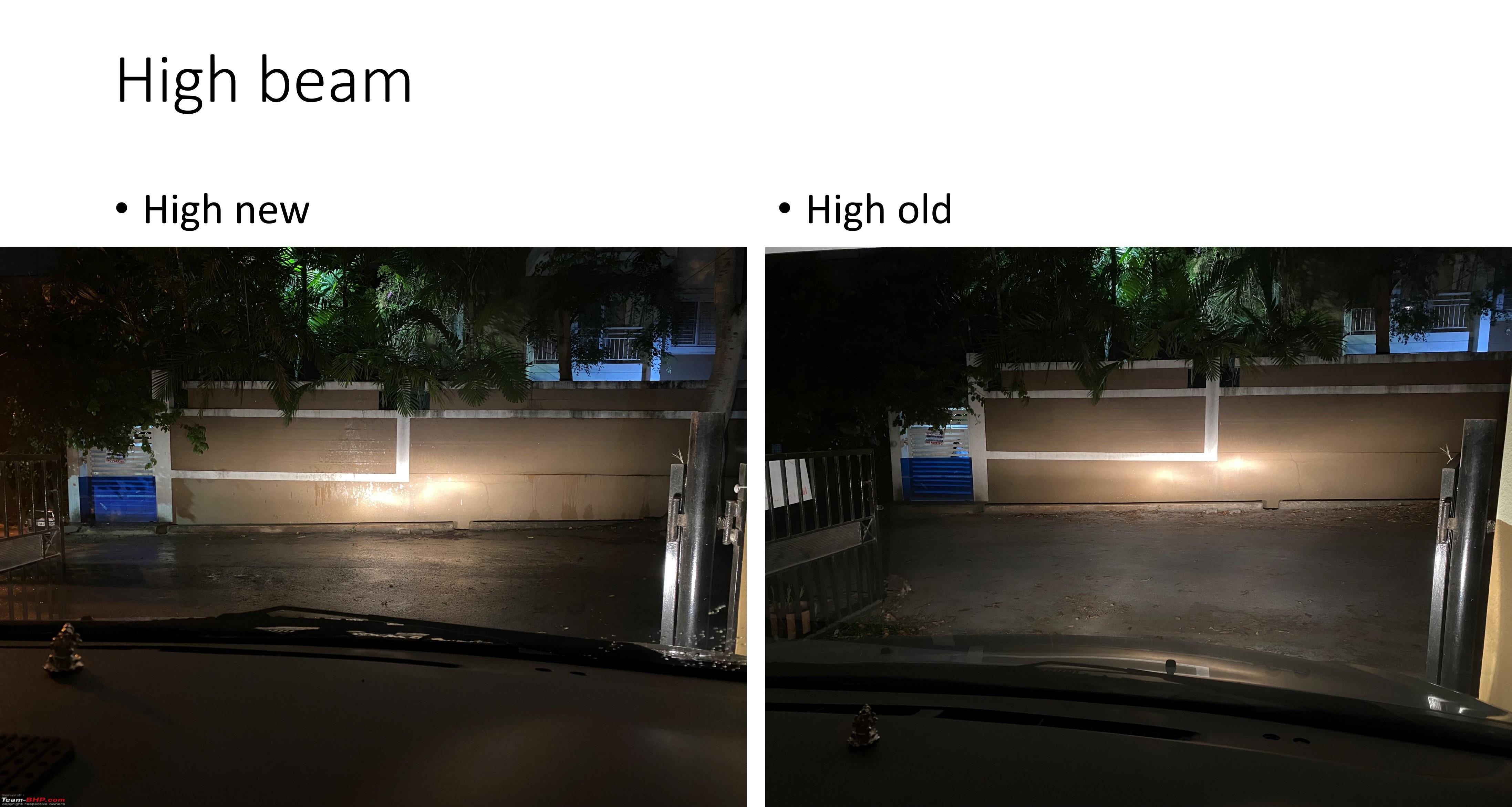

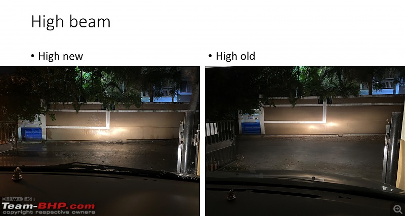

Here are the comparison images of the headlamp upgrade.
Auto Lighting thread : Post all queries about automobile lighting here-high-beam.jpg
Auto Lighting thread : Post all queries about automobile lighting here-low-beam.jpg
Misaligned - Move the headlamp lever to 0, bring the left headlamp up with a screw driver so that their horizontal cut off lines match with the right. Now you should be all set.
