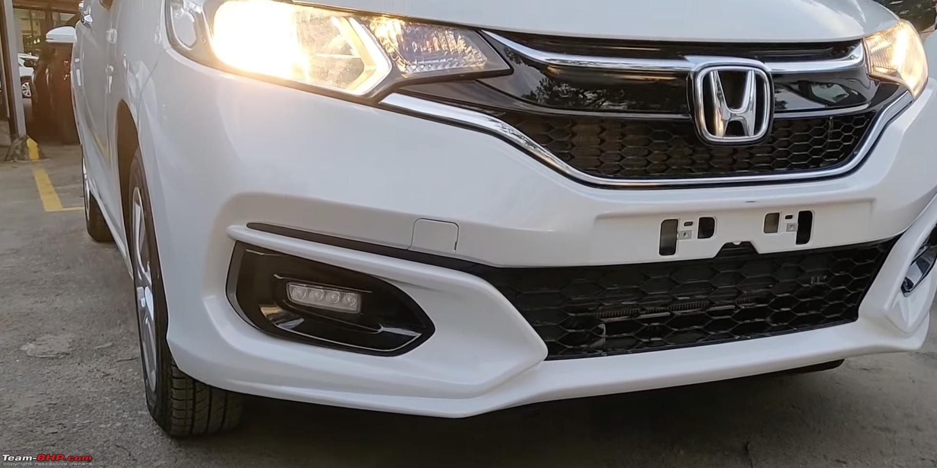

Wow this is an amazing thread. I am planning to install new fog lights for my Jazz V BS6 model. This is how it currently looks.
Auto Lighting thread : Post all queries about automobile lighting here-screenshot-20240329-12.08.568239pm.png
Auto Lighting thread : Post all queries about automobile lighting here-screenshot-20240329-12.18.578239pm.png
The issue is that there are no fog lights or separate slots for fog lights either. These are plain DRLs which switch off once the headlight is turned on. I had the below questions:
-Can someone suggest if I can get fog lights installed in the same slot?
-Is there some model available that can function both as a fog light and DRL?
-How would the wiring work in that case? Will it void the warranty?
- Any other idea that anyone has here is welcome

Wow! I loved this idea. But the question I have is where do I place them in given Jazz's front layout. Here's a full picture of the front face.
Auto Lighting thread : Post all queries about automobile lighting here-screenshot-20240331-12.30.398239pm.png
I have a couple of more questions.
-Are the HJG Future Eye 4 fog lights legal?
-Can they be placed without any cuts on the grille or bumper?
-Also, being based out of Bangalore, I was looking for some suggestions about some reliable place/s to buy and install these lights in Bangalore

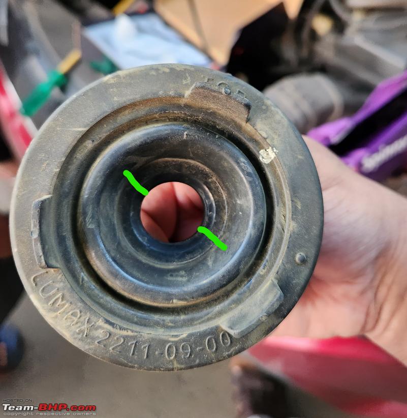

Auto Lighting thread : Post all queries about automobile lighting here-bootcut.png
Yes, they did cut the rubber boot a bit during installation. And yes, the fan is covered by the boot flap on the sides (with a little bit of open area thanks to the cuts in the sides, check the green highlight in the image) but the rear portion of the fan is mostly open. It would definitely reduce the effectiveness of the cooling, but I am not sure if and how it affects the bulbs.

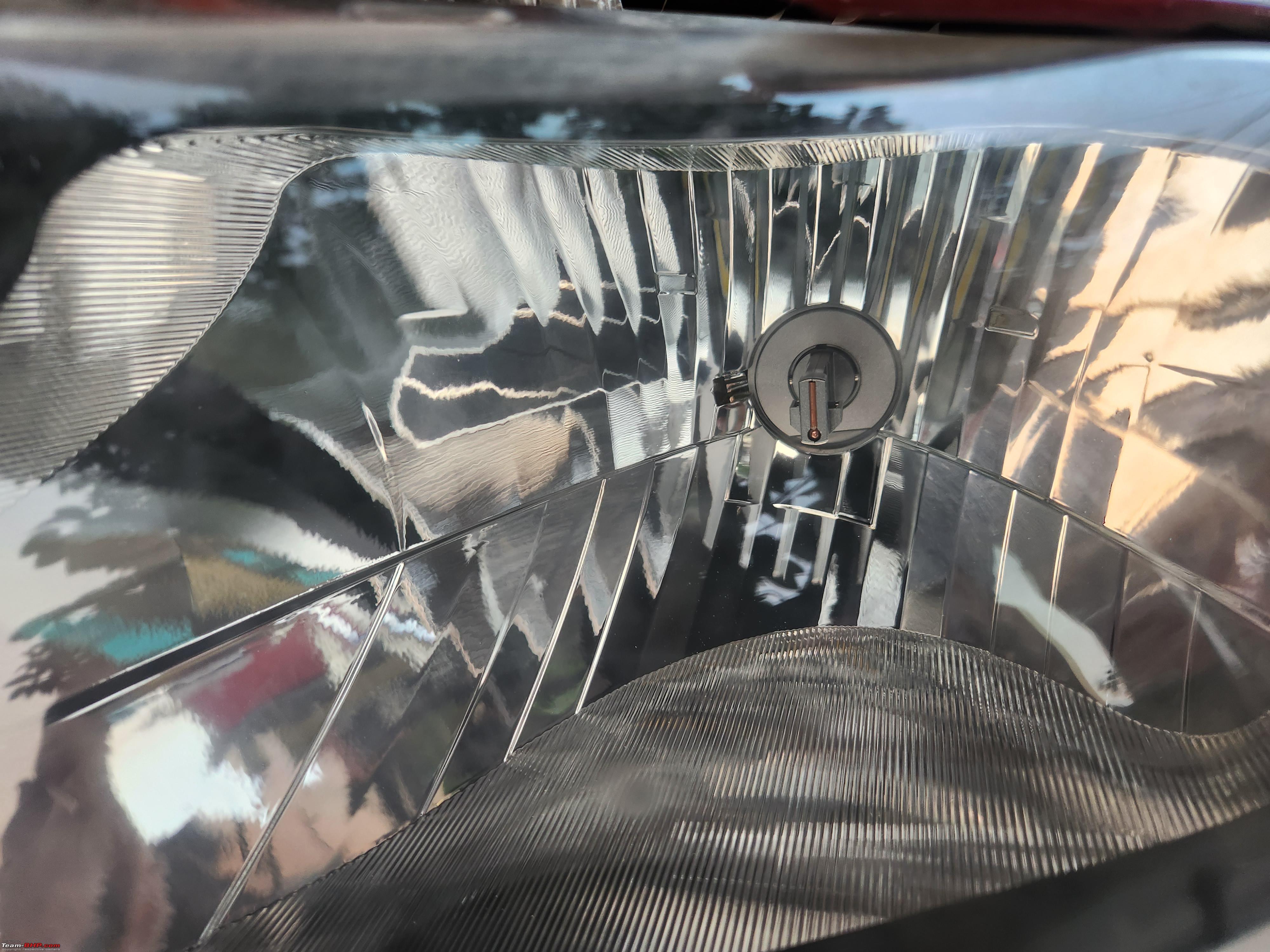

Auto Lighting thread : Post all queries about automobile lighting here-lightballastsecuredbyziptie.png
The ballast (I am pretty sure this is the wrong term in context of of LED bulbs) is attached by zip ties as show in this pic.
Auto Lighting thread : Post all queries about automobile lighting here-20231010_170759.jpg
Auto Lighting thread : Post all queries about automobile lighting here-20231010_170805.jpg
