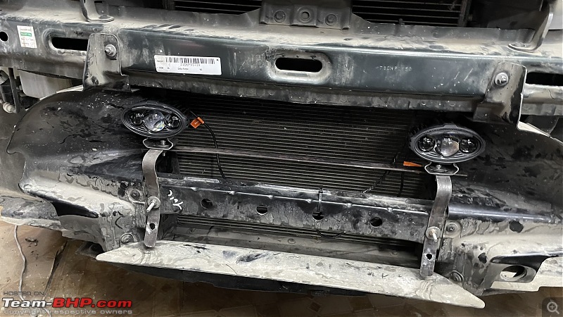

Cross posting here, as its an urgent query:
Hi All,
Yesterday night, I installed auxiliary lights - Aozoom TH02 in my Scorpio-N Z8 AT as I was not very convinced with the stock light setup. Here are some pics from the setup.
Auto Lighting thread : Post all queries about automobile lighting here-b9d40fe84c634452978afc8c5c5763a7.jpeg
Auto Lighting thread : Post all queries about automobile lighting here-img_1087.jpeg
Auto Lighting thread : Post all queries about automobile lighting here-img_1086.jpeg
The installer connected the lights directly without a relay, using a cheap switch and tapping into the fuse box. Although these lamps are beautiful, I couldn't use them for even one night. After driving for an hour or so, I could smell that something was burning. As soon as I tried to turn off the lamps, the switch stopped working, and the click noise and feel were gone. I suspect the switch got burnt. Anyways, I pulled the car to the service lane and disconnected the fuse tap to kill the circuit.
I have a query here: How should I wire it, and do I need a relay? If anyone has installed something similar, can you please guide me on which fuse to tap for signal, which relay to use (links would be great), and any suggestion for a good quality switch.
Thanks!
