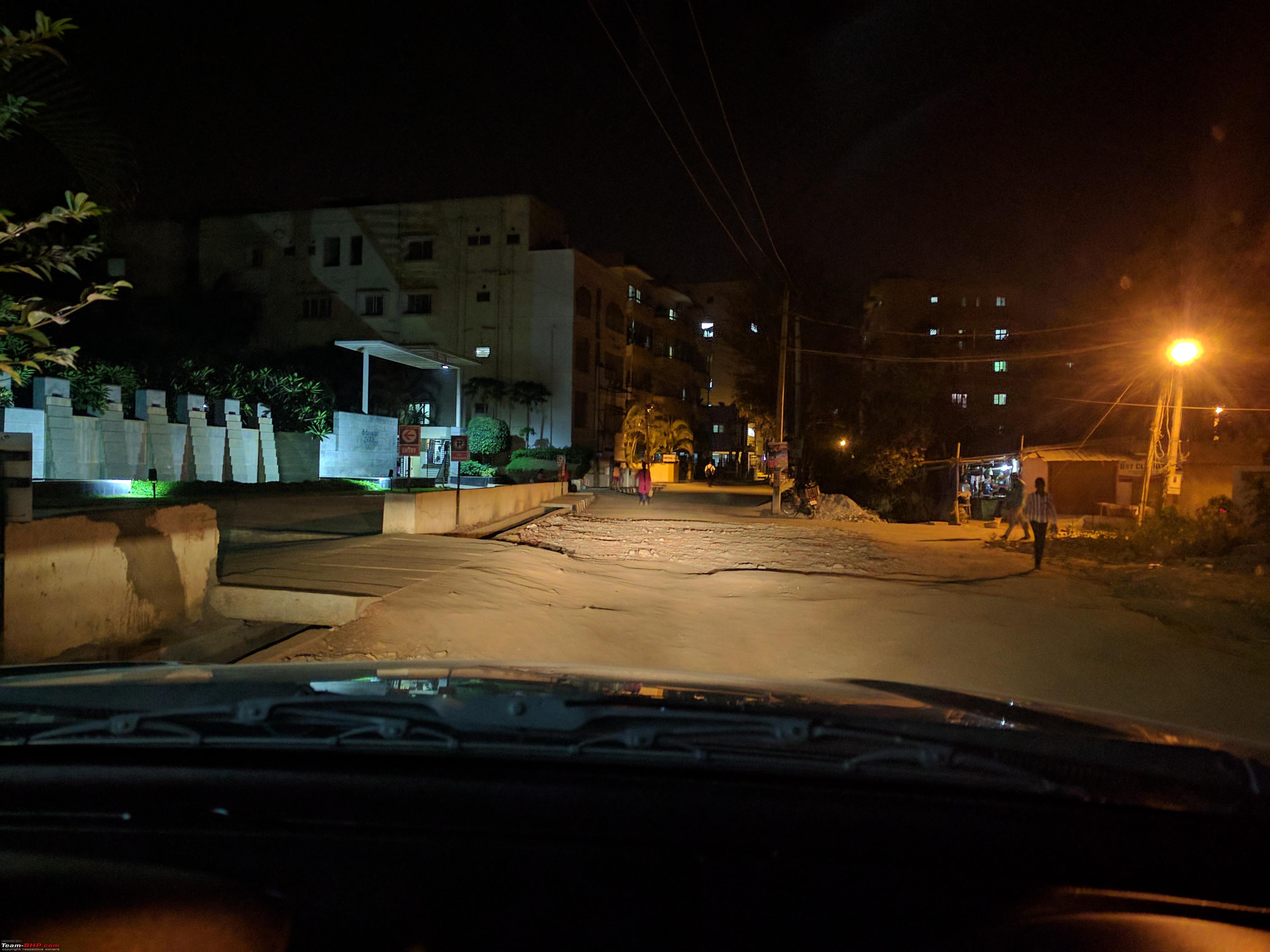

Below picture shows the throw of light on high beam. You can see how far it goes.
Auto Lighting thread : Post all queries about automobile lighting here-17435902_10154751492363600_921529324437053549_o.jpg
Here is another pic with Pajero Sports on low beam which has Osram night breakers. This will give you some idea for the amount of light generated by these LED bulbs by comparing it with prior pic. Check the building towards far end in this pic and compare it with same building in prior pic where the vehicle is on full beams.
Auto Lighting thread : Post all queries about automobile lighting here-img_20170322_200321.jpg

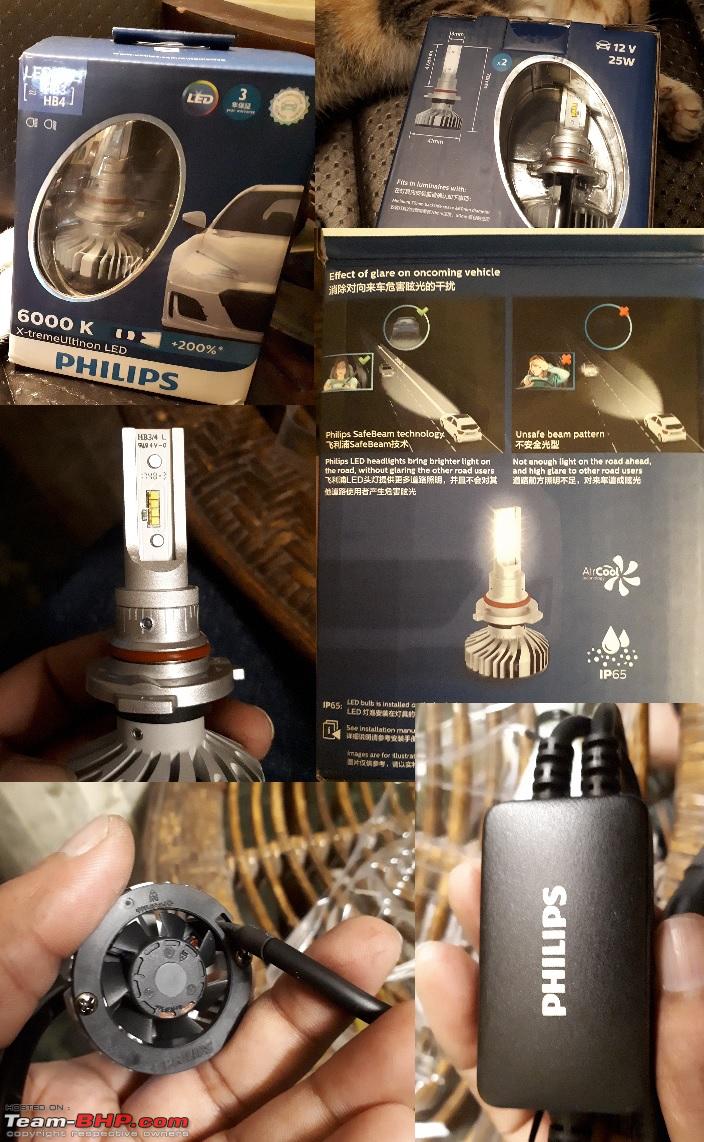

Happened to see the Philips LED HB3 replacements by chance and what joy! I did not think further!
These are also from their Xtreme ultinon series and really top quality construction like the rest of their line-up.
Attachment 1776894

My friend, I hope you cleaned the LED's thoroughly before putting them in since the way it was held, as shown in PIC#1, they will go kaput in no time. If not, please take them out and clean it using an alcohol prep pad that is usually used to clean screen of mobile phones.
