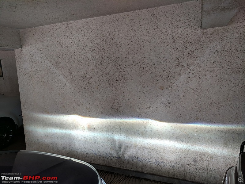

I finally took the plunge and upgraded to HID in my 2018 Ford EcoSport. Although, I wanted to install Morimoto, decided to go with XenonPlanet primarily for budget and availability constraints.
Karan from XenonPlanet was very helpful and helped me out with what i should go with. The total cost was 12,000. No wires were cut and it was a complete plug and play installation.
Now onto the images. Please note that the low beam is at it's highest position.

Low beam, halogen on the left and HID on the right
Auto Lighting thread : Post all queries about automobile lighting here-mvimg_20180314_092440_exported_5773555125366472255.jpg
